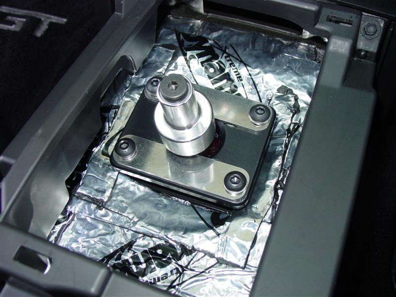

A local shop did the install while I was out of town and I assume they installed the stops which I ordered with the shifter and they did not install the rubber shifter boot. how can I tell if they installed the shift stops? why is it recomended that we not use the stops? and is the rubber boot included in the kit or is that the ford piece. either way where do I get a new one and george I need a new set of instructions as well since the shop tossed them.
Hello,
Yes, the rubber boot is included with the kit. If in fact your installer did not install the rubber boot, then if you lift up your shifter boot, you should see the silver brackets as noted in the attached picture. Those are the shift stops...
George recommends not installing the stops, since the factory trans has built in shift stops. These can lead to a "false sense of security" when it comes to forcing a shift into gear. (like that is an issue with this shifter...... )
Mike
