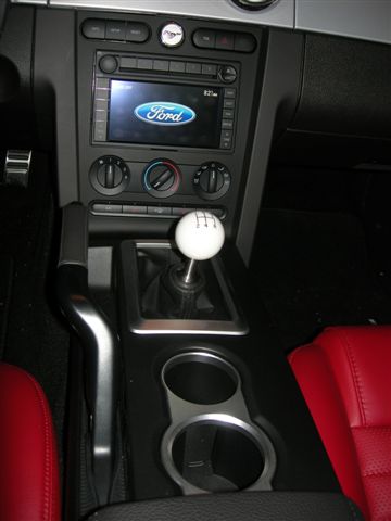

My Install
I finally got my shifter installed last night along with a GT-500 e-brake lever. I started several weeks ago, but didn't have time to finish the installation. I finally got tired of driving my Mustang around without the center console and finished it. I took my Mustang on a short test drive this morning. I like the new shifter. There is noticeably LESS vibration through the shift **** and I did not notice any additional noise. The shifts are very positive and, with the progressive springs, the effort was not a problem. I set my throw at 5 turns since George mentioned 4 and 6 seems popular. The throw still seemed a bit long for me, so I might try 6-8. I installed a white Hurst **** and it looks better than I thought it would. I have the Premier Interior Package (PTP) and the shift **** that comes with that package is a solid aluminum **** that I liked, but the MGW handle and white **** top it easily!! Great shifter George!! Thank you!
Some notes from my install. First, I had not been under my car before. There is more room to work around the shifter than I was expecting. That was a pleasant surprise. The toughest part of the install from a space standpoint is tightening the bolts for the clamp on the front support rod. Not a lot of room to move your wrench. All the other bolts/nuts were easy to get to. Second, I can see how you COULD have more noise if you did not completely seal up the opening with the DynaMat. The DynaMat is a critical step if you want a quiet shifter. I used all of both sheets. Third, I didn't see the need for the stop nut that comes with the Hurst ****. I didn't use it, but I couldn't get my **** completely down. The sealant on the threads of the MGW lever stopped me about one turn too short. My **** is now a permanent part of the lever. It will not budge either way! I even ran the stop nut up and down the threads several times to clear away some of the sealant and it still got stuck. Fourth, I flipped the handle clamp so the nuts are on the passenger side. With the PTP shift boot, I would have ripped the boot on the first shift had I not. Last, TacoBill's How To's are great. I used them for the shifter, spring install, and e-brake lever.
