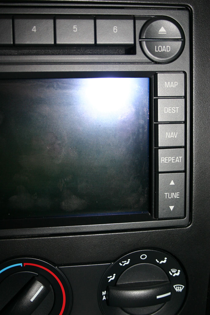

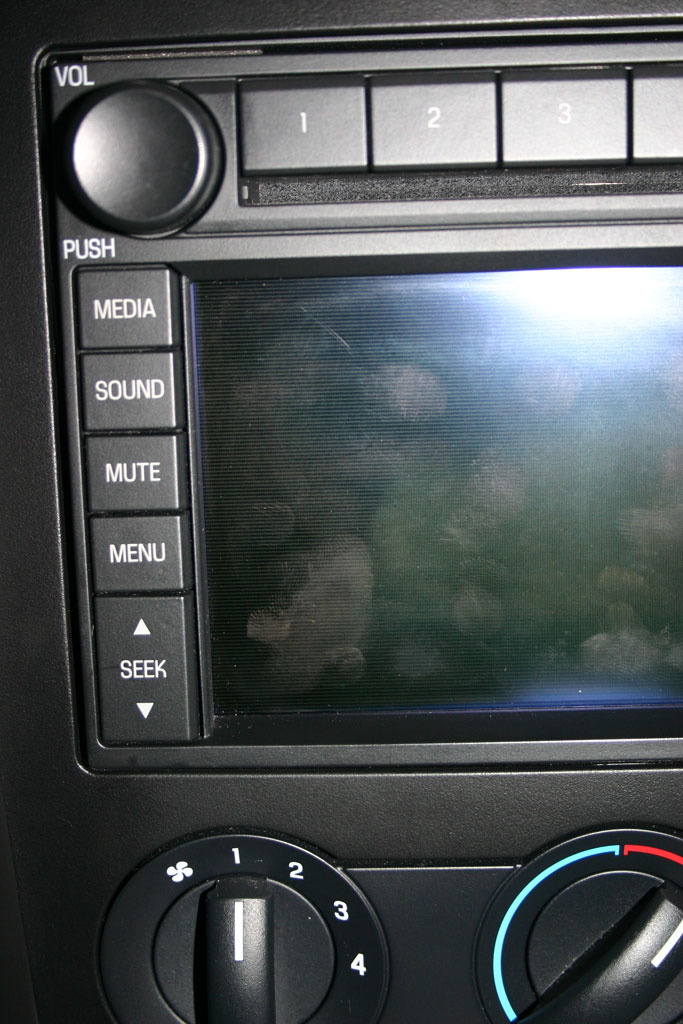

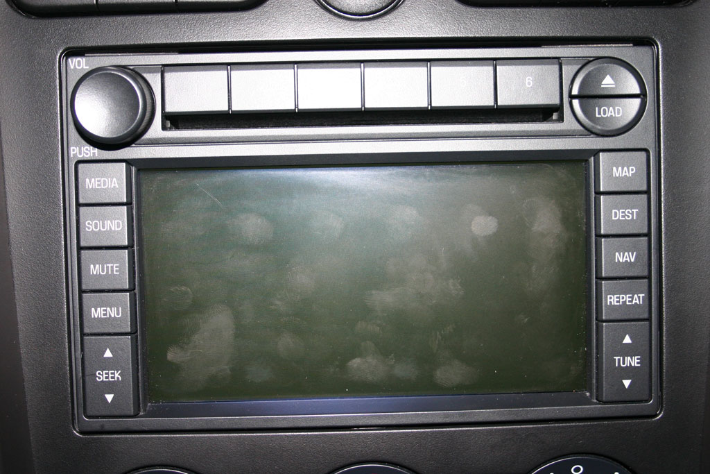

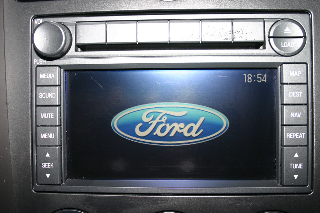

Here are some Pics of the nav unit.
Attached Thumbnails Installing a Factory NAV on a 2005 'Stang-nav1.jpg   Installing a Factory NAV on a 2005 'Stang-shot3.jpg   Installing a Factory NAV on a 2005 'Stang-shot4.jpg   Installing a Factory NAV on a 2005 'Stang-nav2.jpg

bee bop and/or others that installed the nav's, how did you verify your shaker 500 (or 1000) is still functioning entirely? I think I might be installing a nav unit sometime soon...
Looks like all worked out for you, so was that a used unit you got? looks like you can see some minor scratches on the screen, or is that just the pictures?

I believe that is the pictures. I don't notice any scratches when I look at it. The screen was dirty when I took those pictures. I need to clean it good.
