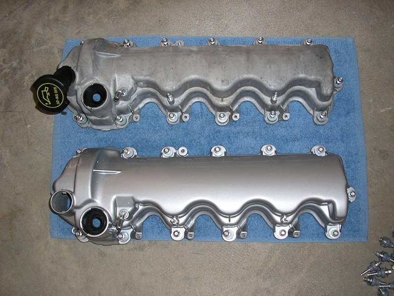

Originally Posted by Hatchman
The studs for the wire looms we just leave on and powder coat over. Only plastic nuts pop over these, so a little powder coat on the threads won't matter, plus I think having them coated looks pretty good.
The breather tubes can be taped up or powder coated over, doesn't matter, the rubber and plastic hoses will fit over them either way. I definitely would NOT take them off, I don't think they will come off without a cutting torch.
I took my studs out and one of the breather tubes (the smaller one). The big one is riveted to the underside so it was masked off. I think they look cheap when everything is left on and powdercoated over. I also smoothed out all of the casting imperfections prior to coating.
Attached Thumbnails Powder Coating Cam Covers-cam_covers.jpg   Powder Coating Cam Covers-cam_cover_compare.jpg   Powder Coating Cam Covers-engine_side.jpg
