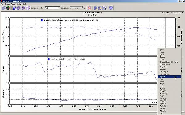

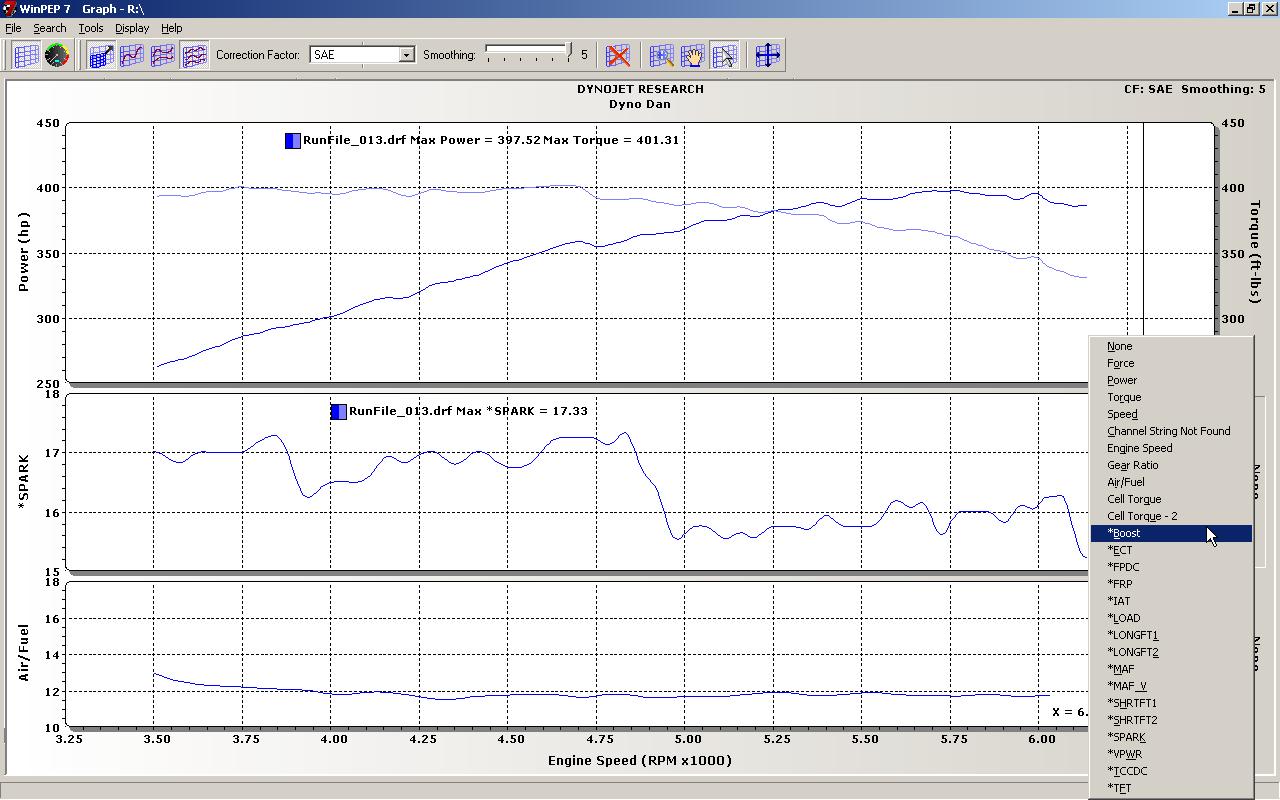

Dynojet tech has replied. Actually, he's more than a 'tech', he's the VP of Dynojet Research Inc.
Bill those runs look a little suspicious, but certainly not the worst we've seen.
We can rule out a "dirty RPM pickup", because as you can see, when you graph these runs that the jagged trend exists when viewed vs. speed. On the Modular Fords, it's difficult to get a "dirty RPM pickup", because as you know, they have a COP (coil on plug) arrangement which mandates our primary inductive lead to be clipped on the low tension side of the coil. Some dyno shops have RPM pickup issues when they clip on the high tension side of the coil, that being the spark plug wires in most cases.
How about your driveline? Are you still running stock wheels and tires? If you're not, then this could very well be the root of the problem. I can't count how many times I've seen "Chinese knock off wheels" on newer Mustangs that are less than perfect in regards to balance, concentricity, etc etc. You also mentioned 4.10 gears, and normally this would not induce the trend you're seeing.
If it's not the driveline, then perhaps look to the PCM calibration. Have you ran you car on the dyno before? Did you perform multiple modifications to the powertrain (driveline and engine) at one time, or did you change the combo, test it, change the combo, test it....etc etc? Doug at Bama Chips does a fine job on the calibrations for the 2005+ Mustangs, but without supporting data, it's difficult for us to assess your dyno runs. If you notice that the jagged trend starts at about peak torque, which is peak cylinder pressure, which is the most likely place for detonation to occur. Our latest release, the Dynojet Datalink Module for OBD2 applications allows any Dynojet dyno owner to monitor and log critical OBD2 data right into the dyno run file. This industry first, industry exclusive device works on ALL 1996+ vehicles, and works especially well on Ford vehicles. We're really hoping that dyno owners "step up" and add this to their dyno, as it's rather critical to monitor / log exactly what's going on with the vehicle you're testing. In your case, it would be interesting to see if the spark advance "to a step down" at these points where the jagged trend is apparent, and if it didn't, and the vehicle was actually detonating, then perhaps the PCM tune has limited or removed the knock retard feature. Like I mentioned, Doug's calibrations are usually spot on, but as you know, our options for pump gas are spotty at best here in the desert southwest. Drop a 1/2 can of Torco in the tank and make some more dyno runs, if the jagged trend goes away, it's in the tune, if it doesn't, it's in the driveline.
I've attached a run (jpeg) from an 06 automatic Mustang GT. Notice the "extra data" that was captured during the run? Also notice the "step" right in the middle of the power curve, and then look at the delivered spark advance.......see anything interesting, I know it's not dramatic, but when a PCM pulls 3-4 degrees, you're going to "see it" on a Dynojet dyno.
I will reply back with some answers he's requesting. Interesting to note how well known Doug is in the performance tuning community.

Then there seems to be something up... but what?

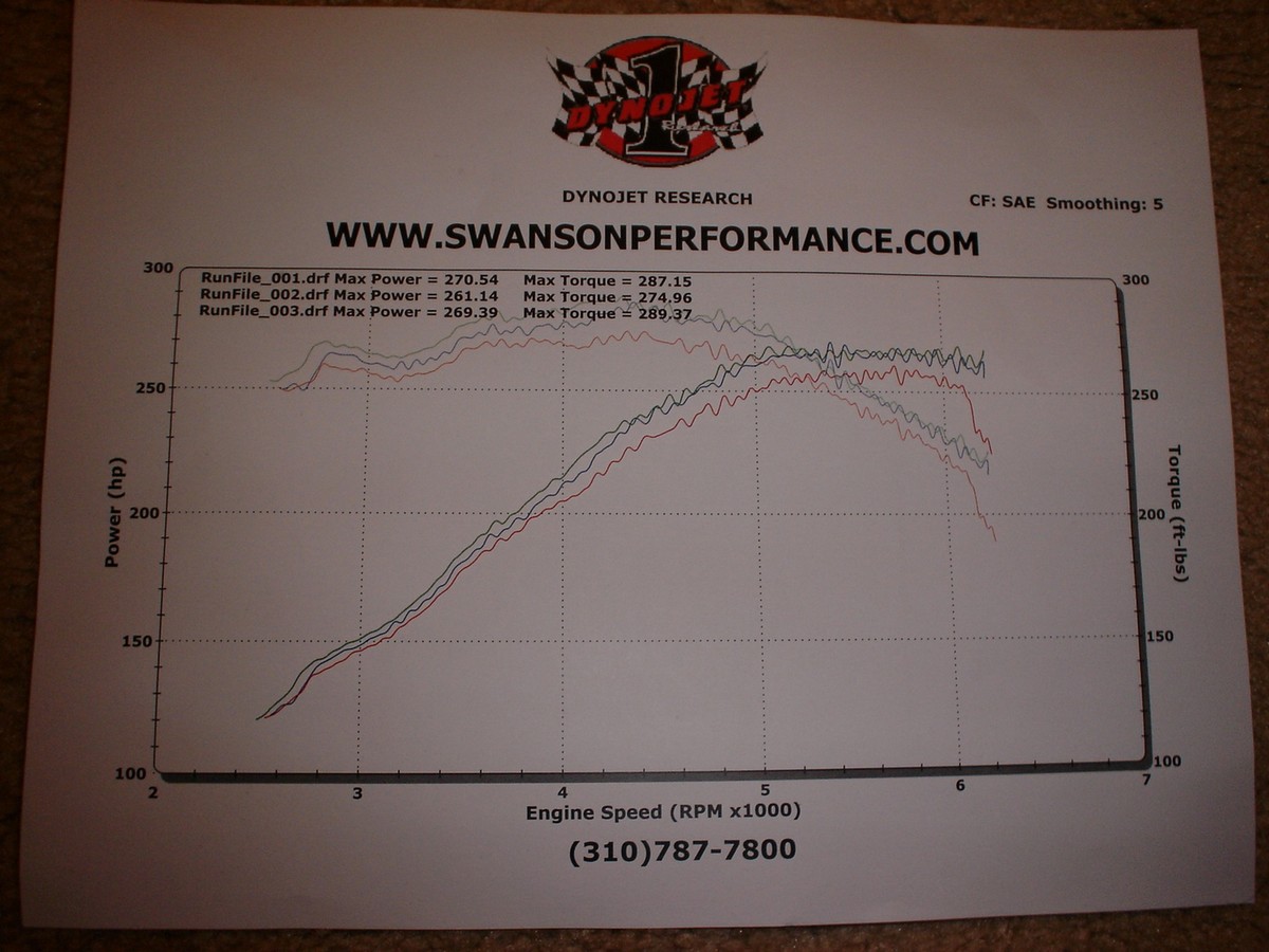

I replied back to Dynojet also referencing this printout taken from another customer that went to the same place.

I would forward that to Doug, too, to see what he says.
Brian, or Leo, should take their car to the same place.
If their graphs are jagged, it's a dyno issue.
If their graphs are smooth, it's a car issue - and most likely it's ignition (or tune) and not driveline.
I think I will.
I don't think they're willing to cut loose a Benjamin just to see how the lines are in their graphs.
I'm betting it will have the same appearance of not being smooth.
It won't be smooth if ran at this facility. The above attached pic of the dyno graph is from a 100% stock 07 GT.

But, from what Bill just said about the stock GT, it really is starting to point toward the Dyno. And I still can't believe that that graph is on Smoothing 5!
Ultimately, I can't see how a vehicle can have that kind of HP and TQ output. You would think you would feel SOMETHING in the car with that kind of jumping around... whether it be ignition, tuning, driveline, whatever. You have the HP, then you don't... then it's there, then it isn't. You think you'd feel some sort of bucking. That's why it has to be the way the dyno is interpreting the data from the car.
Bill's SAE 5 got pretty smooth - can you imagine this other guy's tune at SAE 0??
Only for producing jagged graphs. The HP and TQ numbers seem to be inline with baseline and similar modded GT's.
So if you don't mind the Lie Detector look (as if I took the test ), they seem to put out accurate numbers.
I'm starting to think the same thing.

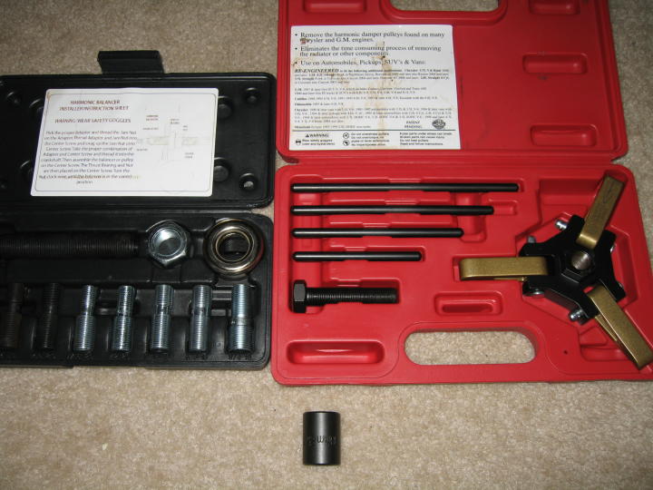

Changing gears...
My friend has graciously let me borrow both his gear puller set and harmonic balancer installation tool, along with a 18mm impact socket. Attachment 26681
I downloaded my revised 91R tune that Doug sent me into the Xcal2 lastnight. At first, even though the file has a .ll3 extension, it would not download into the handheld. I knew at that point that my current version of Live Load needed to be updated to the latest version, 1.3.1. Once updated, I had no problems updating my Xcal2.
I only requested 2 tunes this time around, the 91R and 87P. I felt no need to request the 91T or any of the other options.
Being that these newly revised tunes compensate for the CMDP's, I loaded the Xcal2 with them only. The 91R, I loaded twice since I had 2 memory banks, one being for back-up (for whatever reason).
All that's left now is for Saturday to roll around.
The harmonic balancer (crank pulley) installation tool is the bolt.
I know they say not to pull it on with the bolt, but if somebody can give me a good reason I'd love to hear it. You could use your factory bolt to pull it on... then back it out to install the new bolt.
I've always used the stock bolt to pull it on with no problems (and still use the stock bolt).
