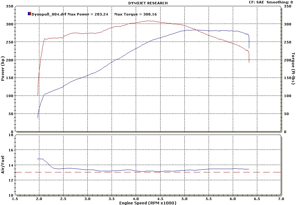

Very nice Bill.
What interested me the most was the smoothing.
This may be the difference between a custom tune and an expert far away.
Look at my smoothing 0.
Attachment 26455
See how mine doesn't bounce much at all.
What do you think?
My tuner said the next thing to try was X pipes.

There is nothing strange about your graphs. They usually have variations like that.
The odd graphs are mine. They show only 0.2HP difference between 0 and 5 smoothing. My tuner took time to adjust things so the computer wouldn't "fight itself" too much. He had some trouble with a drop in the spark advance near the peak as the computer tried to change the parameters to what it wanted. He would have liked to advanced it more, but this tune allowed for very smooth building of power. It really seems to be a 91 tune not really a 93. He said it might run on 89, but I tried it and it knocks.
