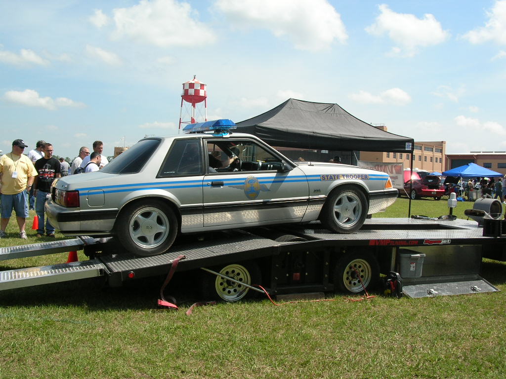

Tom called me up from the carshow he's at. He got the 89 Trooper dyno'd and said he'll post up the graph.
I'll have Tom elaborate on the results.
Here's a little teaser pic:
Attachment 24058

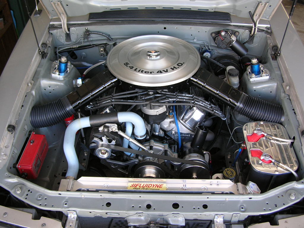

Mods are too numerous to list!! But it's naturally aspirated. I did build it from scratch - from a bare block. Every part, nut, and bolt was bought one by one until it was completed.

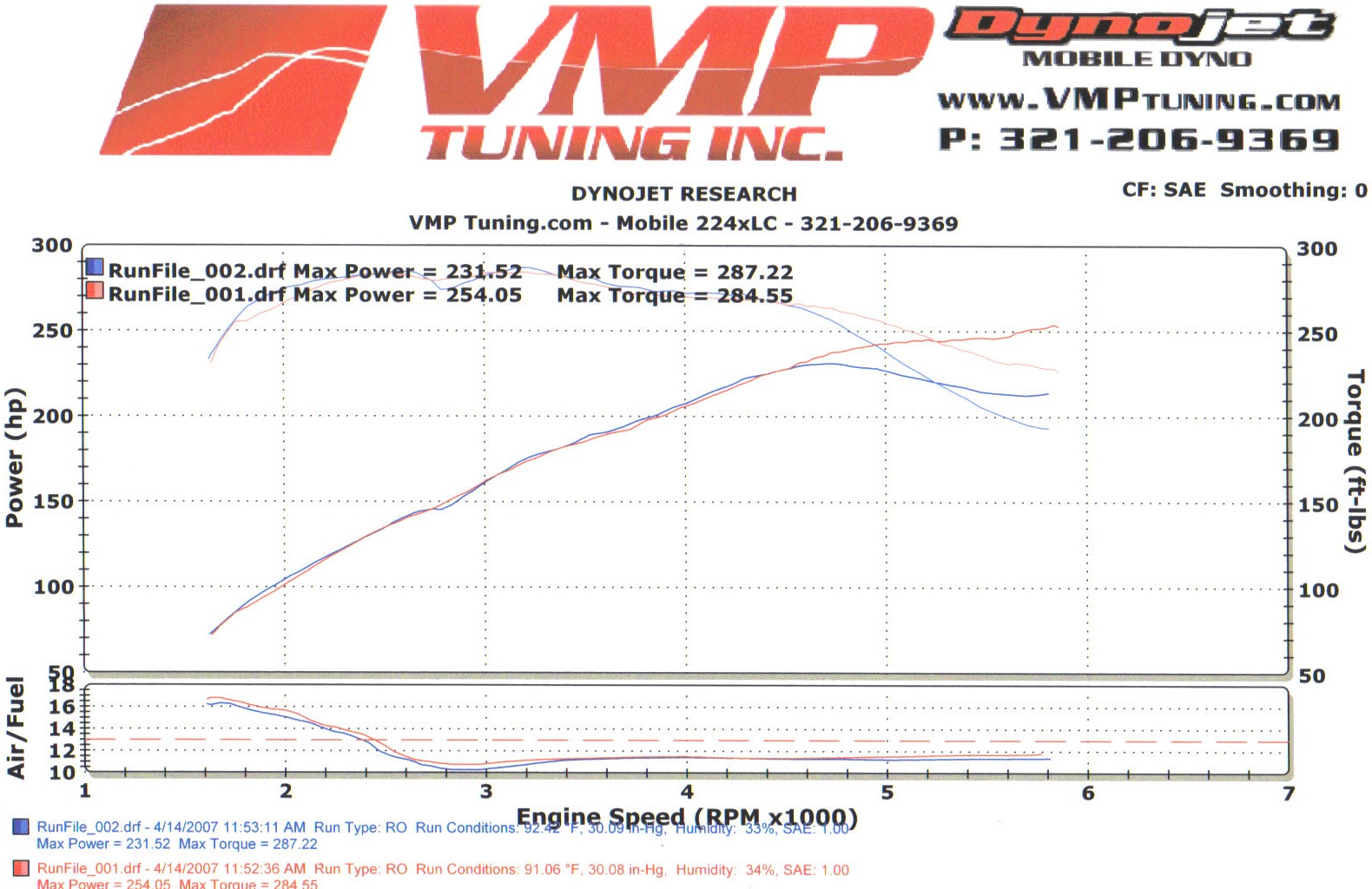

Here's the dyno chart:
Attachment 24062
Max RWHP = 254. Max Torque = 287.
Max BHP (at the flywheel) = 305.
A lot to read, but interesting...
He hit the rev-limiter on the 2nd run - which means he took it to 6250 RPM. That's why I think the red line doesn't taper off toward the end like the blue line does (in torque and HP). I think he got off of it a tad early on the first run.
None of us that have driven it could believe it at first, but after studying the chart, several things became apparent:
The car is a torque monster. It's a 331 stroker engine and it looks to be doing what it is designed to do. HP increases through the RPM band, but look at torque and how high it is through most of the RPM band! Toward the end it tapers off, but you don't need any torque at 5000+ RPMs, anyway.
The car feels much faster than the HP shows because of it being so light, and because of the huge amount of torque.
The "problem" dawned on me when we were driving home:

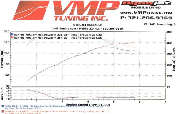

We knew it was really rich (from smelling it after both runs). A quick look at the chart when we were still at the show told us that the Air/Fuel Ratio line dropped and became lean. This didn't make sense since we smelled the unburned fuel.
Later, we realized we were incorrect. The line dropping actually shows it's becoming much more rich. Look at the A/F ratio line and how it drops to 10:1 and then tapers off at 11:1. That is less air to the same amount of fuel = too rich. It's being choked of air.
The "1985 style" air cleaner (with a regular paper air filter) is designed for a less powerful engine. I put it on for show (to get that old-style look) and it's fine for normal driving. But I was an idiot for not taking off the lid and filter for the dyno runs. The hood was open, so it would have had as much air as it needed right into the carburetor instead of having to suck it through those snorkels.
Attachment 24063
The A/F ratio dropping shows it wasn't getting enough air. And the rich smell of the unburned fuel backs that up. In the beginning of the RPM band it was fine, but quickly became starved for air at 2500 RPM.
Rich = safer for the engine, but more air = more HP.
I don't think it will double or anything like that. But I bet 50 more RWHP isn't out of the question.

Check this out:
Attachment 24070
BTW, that torque curve is AWESOME. That's the way it should be: consistent power at any RPM. Your graph just goes to show that you don't need to run a car to redline to gain max acceleration.
I do love the torque curve, but the HP curve not so much. Hopefully I have realized the solution.
In your case, it seems that shifting at 4500 would be optimal.
Yep - or a little higher in the better run.
