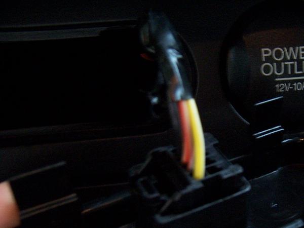

Is My Car MyColor Ready!? : - )
I pulled the tab off of the spot where the buttons for the gauges should be. And there is a wire harness attached to the blank dummy buttons. Does this mean I am all set for the MyColor gauges!? I hope so. I really want them. Thanks for all replies.
