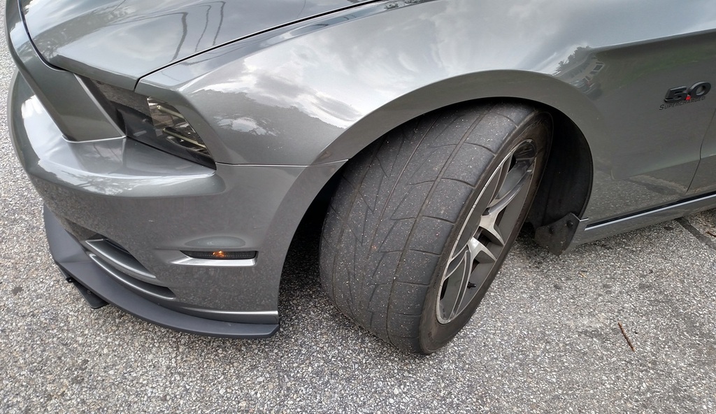

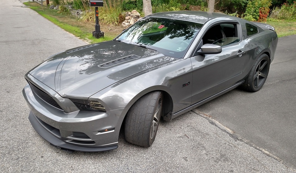

Put my old drag radials on the front of the car test-fitting them, I was surprised when they fit perfectly with no spacers needed.
And the freakin' front-end grip !!!!
Why did I do this?
Autocross this Saturday, and the grip from the 275/35/20 555 G2's wasn't what I needed at last event, so I was looking for more.
I think I just found it!
305/40/18 NT555Rs on the front on OEM SVT 18x9.5 wheels
305/35/20 NT555Rs on the rear on Niche Milan 20x10 wheels

Let us know how it goes.

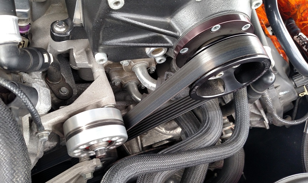

I'm already running a non-JDM tune and I'm OK with it, but I want to go to the tuner that I wanted to go with a while ago. Things happened and I didn't, went with somebody closer, and while this guy is OK, I still don't have the same faith in him as I do in the guy I want to go with next.
We'll see.
As far as the blower belt, half of it is wearing off onto the pulleys, so it's gotta go.
Boost, I think it's the 10-11 psi pulley.
Looking forward to seeing just how much I'm gonna get out of it though.
Currently on the 9-10 psi pulley and I'm seeing max of 7-8.
Here's how my belt looks like right now:

Any idea what is causing the uneven wear on the belt? Alignment issue with the tensioner/idler, uneven tension or something?

I had just replaced an idler pulley because half of it had the paint worn off (the same half that the belt is wearing onto), and when it was installed I could grab it and it had a little bit of play side to side.
A friend with the same set-up on his '14, no play in his pulley. Nice and tight.
So I replaced mine with the silver Thump Racing pulley that's seen in the pic above.
Was hoping the belt would be OK, but apparently that's not the case.
Once I take things apart, hopefully tomorrow, I'll have a better idea if other pulleys or falling apart.

I hope the tune is good, let me know.
As for the belt, that is weird with that center wear from that idler.

I had a feeling that was it, but just you confirmed it.
Did the pulley have play on it when you installed it Gabe? Maybe the heavy flogging had something to do with it?

The old pulley had a bit of play side to side.
New silver Thump Racing pulley has no play in it, it seems fine.
Belt's screwed up, and I think the old pulley killed it.

Awesome. (I thought that was the new pulley on there, my mistake. lol)

Wow...hard to imagine running anything but a 10-rib belt, that 6-rib looks so **** skinny...
