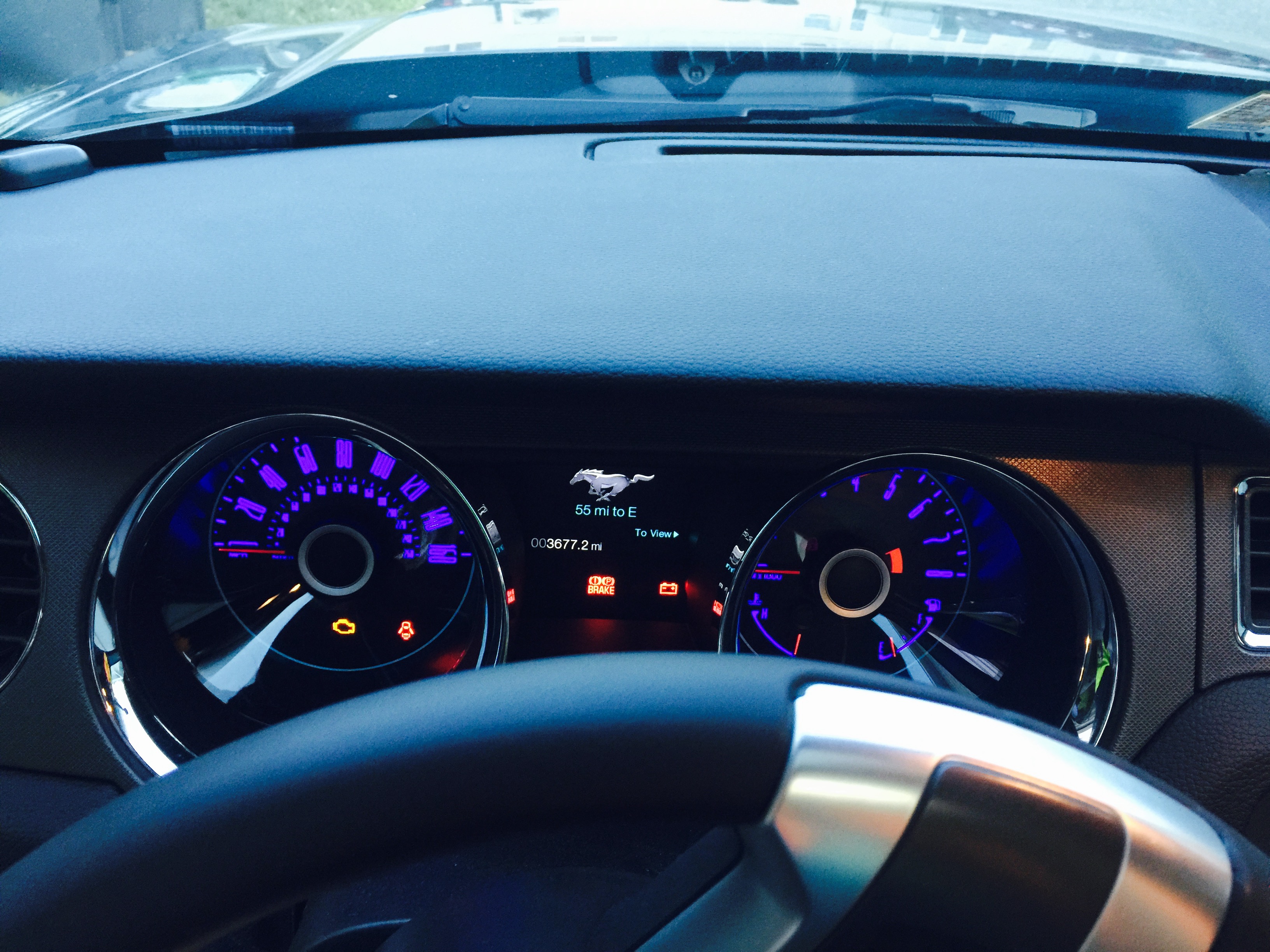

Installed my Cluster yesterday. I sent it off to get my cluster to get the odometer set to the correct mileage and then brought it to Ford and got the Keys re-learned. Easy as pie. Im happy with it and i can't believe i have been missing out on this. SIMPLE things lol.
Attached Thumbnails Retrofitting the 4.2 LCD Track Apps cluster-new-cluster.jpg   Retrofitting the 4.2 LCD Track Apps cluster-old-new-cluster.jpg
