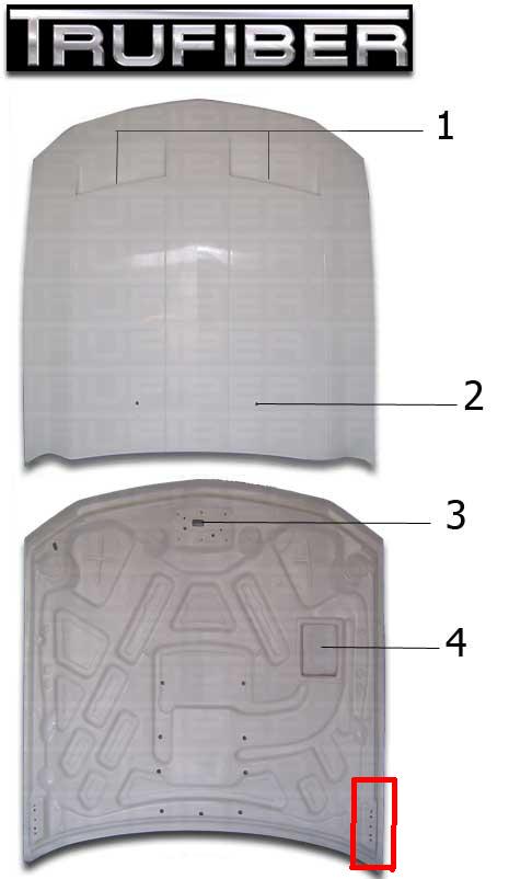

Originally Posted by YaoNYC
im pretty sure a good bodyshop can install this on the trufiber hood....
i like it!!
If using that above bracket then I am sure we can use that set up on the new hoods because Alliance hoods (see picture) have metal latches at the hinches (red box)

My worry is that with out the prop rod supporting the front of the hood we may get cracks around the the hinge.

I think the fiberglass hood is lighter therefore, I dont think it will put much strain to the hinges. Additionally, if the hood stands a up high, then it put even less strain on the hinges.
However, if the struts are too strong, then it will put strain on the hinges when you close the hood.....

Actually the fiberglass is heavier than the factory aluminum hood. The problem is that the strain will occur ahead of the metal insert in the fiberglass as one pulls the hood down against the resistance of the pistons. Repeated strain may cause cracking of the gel coat, fiberglass, or both.

Hmmm......Fiberglass weights approx 40lbs.....
how much does the oem hood weight?
I wonder if anyone out there with this set up and their experience with it...

What would need to be installed on hood in order to make them safe for struts?
