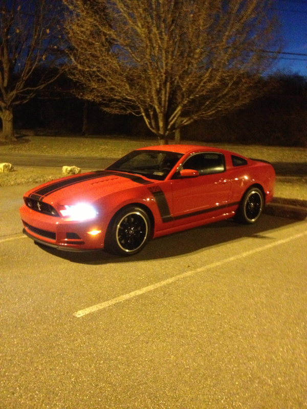

Took Miss Scarlet to work today she makes it a lot more fun!!!
Attachment 126018
Gotta love the mild winter so far, been able to get mine out for 3 days this week

Your car looks sweet as ever, Gary.-----Bill

Thanks for the kind words Bill!!!

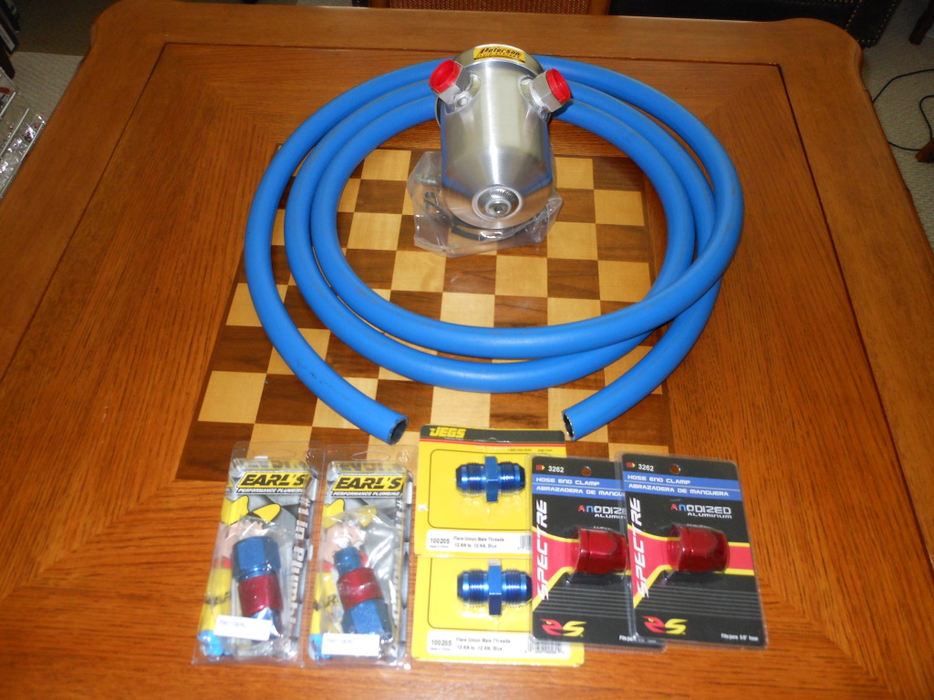

Boss 302R / S Oil Separator
The parts........

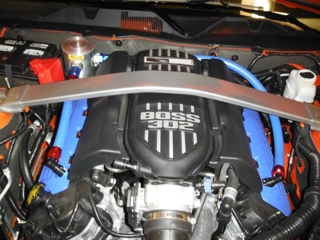

After install...........

Here's the parts;
1 each - Peterson Fluid Systems 08-0400 Breather Can with -12 AN Ports - $90.00 on Amazon ($130 -140 everywhere else)
10 feet - Gates LOL Plus 12LOLB 3/4 inch
2 each - Earls's 700113ERL - 3/4 ID Super Stock Hose Ends
2 each - JEGS 100205 - Flare Union Male Threads -12 AN to -12 AN Blue
2 each - Spectre 3262 Hose End Clamp (5/8 Hose)
2 each - Socket Hd Cap Screws 1/4 inch with washers
1 box - 02253 - Bypass Cap Assortmnet (Auto Zone)
Tools
Drill, nutsert gun, wrenchs, screwdrivers
Position the Breather can on the fire wall, mark the holes.
Drill the holes.
Insert a couple of 1/4 inch nutserts
Mount the breather can put the hoses on from can to crankcase vents, cut hose to fit.
Remove the crackcase vents, remove the vent guts.
Finish installing the hoses.
Cap off intake manifold ports.
Go to fridge get beer, open and enjoy.

That's the best, is that a kit you put together yourself or did you get that from FRPP?
