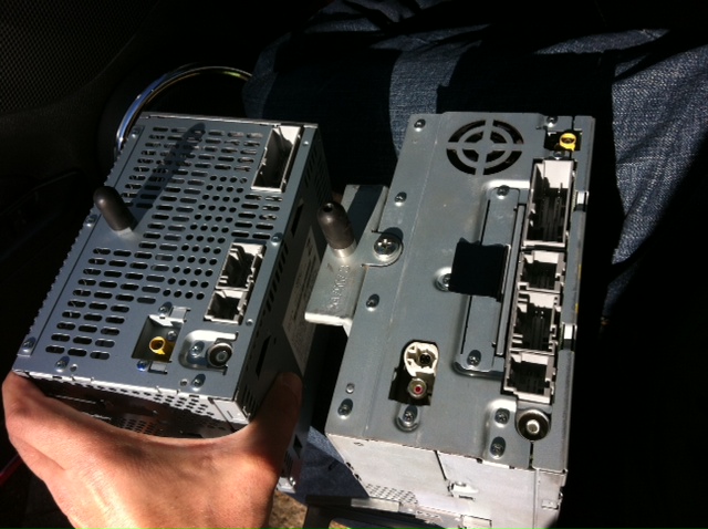

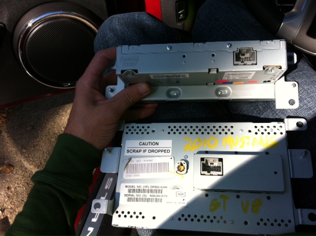

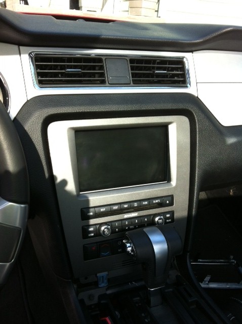

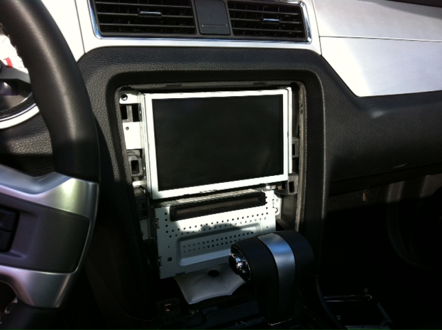

Update:
I installed what I have, but I am still needing a dash harness, amps and the heater control module.
The panel had pwer and lit up. The radio worked, but the volume was really low, but bass was normal. I figure it is because I need the amps. I could not hear sync come on, but it was hard to hear.
The screen did not power up. Might be due to the plug in. The current plug has 4 wires, while the nav requires 6.
The screen takes an extra plug, and the ACM takes another 3 plugs not provided for in the current dash harness.
Also, the climate control would not work properly. Need the nav heater control module (locared behind the display screen).
No matter what, the proper dash harness is needed and amps. The dash will have to come out for this. Nothing new for me, but it will be something I tackle later on. Maybe not even until the spring.
