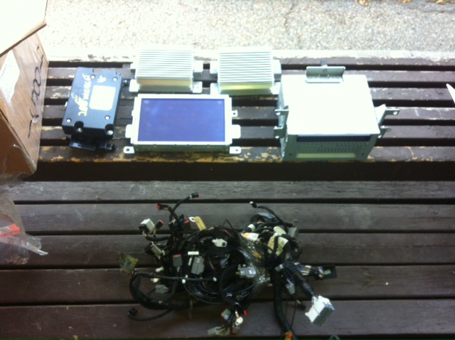

Parts needed are the touch screen, receiver, center stack bezel and swithgear, main dash wiring harness, and the heater control module.

Got the main parts in the mail today. I still need the bezel with the switchgear and heater control module before I can put this in the car, though.
cost for all this??

I spent $600 on what you see.
