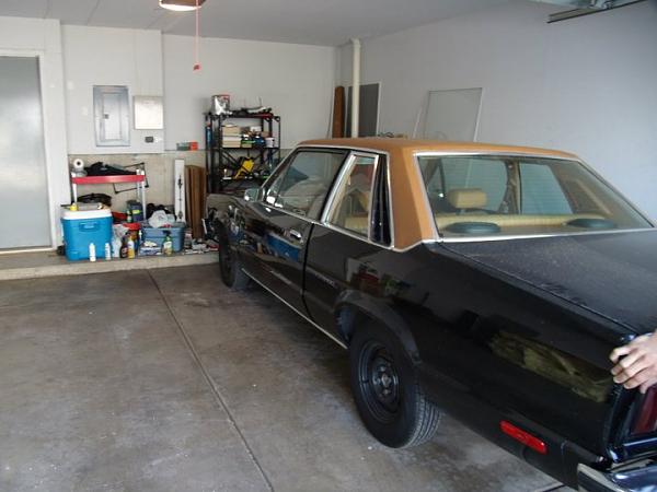

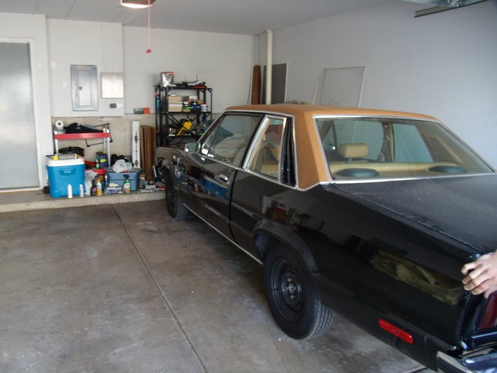

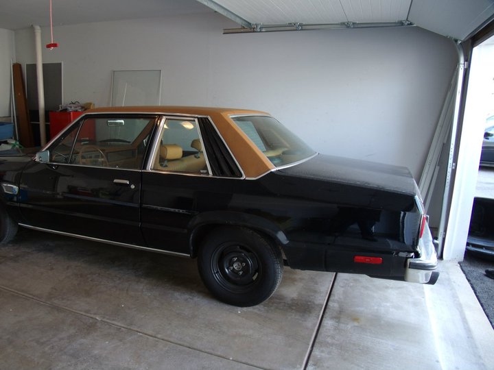

It's the square body sedan. I plan to v8 swap it and put Mustang suspension stuff under it. Interior is getting a Mustang gauge cluster and dashpad, new carpet, re-cover headliner, etc. It will take a while to do it all, but I'll go little by little re-building it. I just bought the gauge cluster and gauge trim on ebay, will re-wire as needed to make the tach and everything work.
