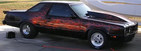

I have a Fairmont wagon idea in my head that someday I hope will translate to one on the street. I have attached a couple photos of what I have in mind, albeit with a different color/wheel combo, but you get the point. (I'd want the '98 or '99 Cobra wheels/brake combo with MM suspension additions.)
As far as drivetrain options I am thinking about a nice 347/AOD combo with shift kit (although a 408 351w stroker would be darn cool as well), as I'd like the wagon for daily driving purposes. Something with around 290-320hp to the rear wheels.

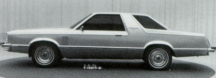

I am not quite sure why , but ford had different fenders for the fairmont and the zephyr, My Zephyr has fake grilles between the wheel and door, all the fairmonts I had did not have this. I also like the fairmont tail lights better then the zephyr so I got a set and put on this car but I do need to find a better set. I am looking if anyone got a set of tailights for sale for fairmont futura.
