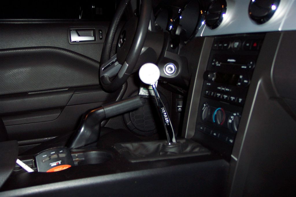

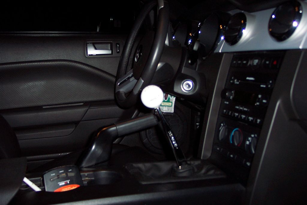

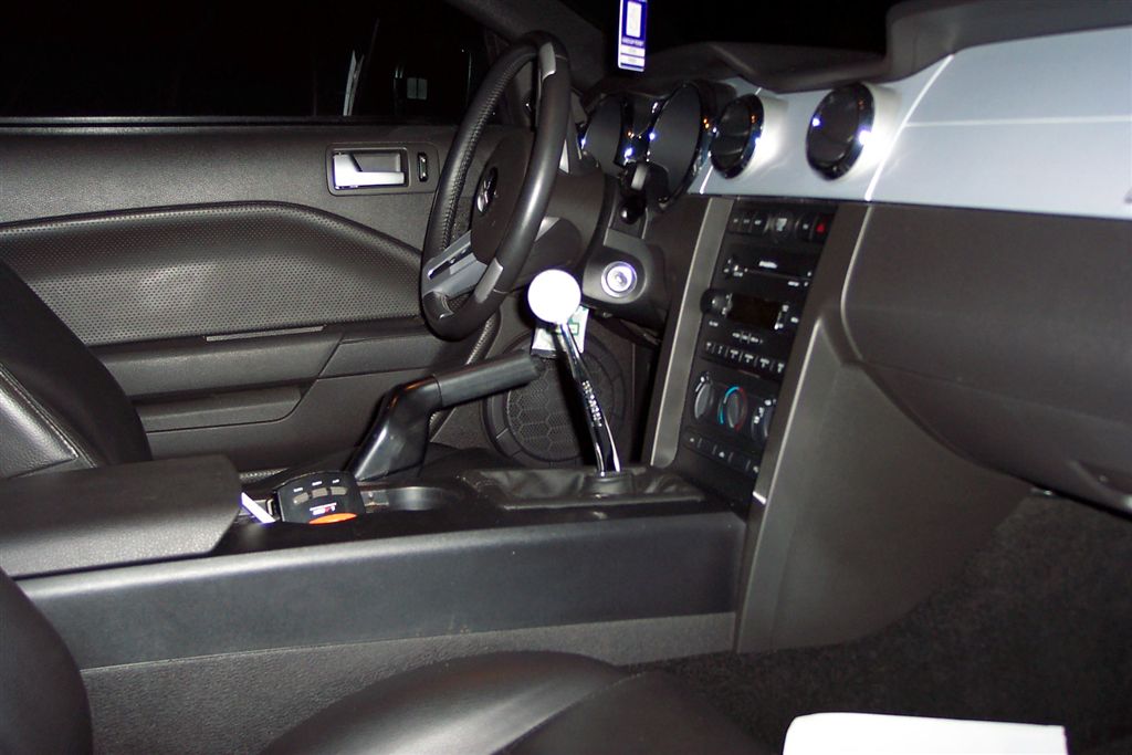

Here are some pics of the Hurst with the longer handle I was refering to in post # 141 on pg 8 of this thread
Attached Thumbnails My first impression of the Hurst shifter.-100_2875.jpg   My first impression of the Hurst shifter.-100_2876.jpg   My first impression of the Hurst shifter.-100_2877.jpg   My first impression of the Hurst shifter.-100_2878.jpg

Can you still get it with the shorter handle?
Old Jan 9, 2007 | 07:54 PM
  #165
slowjoe24's Avatar
Joined: October 20, 2004
Posts: 2,494
I like it but, Does the long handle bump any of the dashboard controls or radio ***** etc????

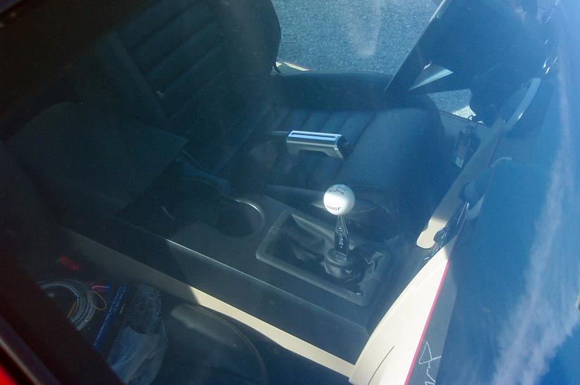

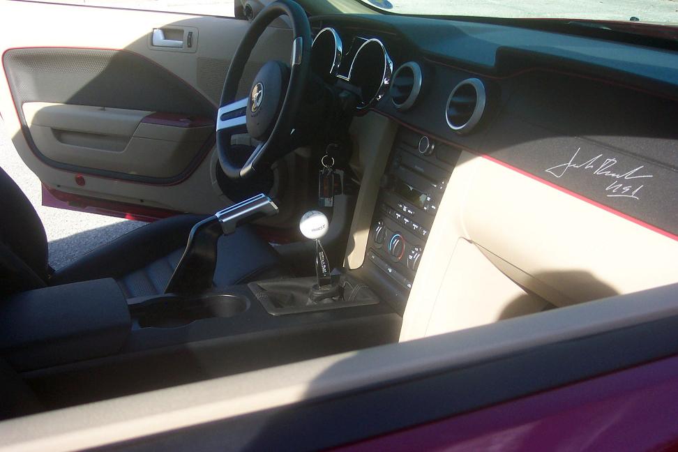

Just got the Hurst with the white ball for Xmas and installed it a couple days later.
I like it a lot. The looks are awesome. Absolutely no rattles or vibration issues. It's also much more precise and less sloppy than the stock shifter.
However, I have to say that it's almost too much effort to shift now. Downshifting from 3rd to 2nd is especially hard sometimes. Yes, it feels more like a race car now, but for every day driving I'm not convinced that's a good thing. Maybe it'll get easier over time?
Overall, I like the shifting feel better now, and definitely like the looks a lot better, but I am considering the longer handle that davids2toys is using. Anyone know the part number or how to get it?
Old Jan 10, 2007 | 01:53 PM
  #167
FLAstangx3's Avatar
Joined: September 16, 2005
Posts: 1,705
From: Yatta-Abba, AL
Yes, the Short Handle comes with it.
Hurst has NOT released their Billett shifter. You don't need it. The Comp/Pro is awesome
Attached Thumbnails My first impression of the Hurst shifter.-000_0011-2-.jpg   My first impression of the Hurst shifter.-000_0012-2-.jpg

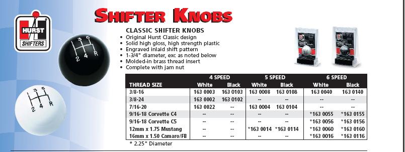

yes, Hurst makes the ***** with the 5-speed shift pattern and NO Hurst, in black or white. Jegs sells them for $27.99. Not sure if it's a 3/8" thread or 7/16". Here's the page:

First of all, you absolutely hit nothing at all, in fact, the coffe cup holder is much more usable now...lol. my handle is 2" higher and comes back toward the driver 1 more inch. I think it looks much more retro than the short handle, and it makes shifting much easier because of the greater leverage!!! My throw is now 3"...it is 1 inch more than the shorty handle, and 1" less than stock! Another thing i am hoping for, is somebody trying to retrofit an old style rubber boot w chrome trim and red H, the taller shifter will be perfect for that mod, where the short shifter would looked stupid!!!!
I dont have a part # for it though, sorry, if you call them or go online its the only one like it, nothing else is even close, I believe it said it was 9+ inches tall.
I love the HURST lettering on the ball, it looks BA IMO!
As far as the vib thing goes...I did not have a vibration the first 6 months I owned it, seems to come with the cooler weather

Here's what I found on the Hurst website.
The first pic shows the classic white ball w/o the Hurst logo on it.
The second pic is the handle David is using. (# 538 0015) I'm guessing though.
I also included one someone might like because it not only angles back, but also towards the driver. (# 538 8571)
