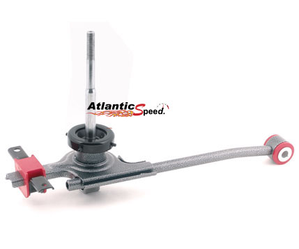

I was just wondering if they attached the same way. It sounds like they do since you're talking about the distance between the two holes. I was under the impression the stock style didn't attach to the shifter the same way the chrome handle does.
The first picture is supposed to be of the stock style shifter. Notice the handle goes straight down into the shifter. It's that picture that made me question if they could be swapped.

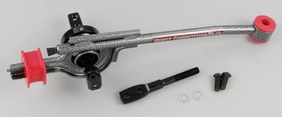

I'm assuming your shifter looks like the one in the second picture. If that's right, the two handles are definitely interchangable. Now if Hurst could just come up with a part number for the handle itself, I might order one to try it out.

Yes, the Hurst Shifter that uses the stock ball is like the one in the second pic, and the handle is interchangeable with other Hurst handles. So if anyone wants to got back to the stock ball, or get the chrome stick with T-handle, or whatever, a swap out is only two bolts away. The thread pattern on the sticks are different, so only the stock ball fits the shorter black stick.
I, personally, thought the chrome handle was too long, and I kind of like the stock ball since it matches the IUP very well. Plus, with the shorter black handle, the throw is even shorter than with the long chrome handle. I love my Hurst!
