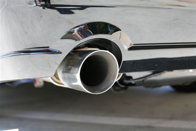

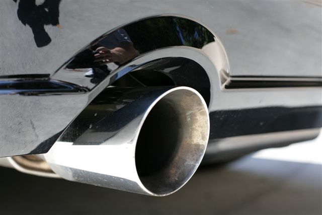

Thanks again to Mustang Buster for keeping this thread alive. After renting a GT-H for a couple of days, I became excited on recreating that exhaust sound for my vert. I took Craig's advice, and got a great deal and extremely fast service from Scott at Matthew's Ford.
I've had the X-Pipe and GTA mufflers for almost a week now, but it will be at least a week before I can get around to installing them.
If there's enough interest, I'll install the GTA's first, and try to get a comparison fot those interested between stock mufflers, GTA's, and GTA's w/X-Pipe.
Craig, am I creating more work by doing the GTA install before the X-Pipe?
Attached Thumbnails FRPP Shelby GT/GT-H Exhaust Installed with Pics!!!-img_3183.jpg   FRPP Shelby GT/GT-H Exhaust Installed with Pics!!!-img_3184.jpg   FRPP Shelby GT/GT-H Exhaust Installed with Pics!!!-img_3185.jpg
