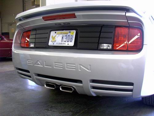

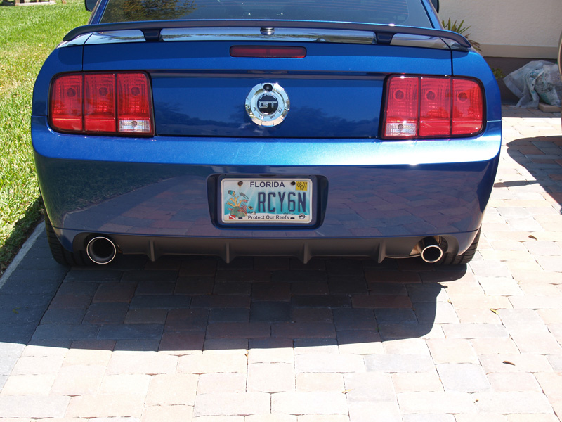

Here are some pictures. First one is with one on and the GT/CS. Second with both on.
Attachment 24044Attachment 24043
Attached Thumbnails FRPP Shelby GT/GT-H Exhaust Installed with Pics!!!-p4131876.jpg   FRPP Shelby GT/GT-H Exhaust Installed with Pics!!!-p4131875.jpg
Old Apr 14, 2007 | 03:09 PM
  #196
steevr's Avatar
Joined: November 6, 2005
Posts: 478
Great first pic.....really gives you an appreciation of the difference in the outlet size between OEM & GTA. Thanks.
