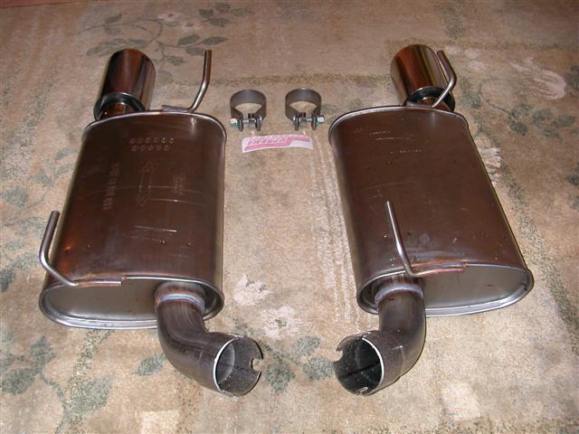

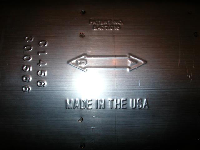

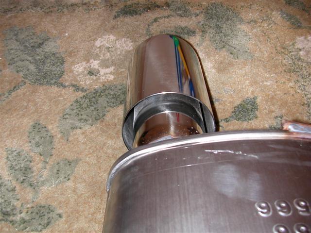

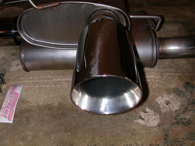

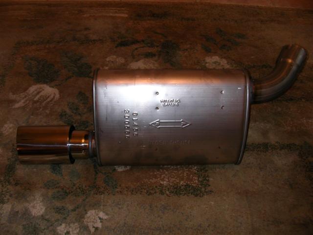

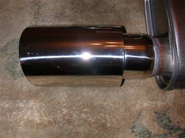

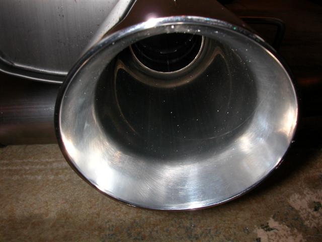

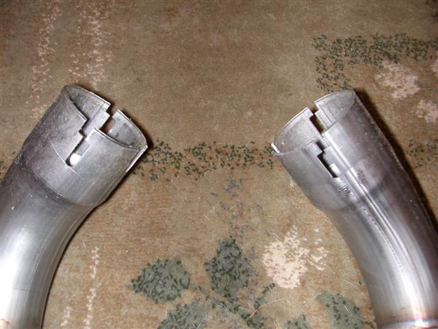

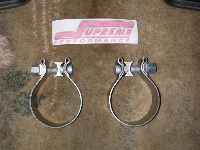

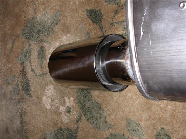

This evening the FRPP GTA mufflers that had been on back order arrived to go along with the FRPP X-Pipe that I had already installed. This is the same exhaust setup that is used on the Shelby GT and the GT-H. I installed them right away, and I am very pleased with the results. Not only do I now have the same exhaust setup as the Shelby's, but they sound great!
First let me say that the mystery is solved, as they are NOT made by Borla as some speculated. They are made in the USA by a company called Supreme Performance, and their decals were even in the FRPP box. http://www.supremeperformance.com/
The Ford part numbers of both the mufflers and X-Pipe are:
FRPP Mufflers (used on the Shelby GT and GT-H) M-5230-GTA
FRPP X-Pipe (also used on the Shelby GT and GT-H) M-5251-R

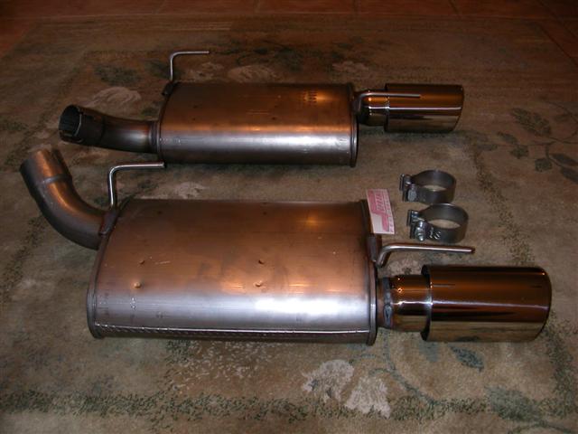

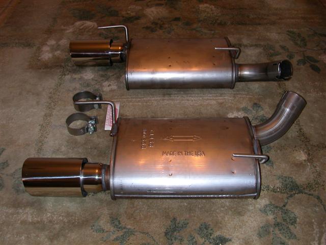

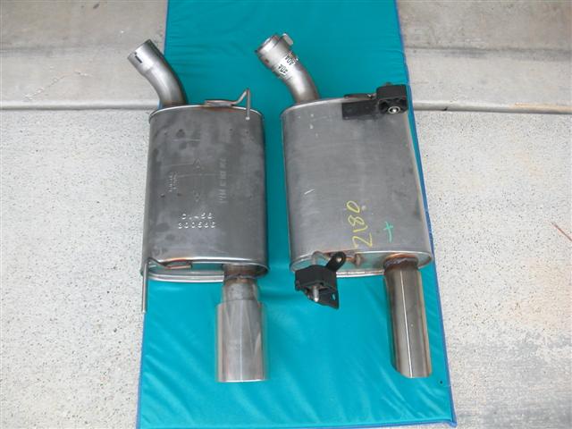

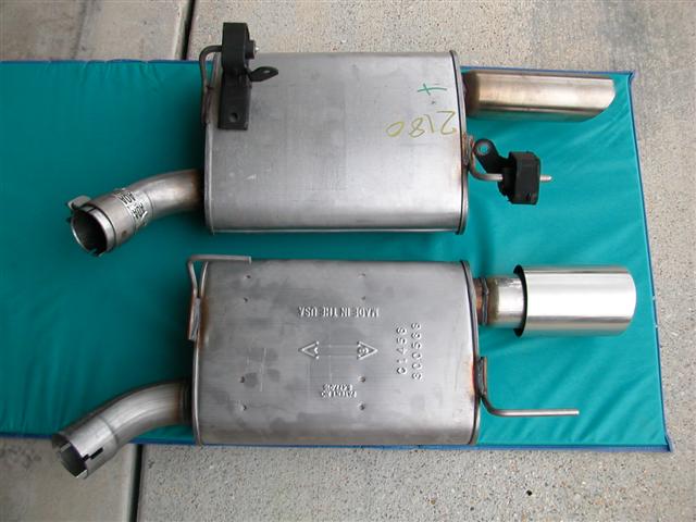

I weighed the stock exhaust and the GTA exhaust on my digital scale before the install. I weighed everything twice to make sure the numbers were accurate. The stock exhaust weighed 15.6 pounds per side, but the GTA exhaust only weighed 12 pounds per side, for a weight savings of 3.6 per side, or 7.2 total. The sound is great, and there is no, as in zero, resonance or drone. At idle is has a much deeper and low rumble over the stock mufflers, and they are quite a bit louder under WOT, but not to the point of being offensive. To me they sound almost identical to the Corsa's but for less than half the cost. The tips look great, as they are 4" double-walled polished stainless steel, and have a slight slant cut to them. They fill out the opening in the rear bumper facia nicely. Again the tips look very similar to the Corsa tips, except the Corsa's have a much greater slant cut to them, and they of course say "Corsa" on them.

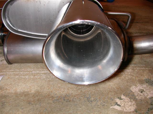

I took several pics of the mufflers before the install, and some next to the stock mufflers for comparison. Unfortunately however, it got dark by the time I got them installed, and my digital camera wouldn't take any good shots at night. I will take some photos in the morning with the mufflers installed.
So for those considering this exhaust, I would highly recommend it.

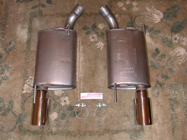

More pics.

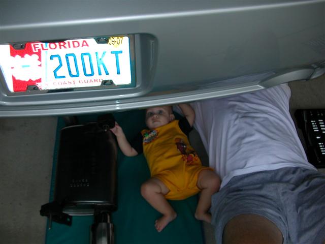

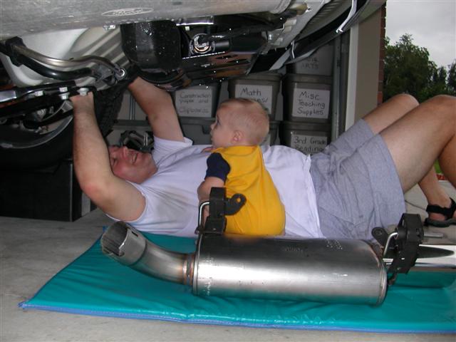

Professional Exhaust Installation Helper--my 11 month old son Duke.

Great write up and pics. Puts a lot of questions to rest. I had to do it again, I would get those. I really like the 4" tips and the way they fill up the cutout, and the double wall looks very high quality.

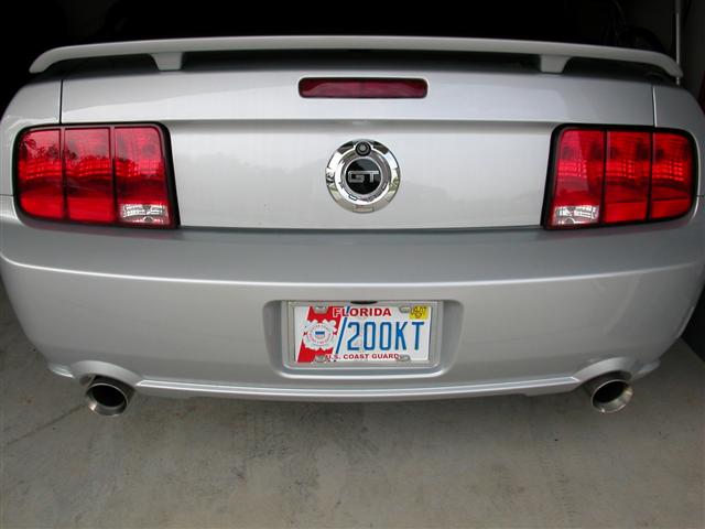

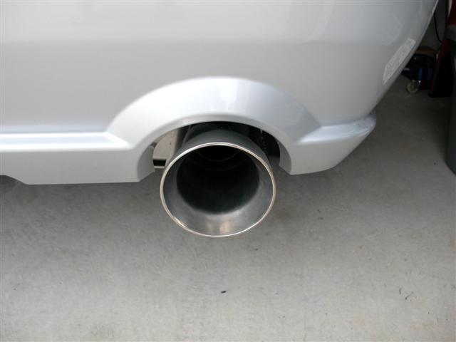

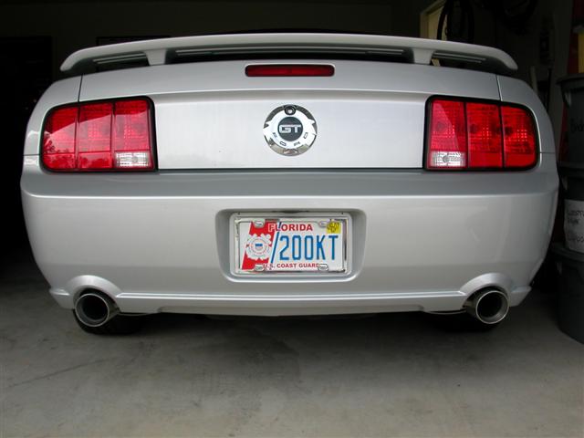

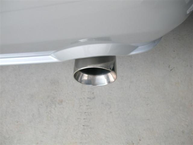

Thanks guys, and as promised, here are some installed photos now that it is daylight. The install was pretty straight forward, and the parts are very high quality, just like OEM, which is what you would expect from FRPP. Really the only hang-ups so to speak, where that they were not packed that well, and UPS had destroyed the box, and one of the hangers was bent slightly (it was very easy to bent back though). I also had to loosen the clamp back by the X-Pipe to get the tips centered in the bumper cutout. This was easy though, as it used the same 17mm deep well socket as the muffler clamps, so I just loosened, adjusted and retightned. The only tools required where a 17mm deep well socket, and a 13mm socket, and a 13mm wrench. As other have said however, a 13mm ratchet wrench would have made things much easier. I had a set, but the movers "lost" them during my last PCS move--you military guys know how that happens. Oh, sorry Jeff, but I don't have a video camera, but I have seen several links on here that have actual sound clips of the GT-H. I am happy to report that mine now sounds exactly like that, which it should, since it has all the same exhaust parts.

Here's the GT-H I rented, should sound just like his. My clamps on my 07 GT were 15mm, weird that yours were 17!
