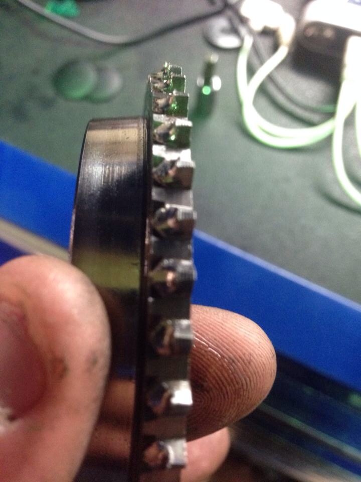

Actually he's not the first case I'm a technician at ford and have quite the pain in my neck currently rebuilding one of these transmissions. Came in initially car stuck in first gear transmission completely chewed up rear tires bald as can be. After got it all put together have a gear roll over noise and can not pin point the cause of the noise at all.. Pretty much everything has been replaced due to the fact mt-82 units are not available. Idc what anyone says getrag transmissions are complete junk multiple times a day the new focuses are coming in complaining that their transmission is shuddering. (Caused by leaking input shaft seals). It's a wonder why ford is still using getrag as a transmission provider. Can't wait to see how many more of these are snapping input shafts and detroying synchros with the new line lock feature... Oh and for anyone asking about the warranty of course ford is going to warranty the things built to abuse... Which i find quite bull**** honestly.
Attached Thumbnails I had one of the good ones - MT82 Transmission Whining has begun...-image.jpg

It shouldnt do those shift patterns due to a skip shift solenoid
