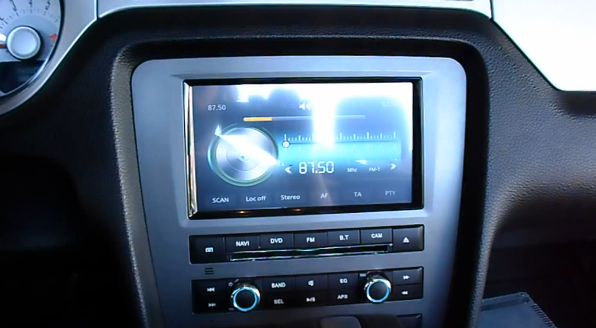

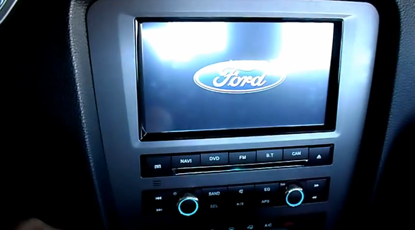

Old Jun 14, 2013 | 05:00 PM
  #178
mymustangrunfaster's Avatar
Joined: April 22, 2013
Posts: 29
here are some pics of the radio installed [with havoc lights] when radio was installed in my 'tang!!!!
[/IMG]
  #179
Posts: 29
  #180
Posts: 29
