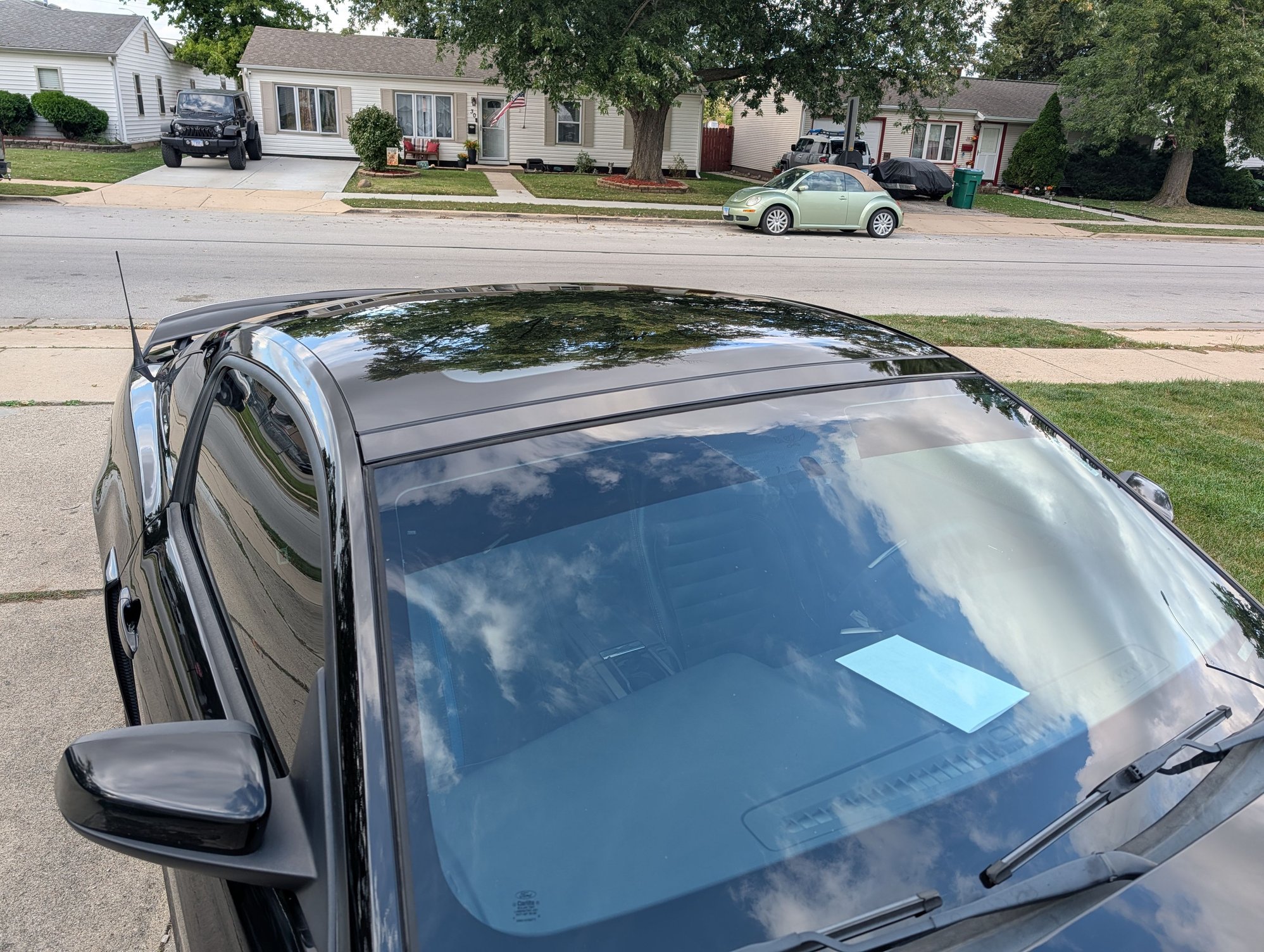

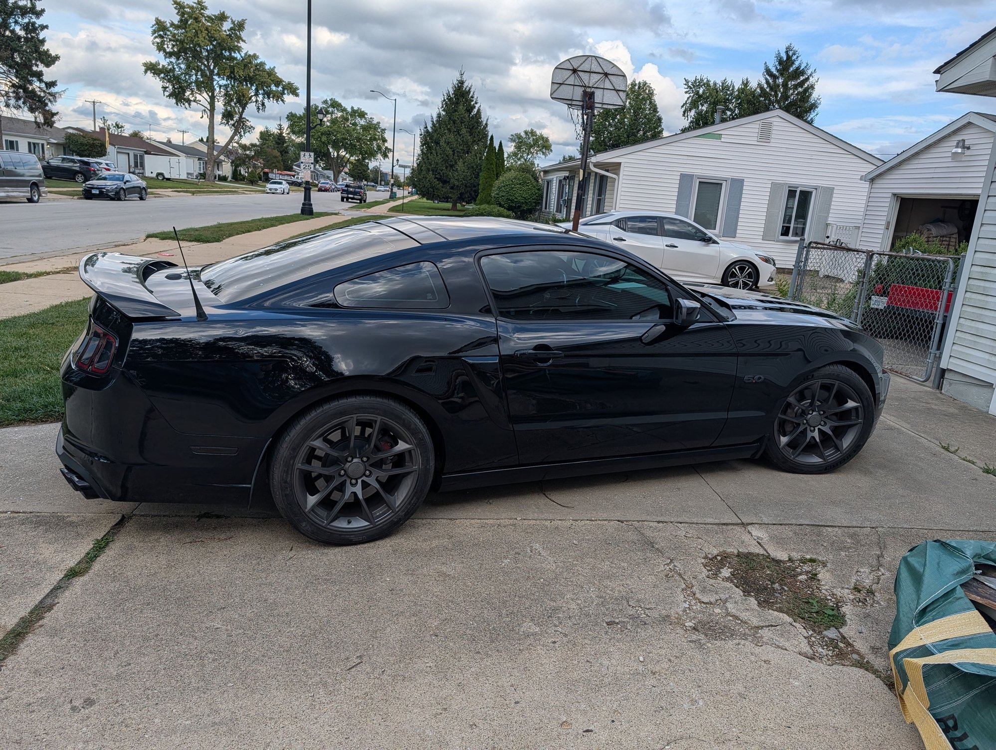

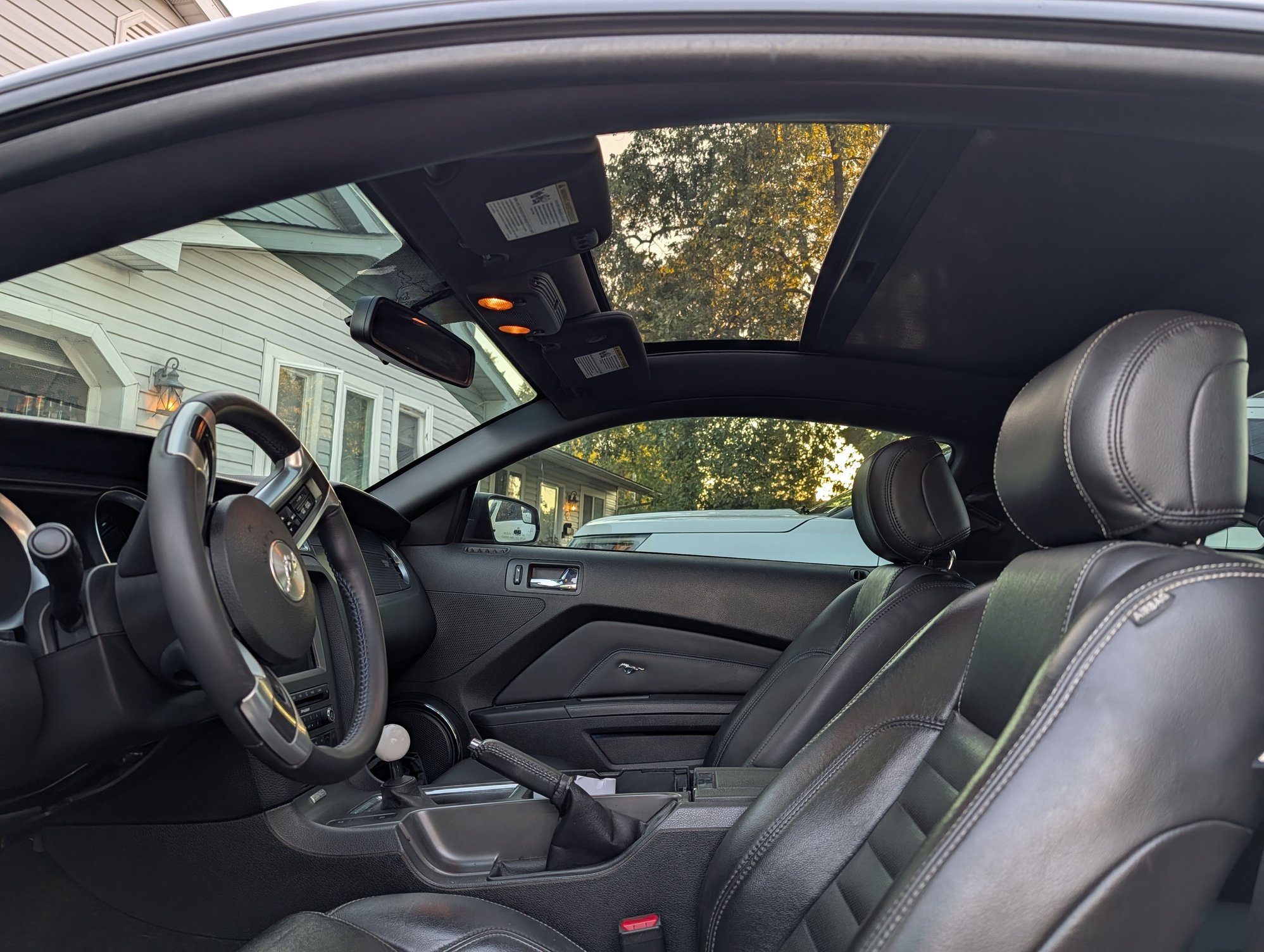

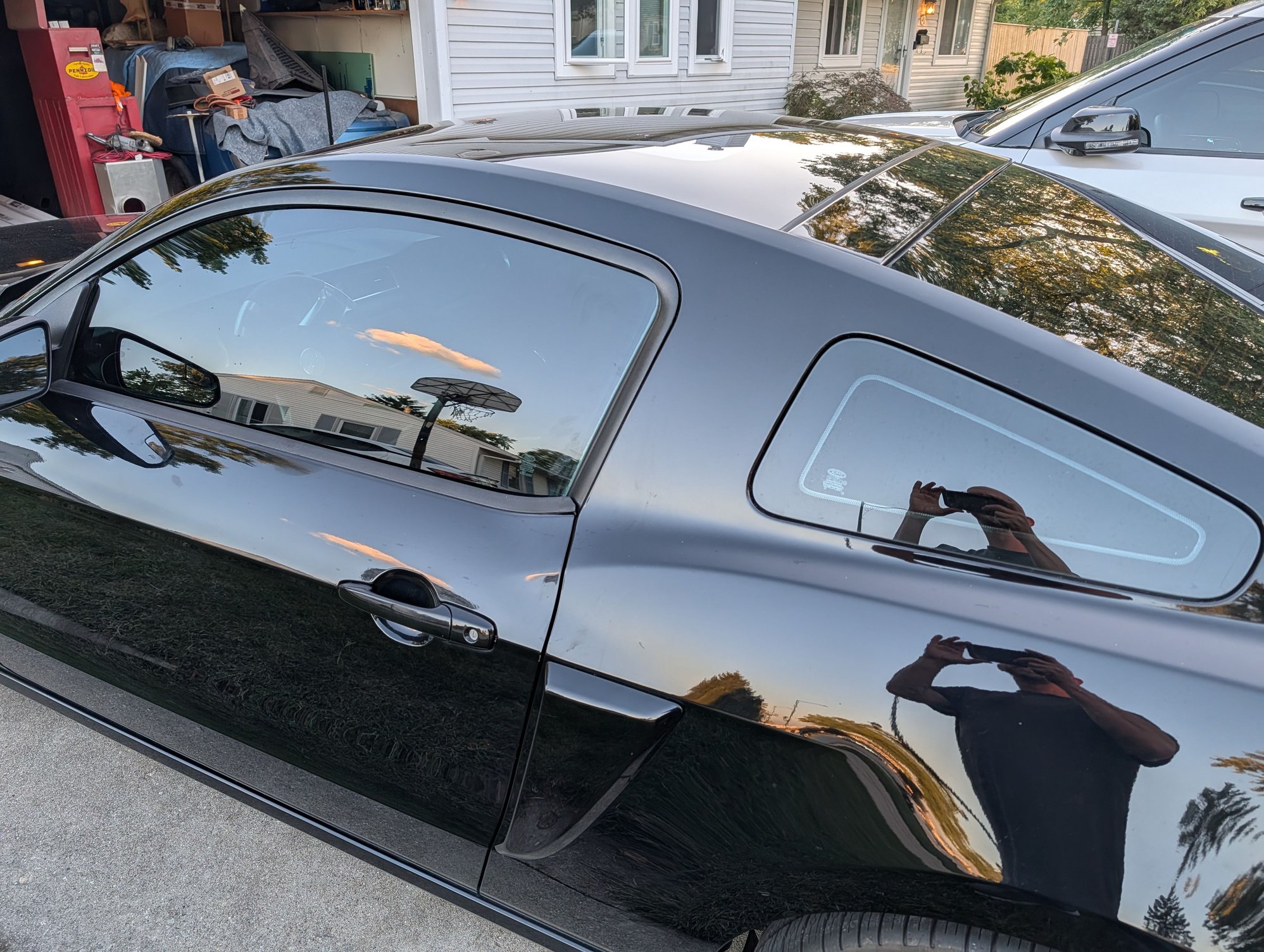

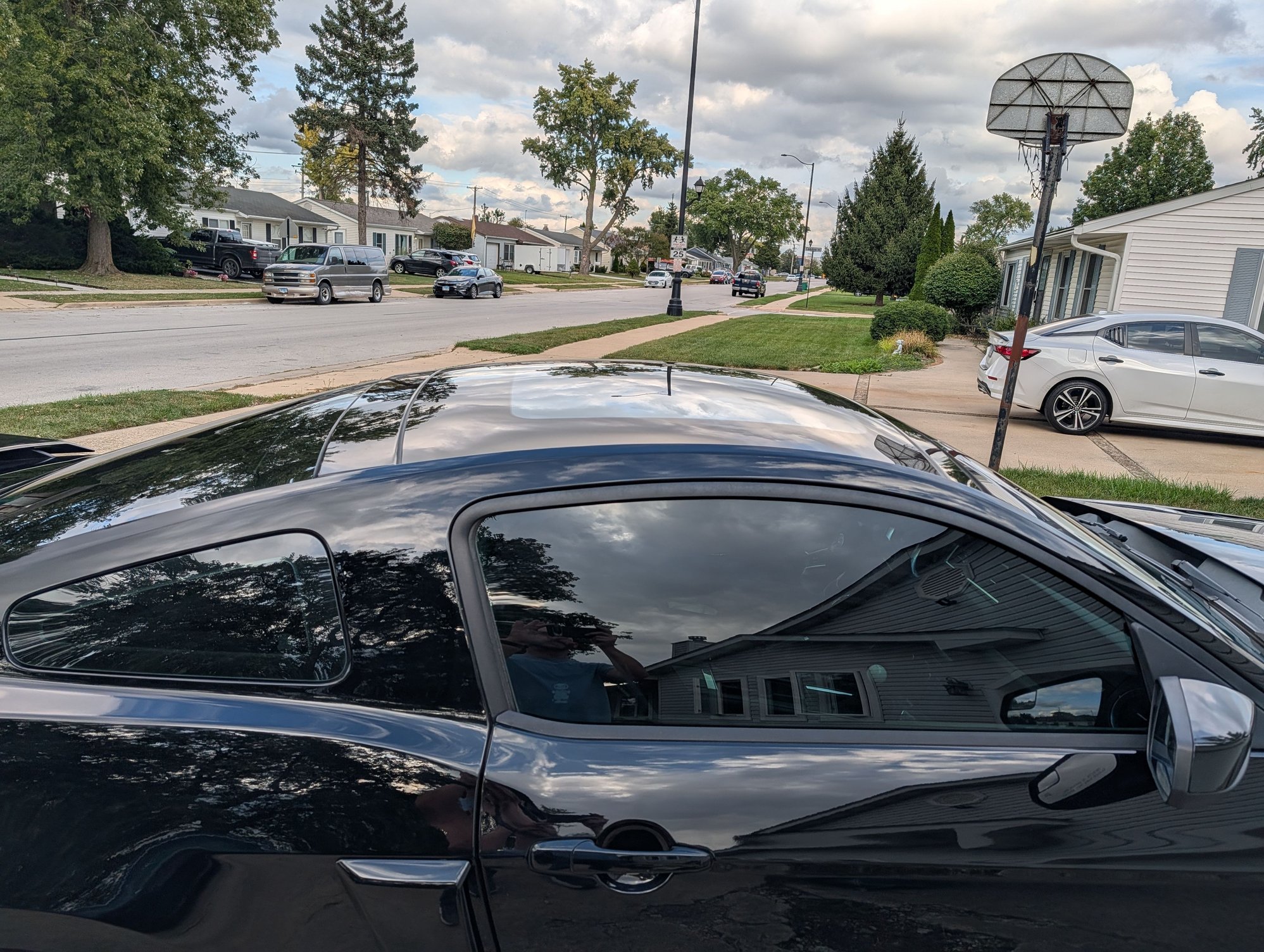

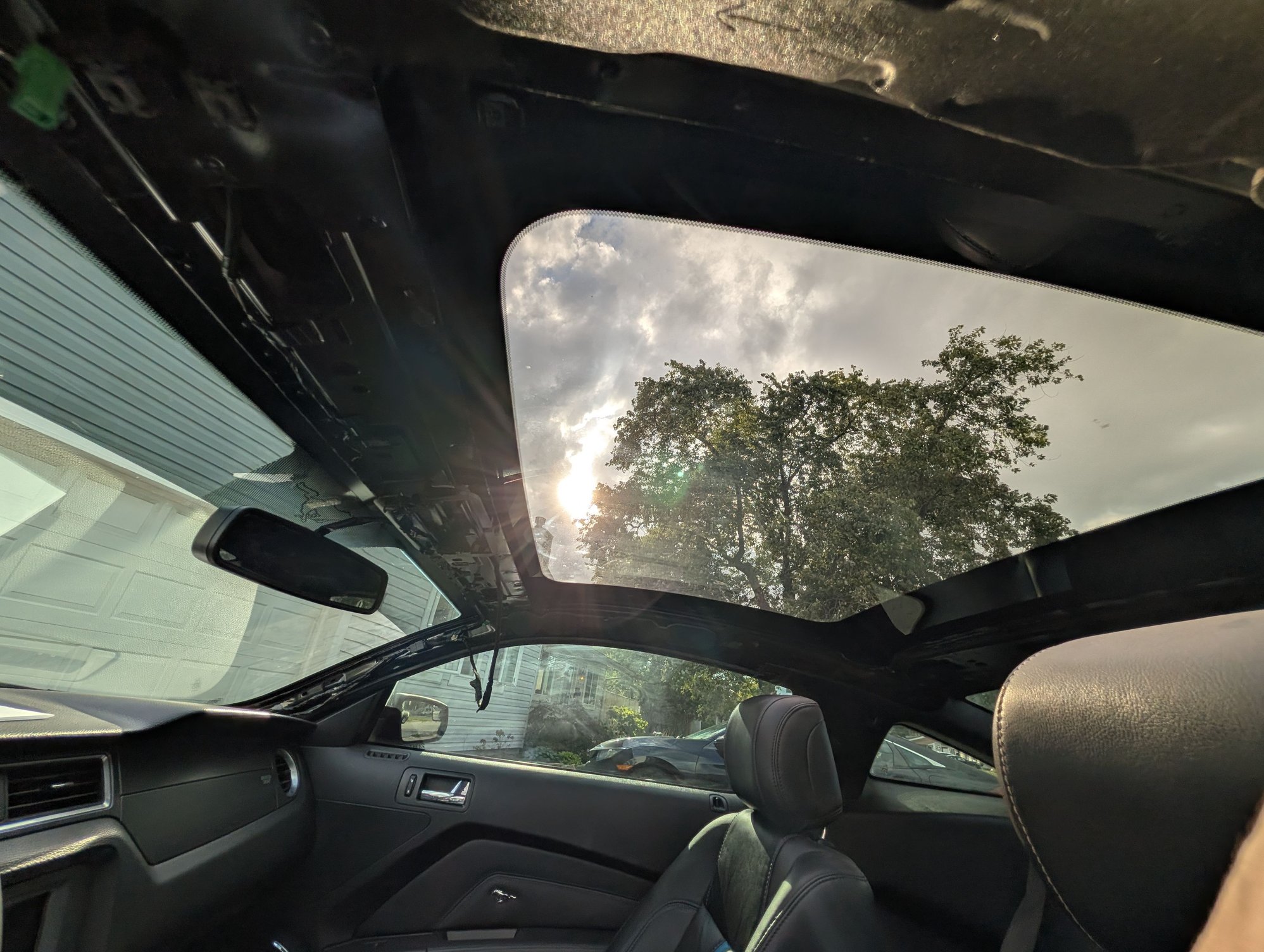

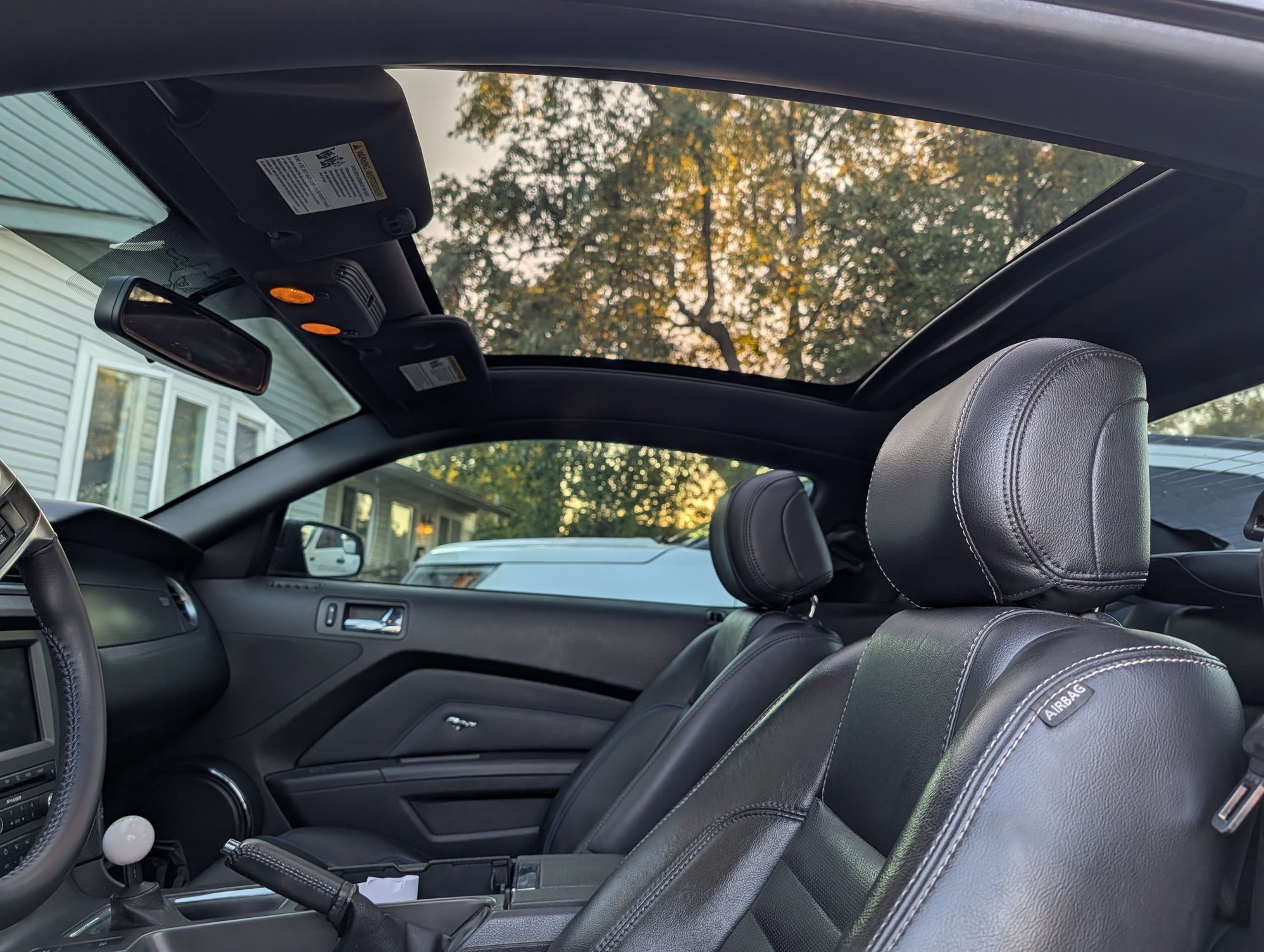

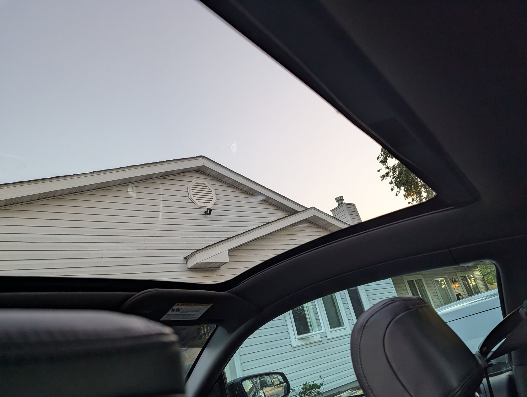

Well Boys I can officially say i am in the glass roof club got the car back yesterday and put the Interior in.
I have wanted to do this mod ever since cdc did it in the late 00s. Always loved the way the concept glass roof car was but never had the chance to get one before they stopped being offered. My first impressions is it adds soo much room to the interior of the car it brings a totally different dynamic to it!
Install was fairly straightforward other than just time.consuming as there is over 200 spot welds that need to be drilled out. Not pictured but I asked about, the frontand rear trim pieces were destroyed coming off he said the glue was really strong and it had to be air chiseled off. The roof this car came from was a 14 so results might vary as far as other people being able to save them. The ford book on the mustang mentions to replace them as they will be destroyed when removed, hopefully they get aftermarket support.
Thanks again again to KC for the huge assist in getting the parts!

Congrats On Probably Having The Last Glass Roof To Be Retrofitted on an S-197! That is Unless The Mouldings Get Repopped!
It Does Look Really Good With The Black Car!
Glad To Have Had a Small Part In The Endevor or I Guess 2 Parts!

Looks very nice. Yes it does make the interior seem bigger and brighter too. I love mine, but on a sunny hot day it is nice to have the shade to pull. Then you don't feel like an ant under a magnifying glass.

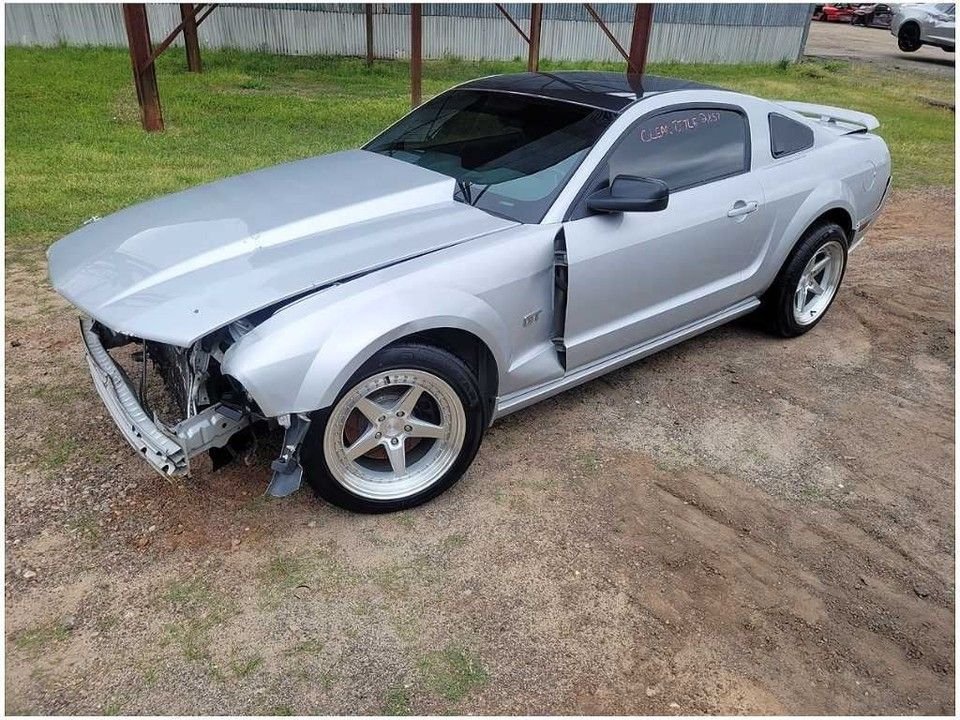

The Parts Farm Has a New Parts Car!
Is That Actually a Glass Roof Possibly Aftermarket or Is it Just Painted To Look Like One!
Too Early to Be a Factory Glass Roof. Anyhoo Just Thought I Would Post To Ponder!
Something Looks Odd!

Looks like a very glossy painted black roof...

Yea if you look thru the pics the roof was painted black

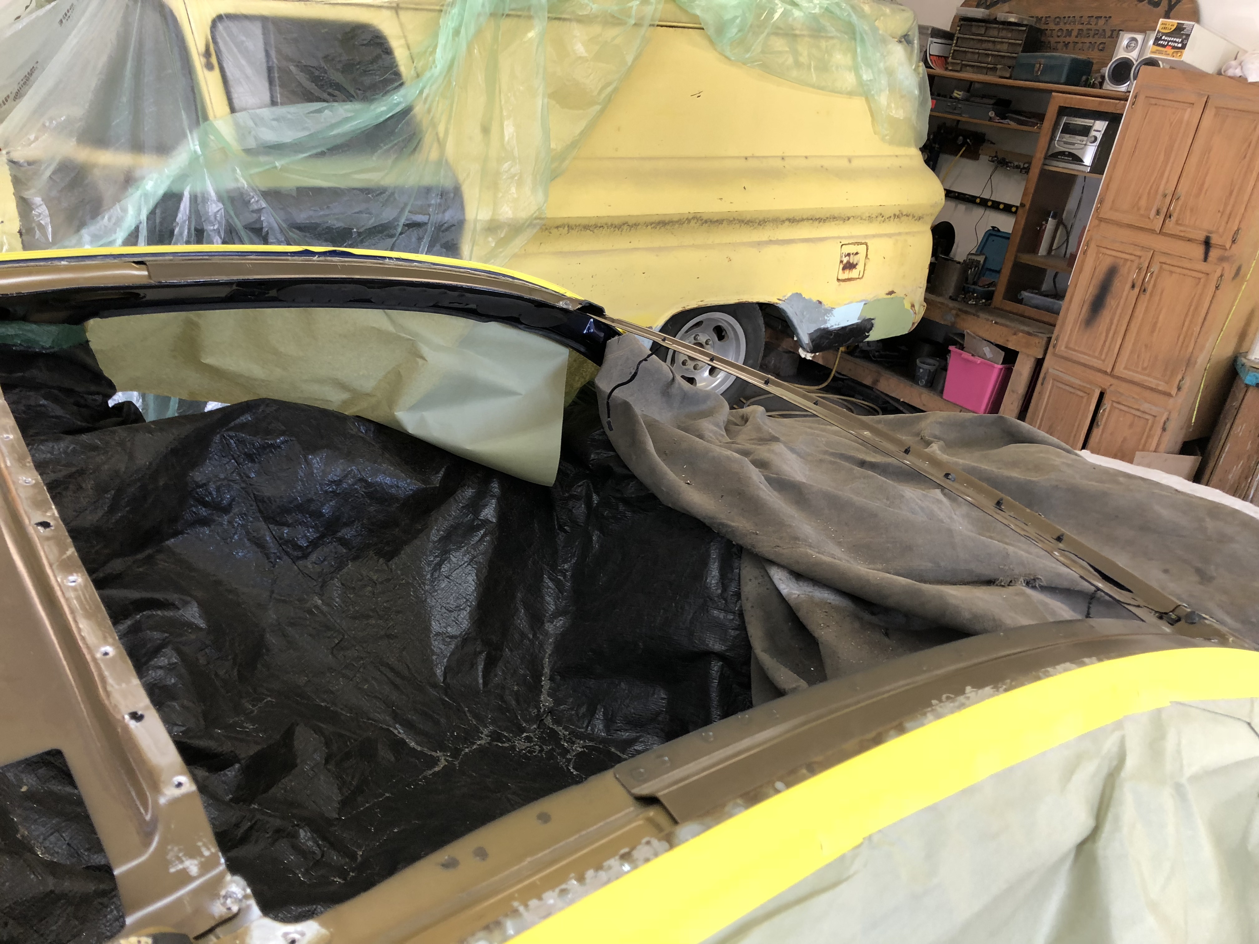

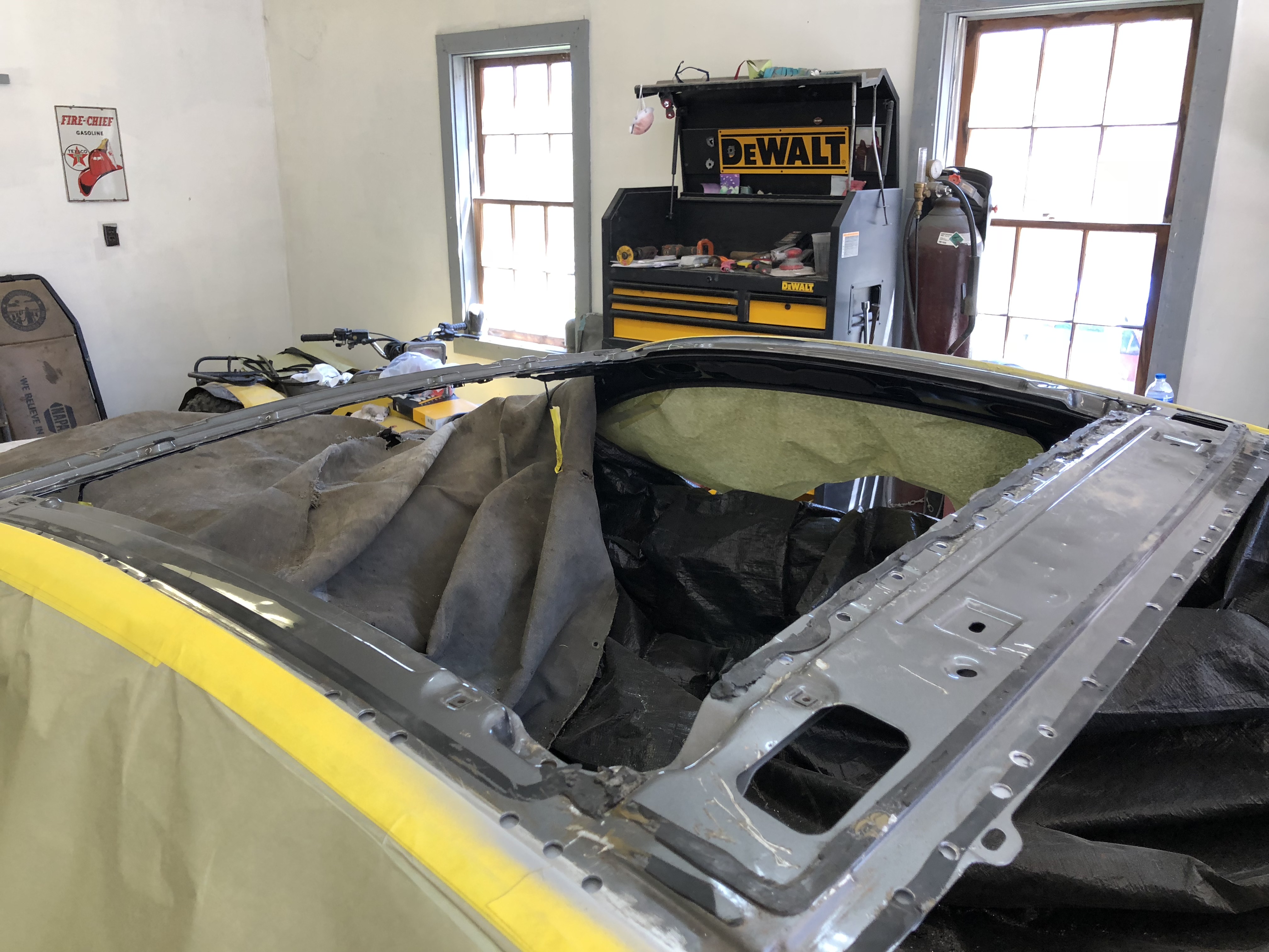

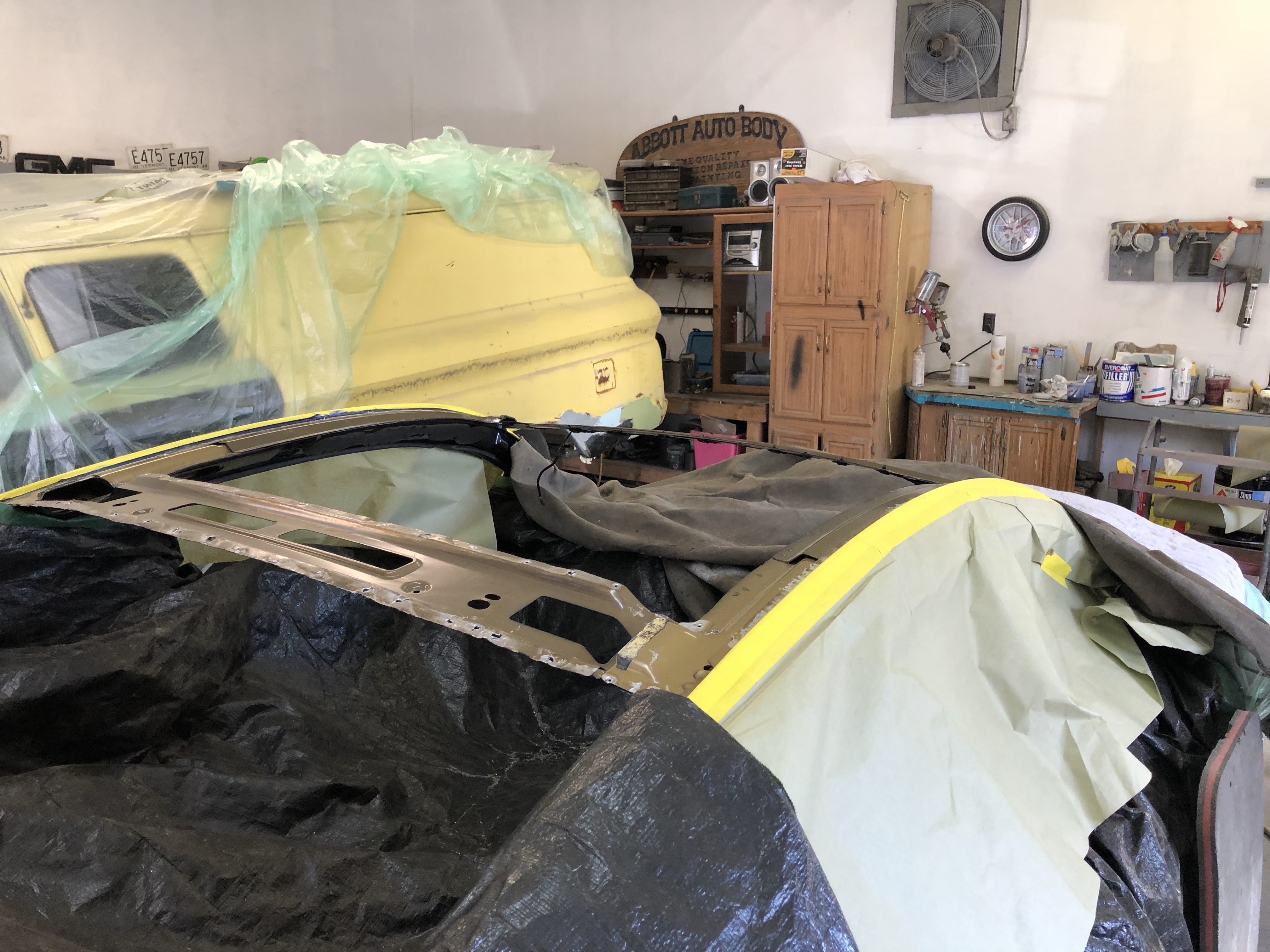

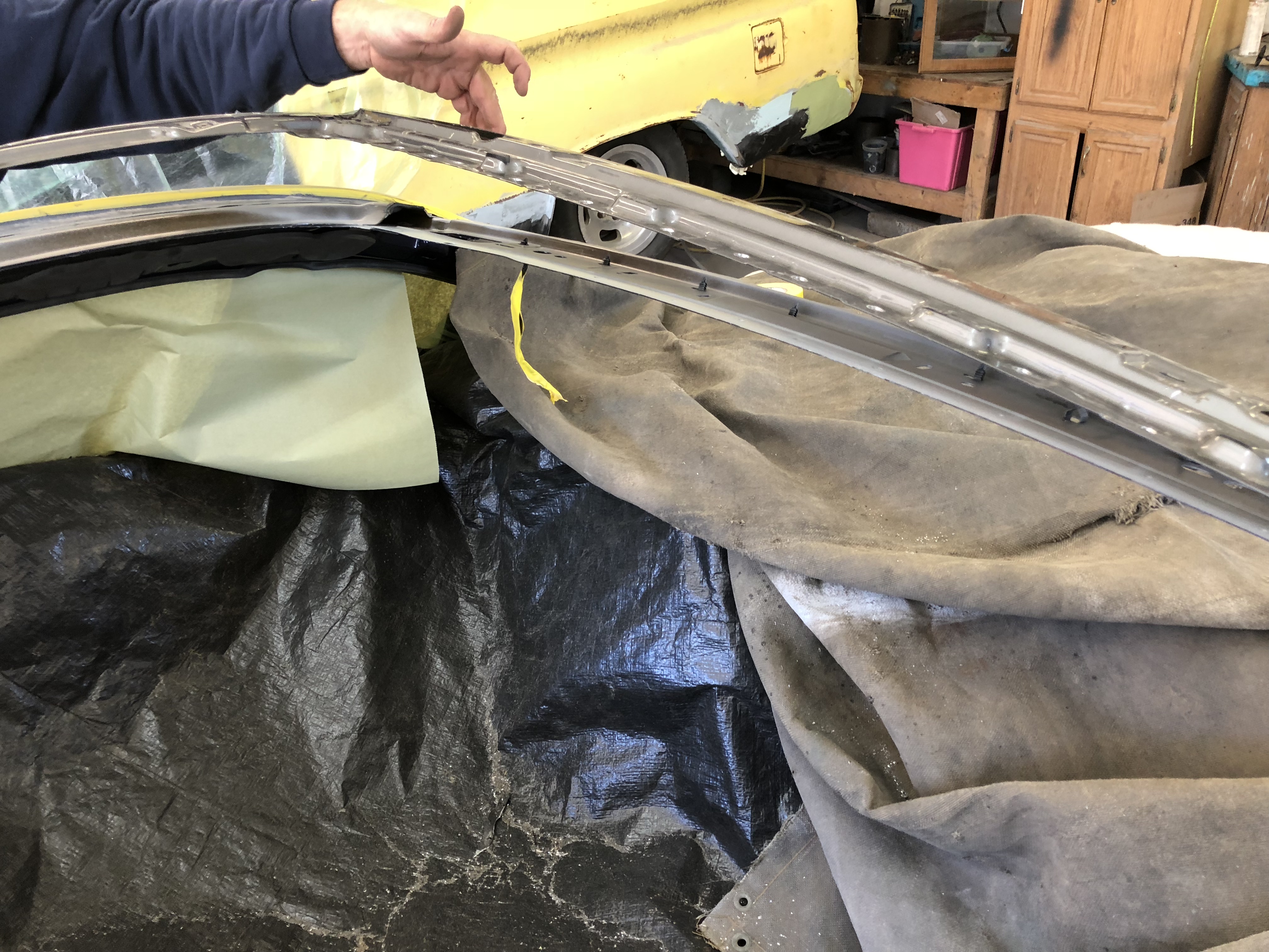

Originally Posted by awoychosky123
Update time!
Went over today and got some work done. My sheet metal roof is now off and the top of the headers are stripped off. Here are pictures of my car without the roof...really at the point of no return now....
Attachment 211743Attachment 211744Attachment 211745

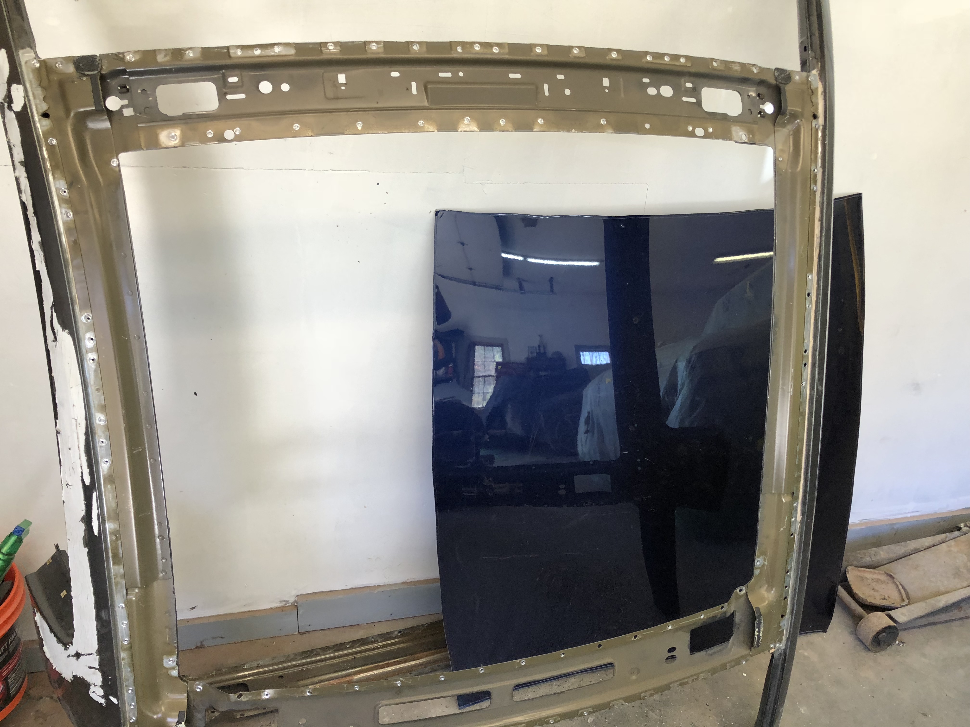

Then we moved over to the donor part. We had to strip the frame that the glass sits on so it could be transplanted over. This was a ton of drilling. We first drilled all the spot welds with a 1/8" drill bit then went back over them with a spot weld drill bit. Then just a chisel and hammer.
This is the frame without the glass on it for anyone curious...you can see my old roof in the background.
Attachment 211746
This is about halfway through separating the frame from the chassis. You can see all the 1/8" holes in it from drilling out the spot welds.
Attachment 211747
This is what the donor part now looks like without the glass frame on it. Looks just like whats on my car right now...same sub frame.
Attachment 211748
Next we decided to do a dry fit of the frame.
This is us dropping the glass roof frame onto the car.
Attachment 211750
This is with the frame on from the front and back.
Attachment 211749Attachment 211751
Starting to look like something. The next steps will be to weld in the frame and get it sanded (remove the urethane, smooth it all out, grind the welds down.) Then it will get primed and painted to match my L6 Kona Blue. Then we are waiting for the black trim that goes between the windshield and glass roof and rear glass and glass roof. Those are made from sheet metal and are impossible to remove without damaging them beyond repair....cost about $1000 in total just for those trim panels. After we put those trim panels in then the glass can go back, then reassemble the car! I should be going back up next Wednesday...by then the frame should be welded and painted. Then its just wait for those trim panels.
On a side note finally got my reverse sensors painted and mounted...not bad.
Attachment 211752Attachment 211753

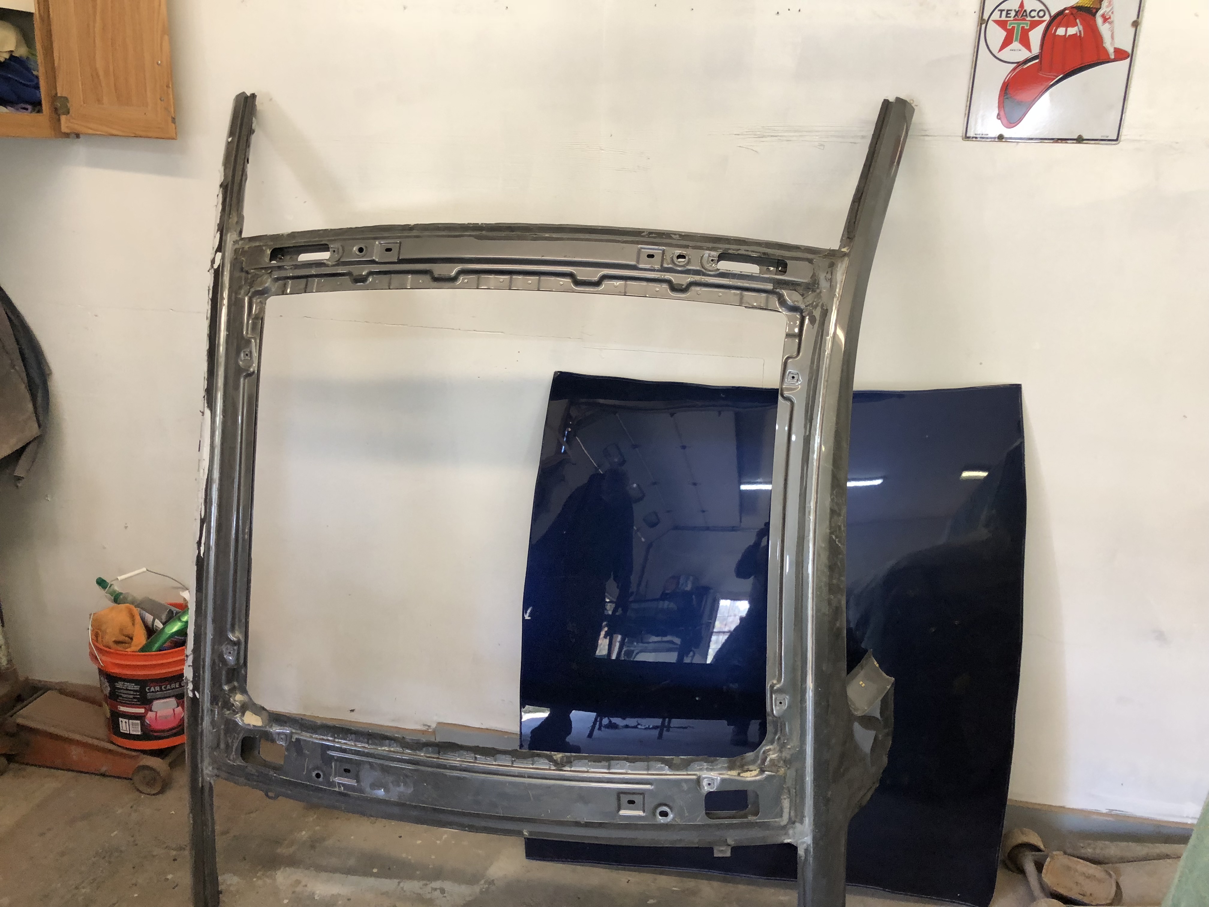

You need to remove the front and rear glass as well as the roof glass to do it. The roof assembly fits underneath the front and rear windshields so there is no way to install it or remove it without taking the glass out.
Self tapping screws are not nearly as strong as welds and will not work for the long term and eventually will loosen up. It needs to be welded together.
You might be able to remove the from from the inside of the car without damaging the front and rear trim pieces but you definitely need to remove the glass roof to get at welds on either side of the roof where the drip rails are currently as they are not accessible from the inside.
