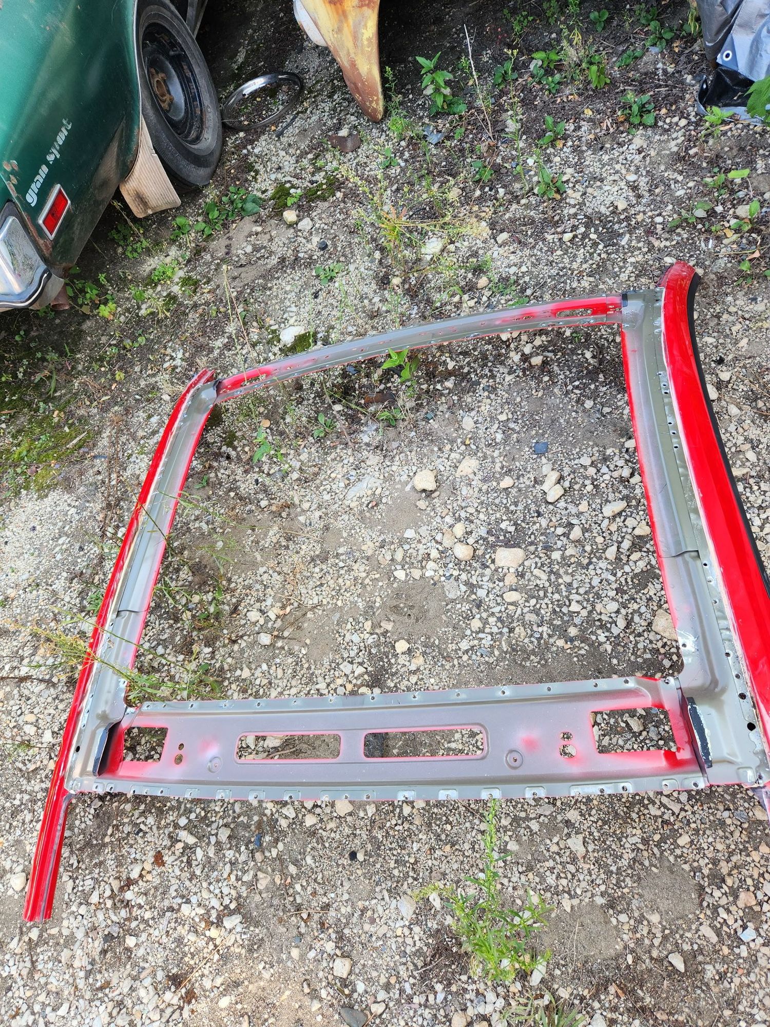

I have located and obtained a donor glass roof from a 2012 Mustang in a salvage yard; it is complete with all exterior pieces, glass, headliner, and sunshade. My only problem appears to be that the front and rear exterior trim pieces that fit between the windshield and the glass roof in the front, and between the glass roof and the rear window in the back, are no longer available; and cannot be re-used as they will be damaged when they are removed from the donor. If anyone has a pair of these trim pieces available, or knows of a source, I would be greatly appreciative.

I Think Your Best Bet is To Find a Way Not To Damage The Used Ones. Since They Would Be Coming Off a Wrecked Car It Would Not Be an Issue If Using Chemical To Soften Urethane So Mouldings Could Be Taken Off intact. I had Located The Last Known NOS OEM Mouldings For a Member A Year Back or So and Just Checked The Ford Locator System Again and No More Have Shown Up!

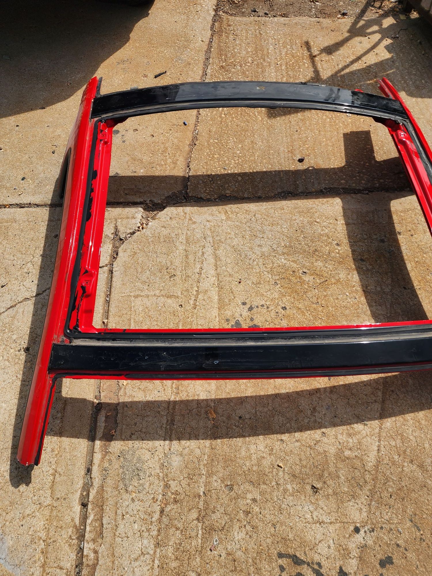

If You Have a Whole Roof Section Coming Off a Car and if Everything is Intact The Mouldings Do Not Need To Be Removed To Install Windshield So Why Couldn't It Be Installed as One Unit?? Unless I'm Missing Something Or Roof Can Not Be Installed With Glass in Place??
I See How Op Drilled Out Spot Welds & Sectioned His Install. But What if You Installed it intact Like Picture? I Know it Looks Scary To Cut Your Car Like This Pic Below. But it is an Option!

Thanks; but we are going with the OP's method (leaving my current roof structure in place and drilling out the inner frame on the donor, and installing the inner frame and glass on my car); rather than cutting the front and rear pillars on my car and welding in the entire roof section from the donor. If the front and rear trim pieces don't surface anywhere, the shop will try to remove them without damaging, or if that's not possible then they will fabricate some new ones. If you happen to run across some somewhere, please let me know!

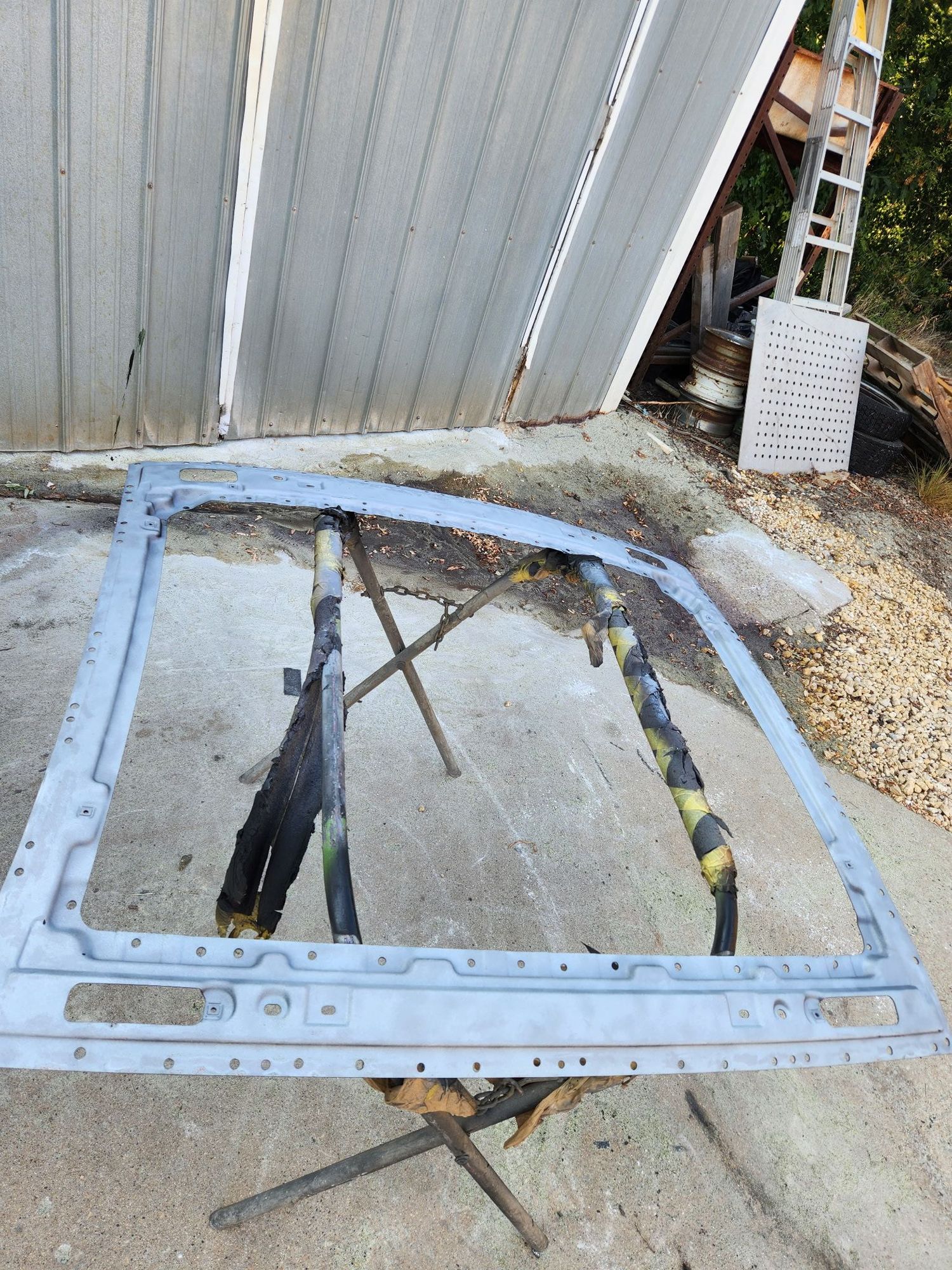

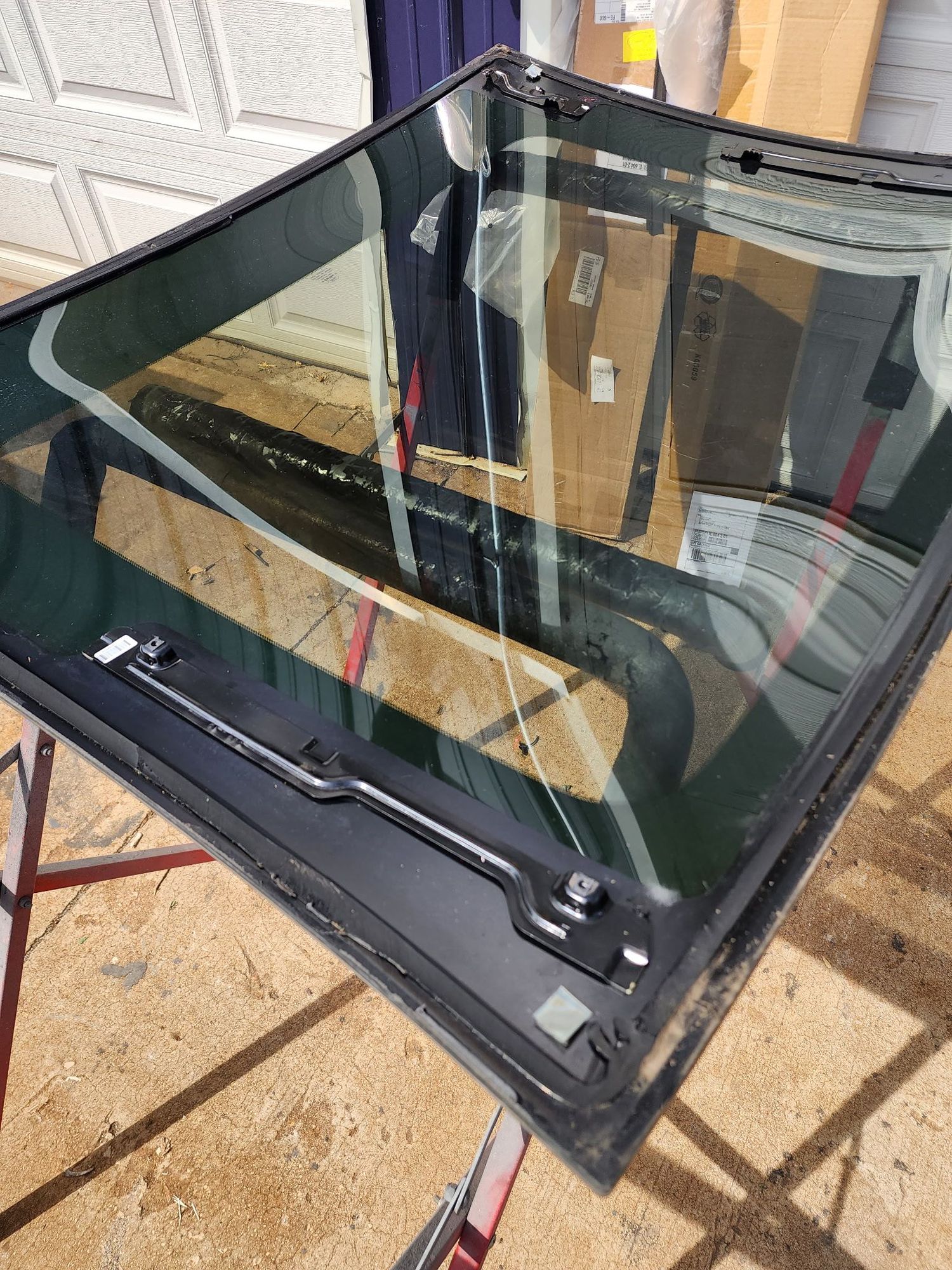

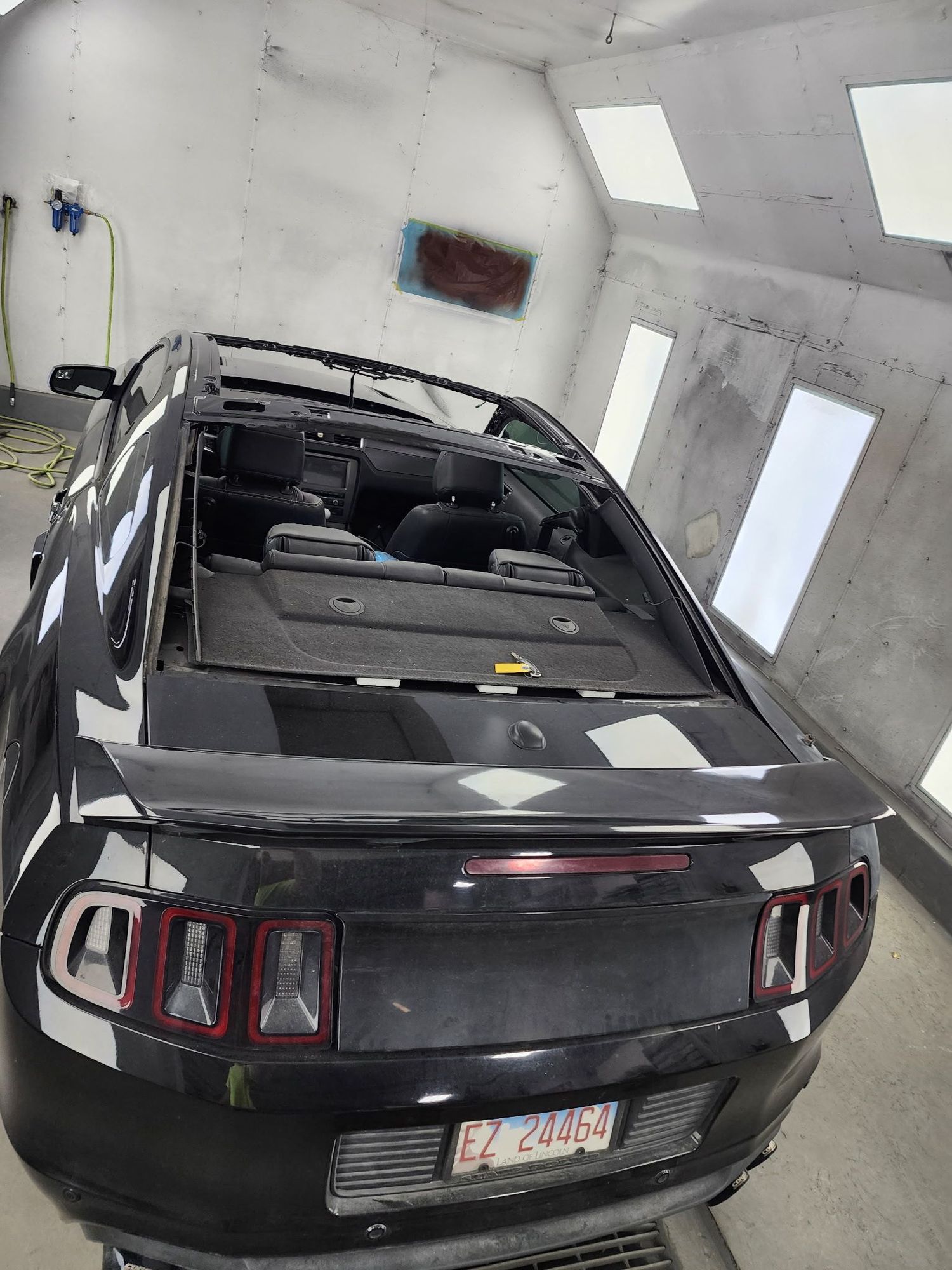

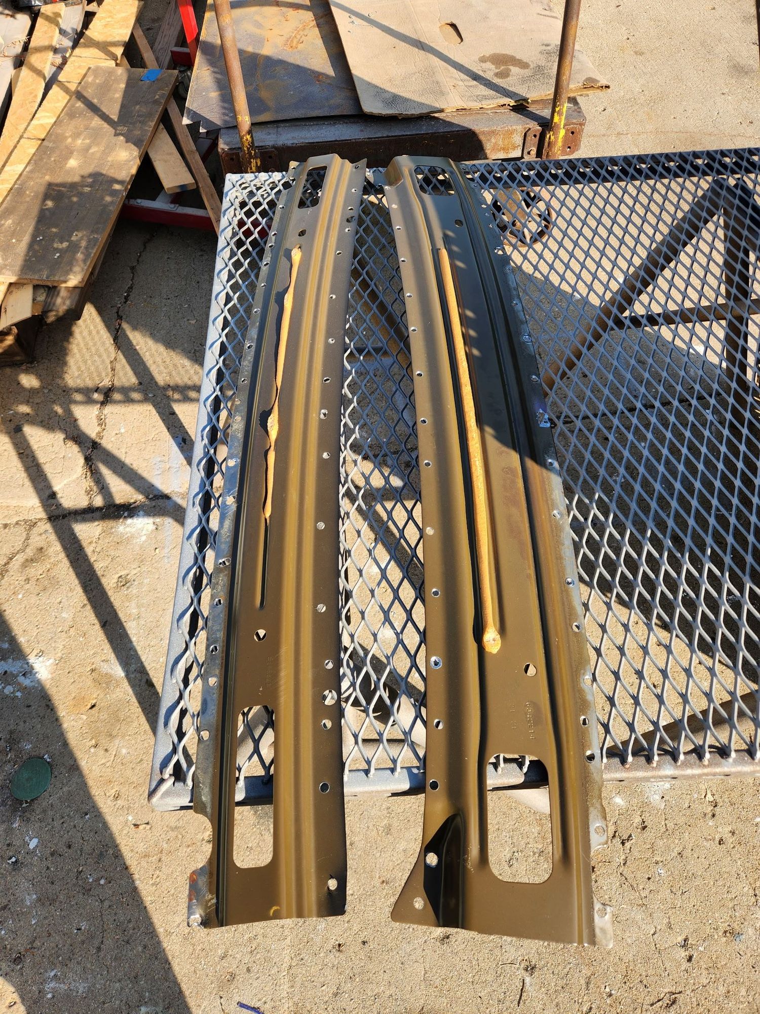

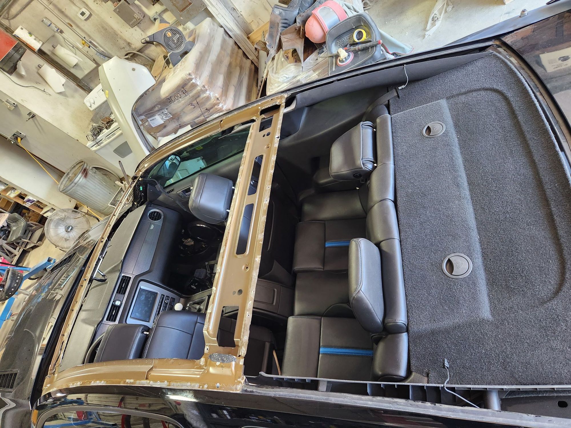

Well I have my glass roof swap started and its looking good so far I imagine that it would be finished this next week! I wanted to show some progress shots of where it is now and answer any questions you guys might have. The roofs inner structure is the same but the outer panels are definitely different and would need to be transfered over. I will find out how the 2 trim pieces came off and if they could be salvageable.
nitely different and need to be swapped from the donor roof.

We Look Forward To Your Progress!
KC

I also reread the thread you probably could section and install the entire roof as it is assembled but most body shops wouldnt want to be responsible for cutting every structural point of the cars pillars off and splicing into them. Tho not impossible tho.

A Way Needs To Be Found To Duplicate Mouldings, Fiberglass, Laser Printed or Cnc Metal Etc. Detailed Pics of The New Mouldings From A Lot of Angles Would Likely Help Somebody Down The Road if You are Able To Do! Just a Request!

Looking like you have made a lot of progress on your project. Looking forward to you next update!

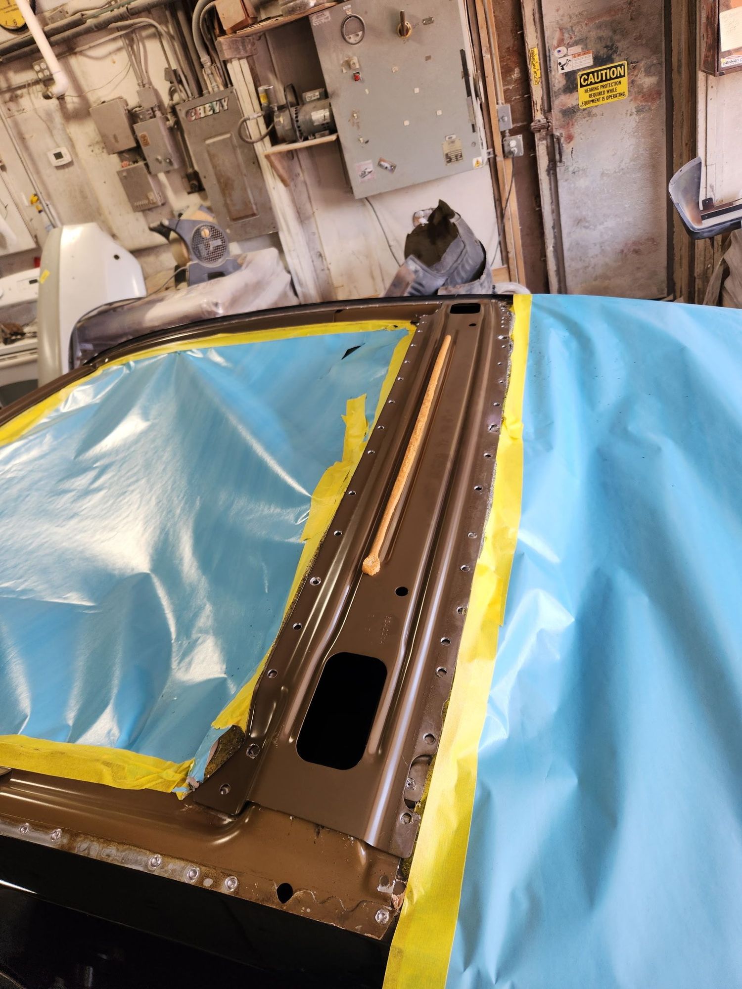

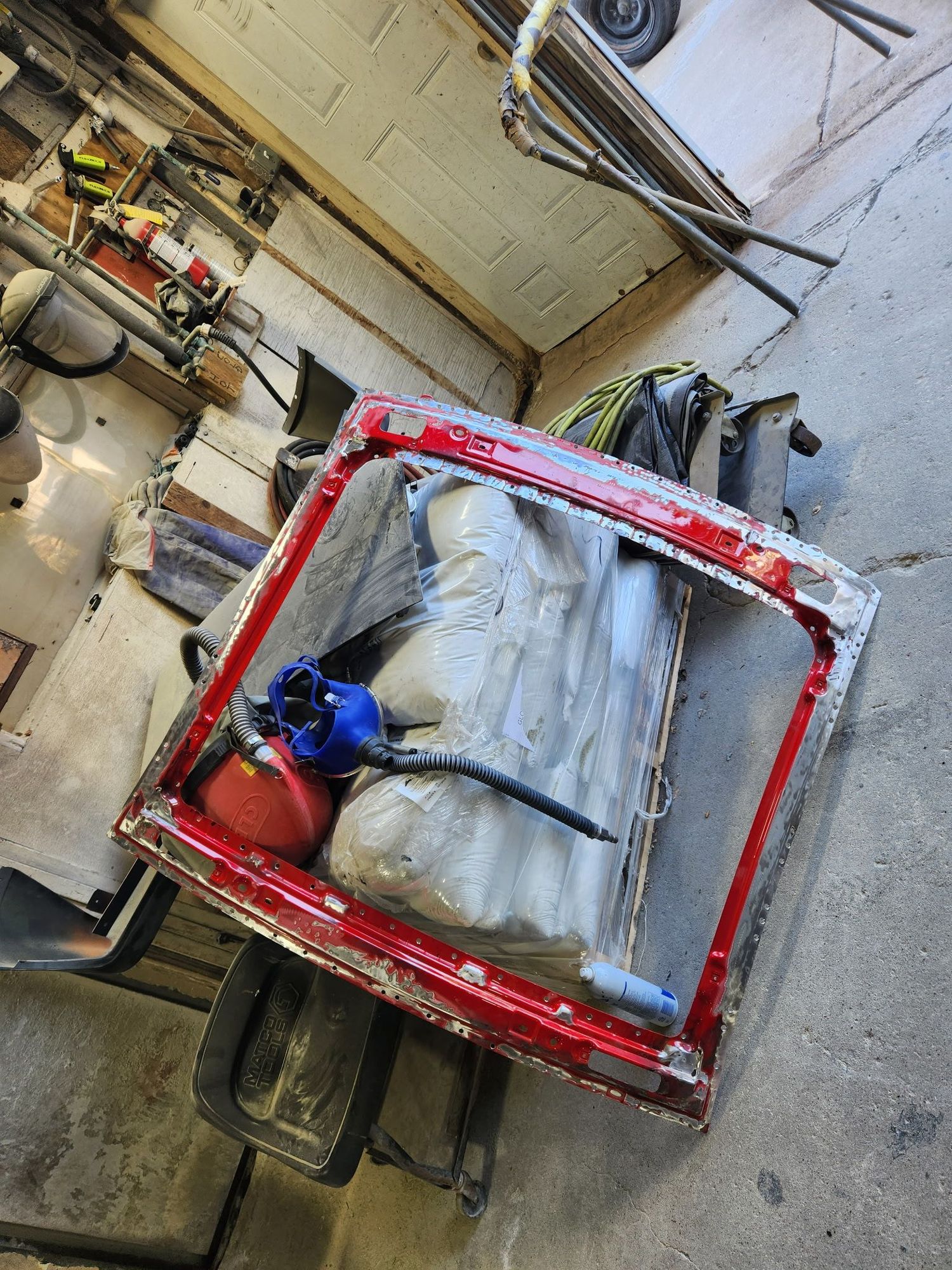

Small update on the car. Since it was in the shop I also had the lower quarter repaired since it was rusting.
The roof hopefully had the glass reinstalled onto it yesterday and then will be painted and I should be getting it back early this coming week. I am so excited to finally have this finished, this has been something I have wanted to have since the first time it was an option to be able to do on the early s197 cars.
