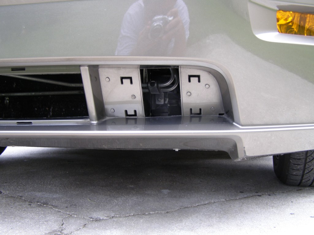

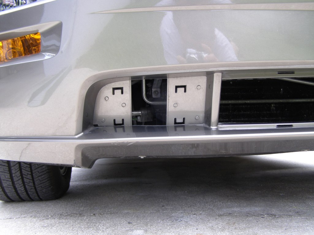

Originally Posted by slowjoe24
How does it look with those pieces out?
The pics below show what it looks like. I've got a spare GT lower grille and I'm working on building a light kit for it - but probably not for another month or so. Given the placement of the openings, I'll probably center the lights in the honeycomb areas. There's another thread going on about that approach:
http://forums.bradbarnett.net/showthread.php?t=66573
Attached Thumbnails Lower Billet Grille for the GT/CS??-lower_grille_surround_r_c.jpg   Lower Billet Grille for the GT/CS??-lower_grille_surround_l_c.jpg

Are these pics of the GT/CS front bumper??
Old Jul 12, 2007 | 08:49 PM
  #66
Dougxox's Avatar
Joined: July 9, 2006
Posts: 1,763
No thats a GT bumper, no lower scoup as on the CS.
Old Jul 12, 2007 | 09:04 PM
  #67
slowjoe24's Avatar
Joined: October 20, 2004
Posts: 2,494
Does ours look like that also?

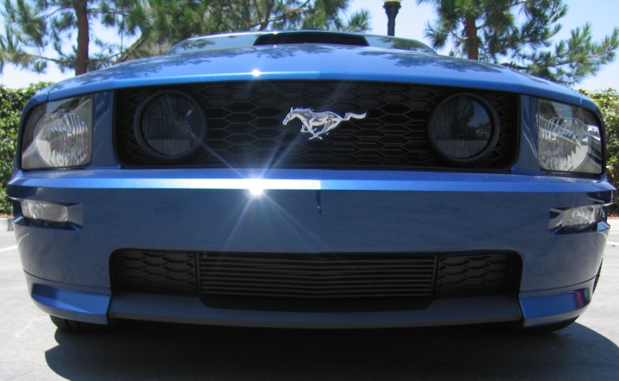

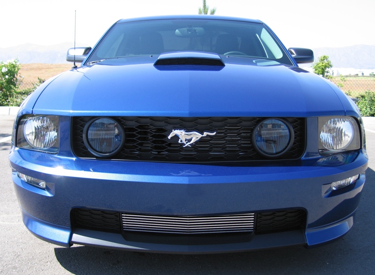

I covered the billet grill with black door edging, I think I'll go back to the chrome and put the two intake scoops, one on each side instead of lower fogs.
Attached Thumbnails Lower Billet Grille for the GT/CS??-gtcs-003e.jpg   Lower Billet Grille for the GT/CS??-gtcs-065e.jpg

TinPony2, that is a subtle touch you have here.

Picked-up the lower grill here in Shelby warehouse. I am disappointed because it doesn't come with instruction and hardware ( screws ). the guy told me that they only made 100 of this prototype. Anybody here hav this on their GT/CS? How did you install this?

I got mine from Shelby just like you and no instructions or hardware. It's really a no-brainer anyway, just pop off the two honeycomb pieces (if you look behind the facia from underneath you will see how they just snap off). I held the grill in place with some cable ties looped thru the bars (pulling it forward to hold it in place) then drill four 1/8" holes thru the facsia and grill, put 4 5/8" self tapping screws in and covered them by snapping the honeycomb pieces back in place. Piece-O-cake. . .
see pics above....

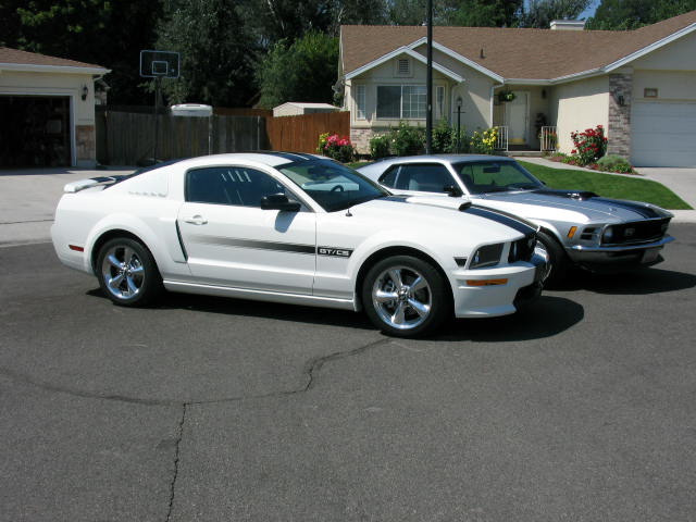

Cool
While it doesn't quite match the upper grille it still looks good and will stop road debris from doing damage to the condenser
Have you got a part number for the lower grille you added?
Where can I get one?
Did you paint it black or did it come that way?
Inquiring minds that want to know.
Thanks
Kennymustang
Attached Thumbnails Lower Billet Grille for the GT/CS??-img_2918.jpg

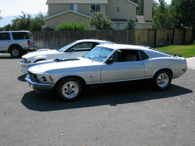

Kenny if you EVER wqnt to sell the '70 Mach 1, will you PM me please?
Old Jul 21, 2007 | 08:27 AM
  #80
kennymustang's Avatar
Joined: May 10, 2007
Posts: 147
Was that an offer??
Attached Thumbnails Lower Billet Grille for the GT/CS??-img_2907.jpg   Lower Billet Grille for the GT/CS??-img_2906.jpg   Lower Billet Grille for the GT/CS??-img_2917.jpg
