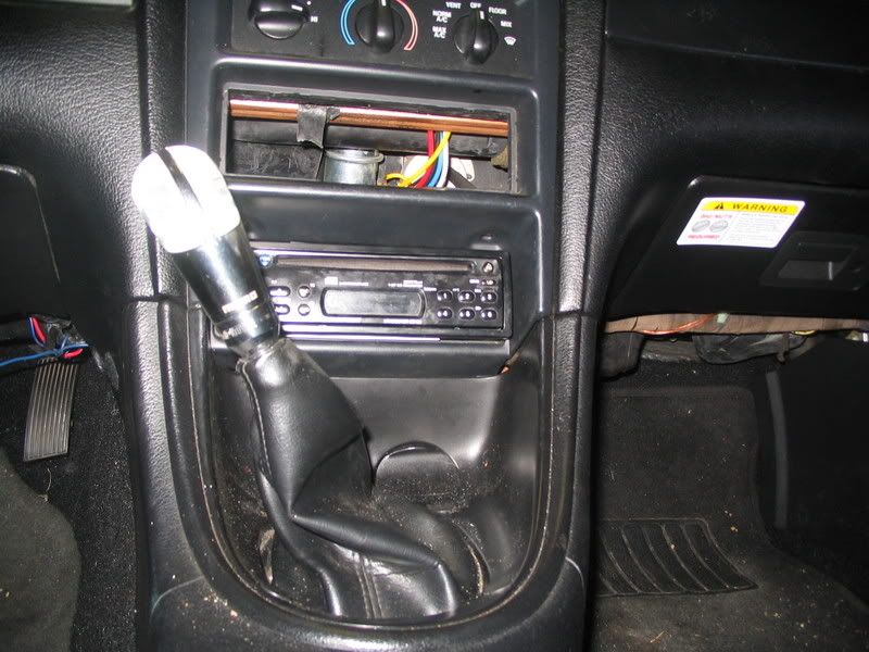

And we have...
A stereo...
http://i23.photobucket.com/albums/b3...e/IMG_3636.jpg
And what have we found out?
That I have no front speakers...
BTW what can I put in that top place? Where the stock stereo usually goes...

typically the stereo goes in teh top one and you can get a sleeve insert for the bottom, or the top i suppose. I know crutchfield has the storage sleeves and it shouldt be to terrible in price.
Switched it to the top one, and it is again working, other than the fact it has no speakers, but that is only a small problem.
