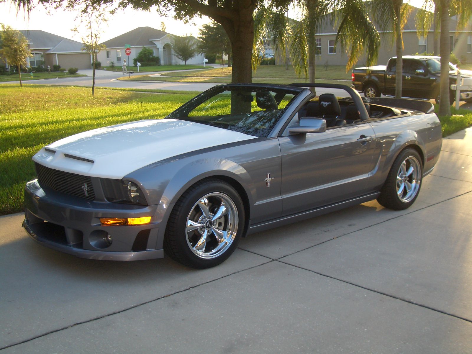

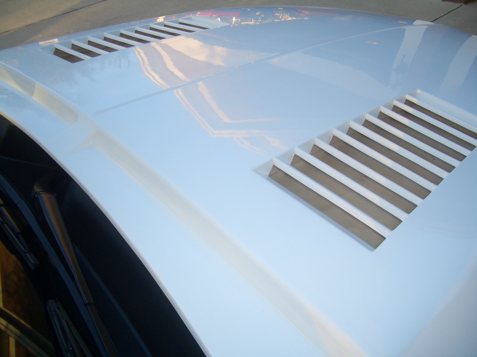

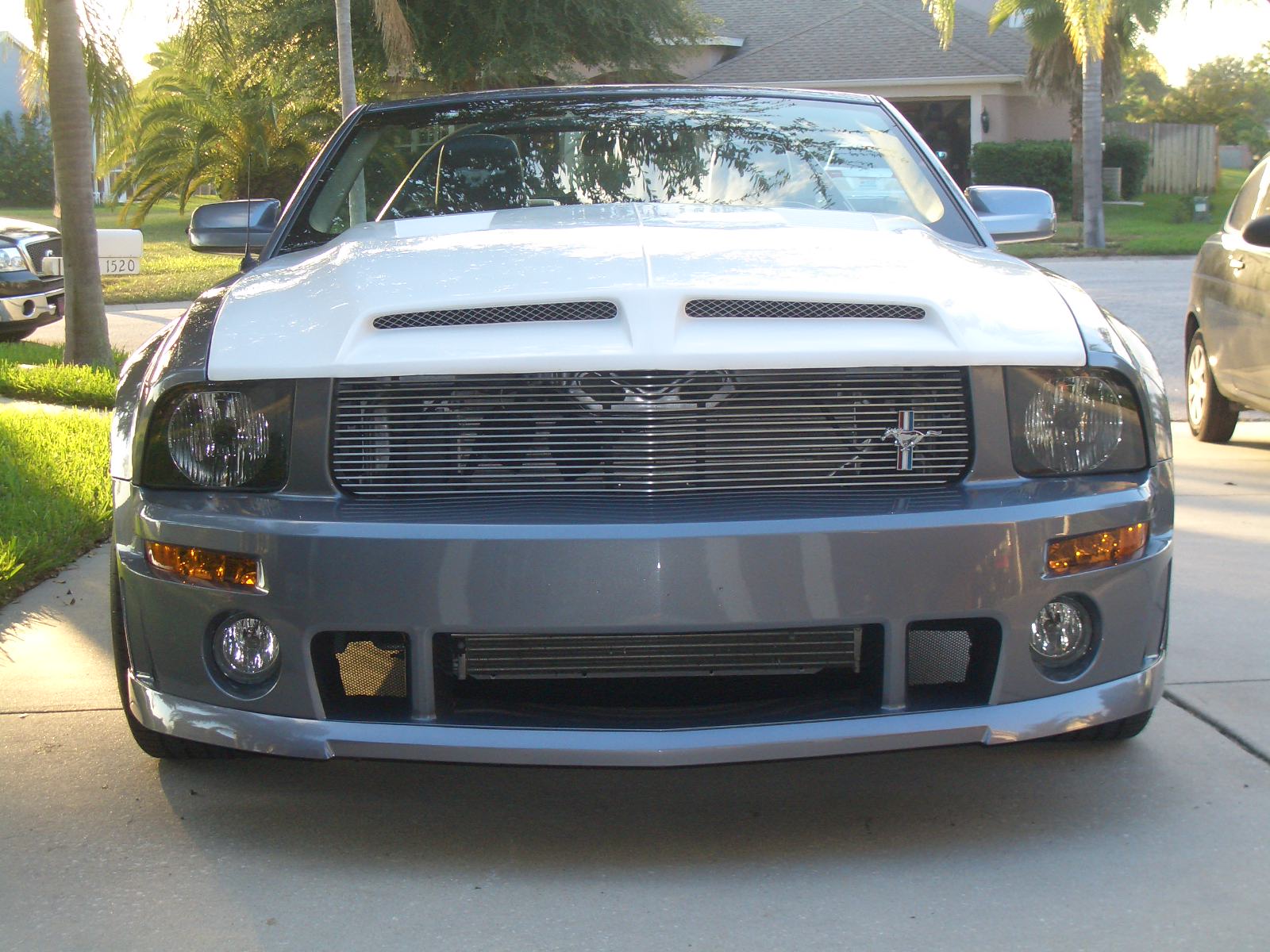

heres some pics installed but unpainted..Nice fit.I did notice a lot of flutter at just 60 mph
Attached Thumbnails Trufiber Gts2-cimg2216.jpg   Trufiber Gts2-cimg2217.jpg   Trufiber Gts2-cimg2218.jpg   Trufiber Gts2-cimg2219.jpg   Trufiber Gts2-cimg2220.jpg
Trufiber Gts2-cimg2221.jpg   Trufiber Gts2-cimg2222.jpg   Trufiber Gts2-cimg2223.jpg   Trufiber Gts2-cimg2224.jpg   Trufiber Gts2-cimg2225.jpg

more
Attached Thumbnails Trufiber Gts2-cimg2229.jpg   Trufiber Gts2-cimg2228.jpg   Trufiber Gts2-cimg2227.jpg   Trufiber Gts2-cimg2226.jpg

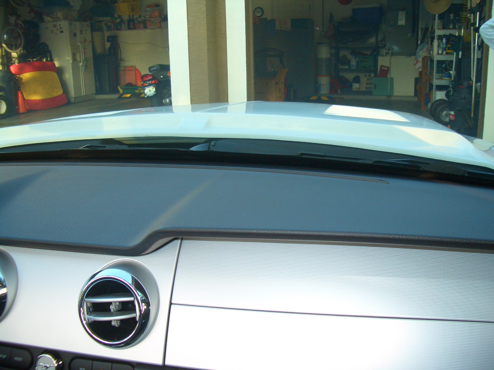

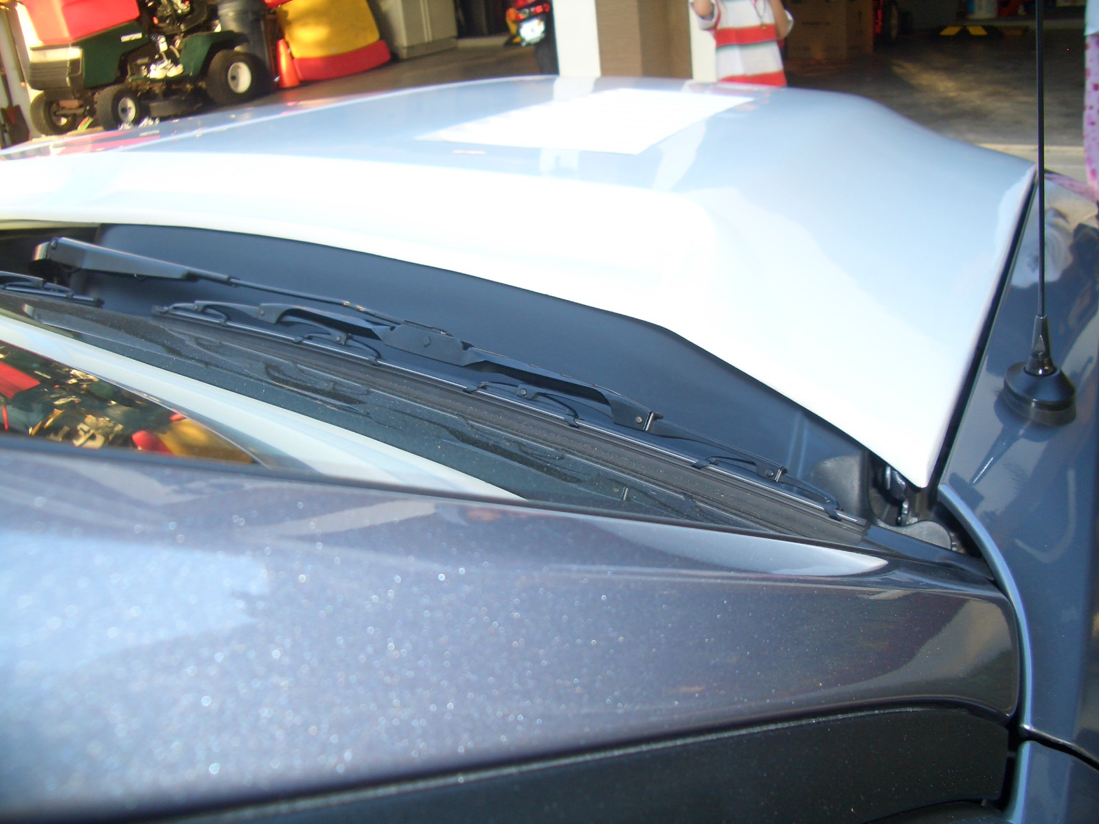

Umm, slow your roll there!! I hate when people speak of my car with no knowledge of it at all! In the future, if there's questions about my car, people can just ask me and I'll tell them or show pics. My hood struts were installed correctly!! They were put under the hinge, NOT between the hood and hinge! There is no way possible to do this with them. That's like saying the engine was installed upside down and that's why it runs rough!! They mount underneath it and also have a little rubber adhesive button that keeps it from digging into the hood. This is not my first go round with struts, and I'm not a moron! I used these struts with the stock hood and with the TruFiber GT hood with no problems. The hood bowed in the middle with the struts on, it did not lift at the back corner, as can clearly be seen in the pic. I have the Steeda struts, and think they did not compress enough to allow for the extra thickness of this hood.
These pictures can speak for themselves, as they plainly show them.
Hood showing bow with Steeda struts on
Hood with no bow after removing stuts
Correctly installed Steeda Struts(hinge is clearly under strut)
Another showing hinge correctly installed under strut
