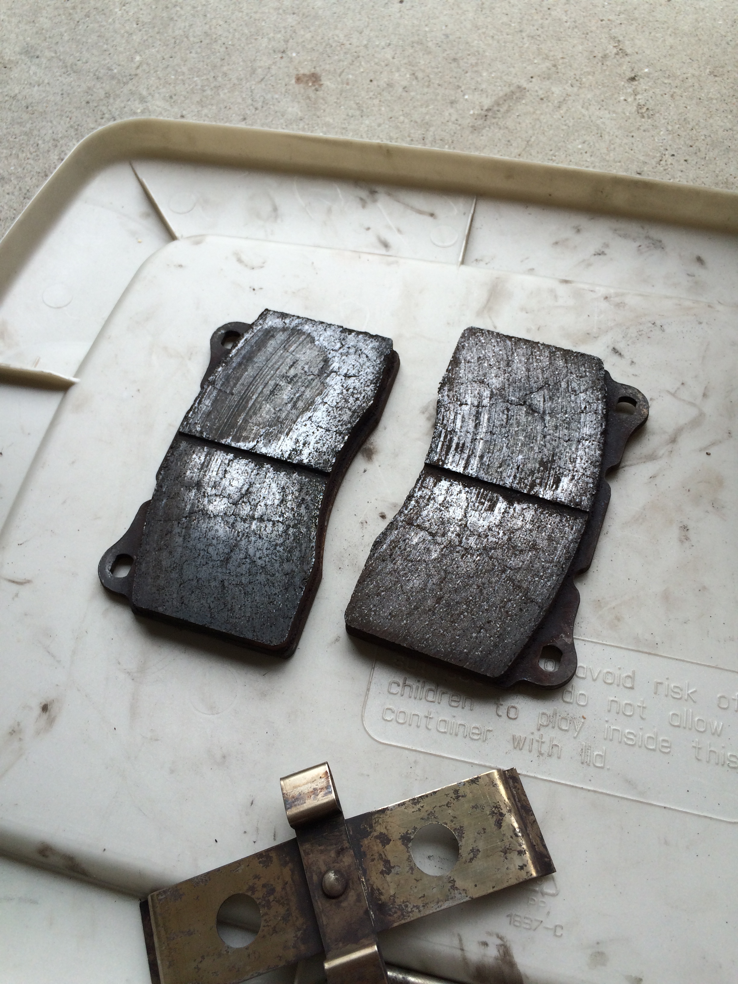

Changed back to my street setup today. My race pads are at about 60% now after 5 track days. Not bad I suppose. I think I can get 8 days total before replacing them with ~3mm lining left or so.
Still loving the Russel lines. Nice firm pedal all day long. I kept XP8s in the back. I'll check in in a few days to provide feedback on noise/dust situation with XP8s in daily driving.

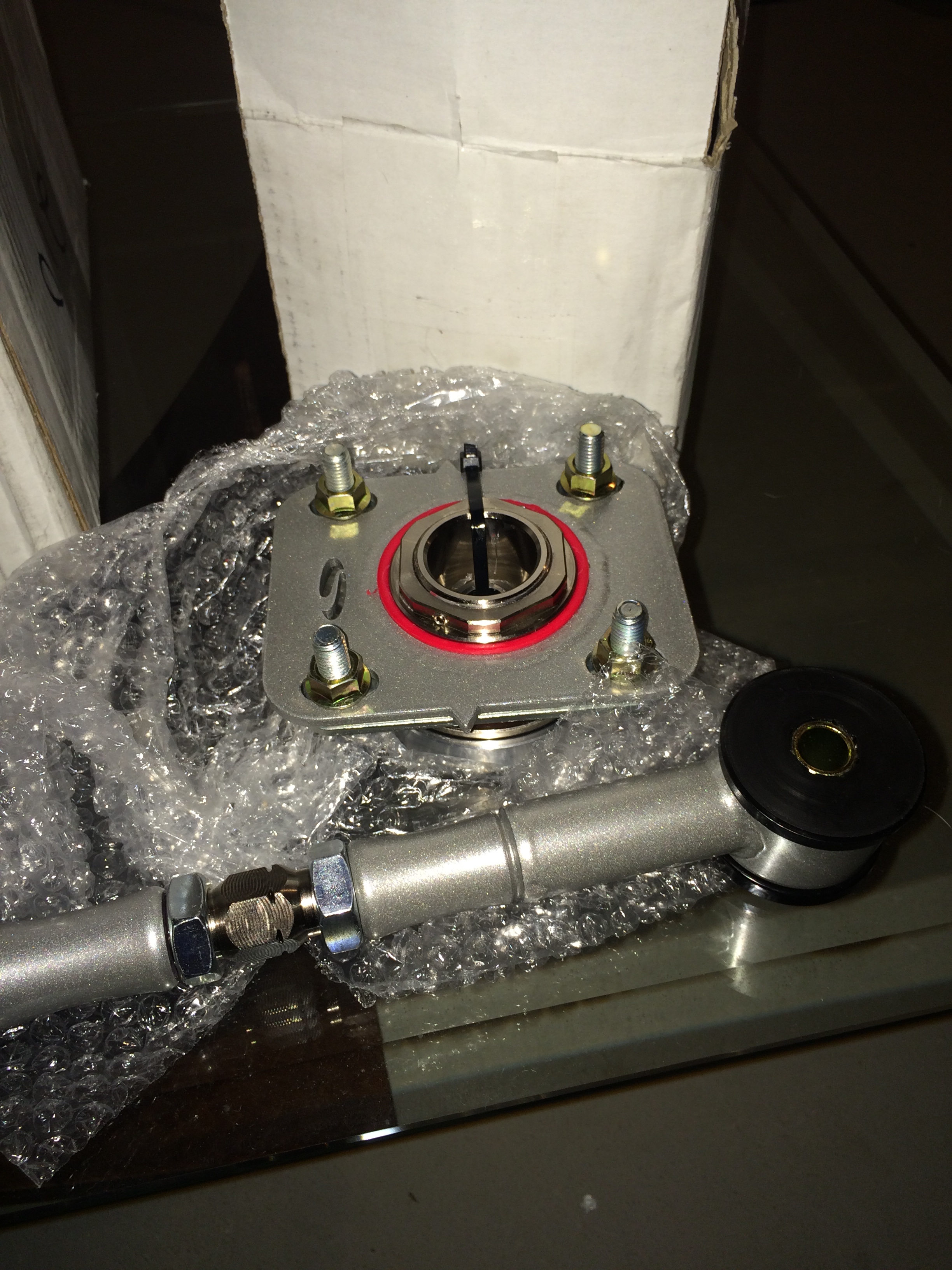

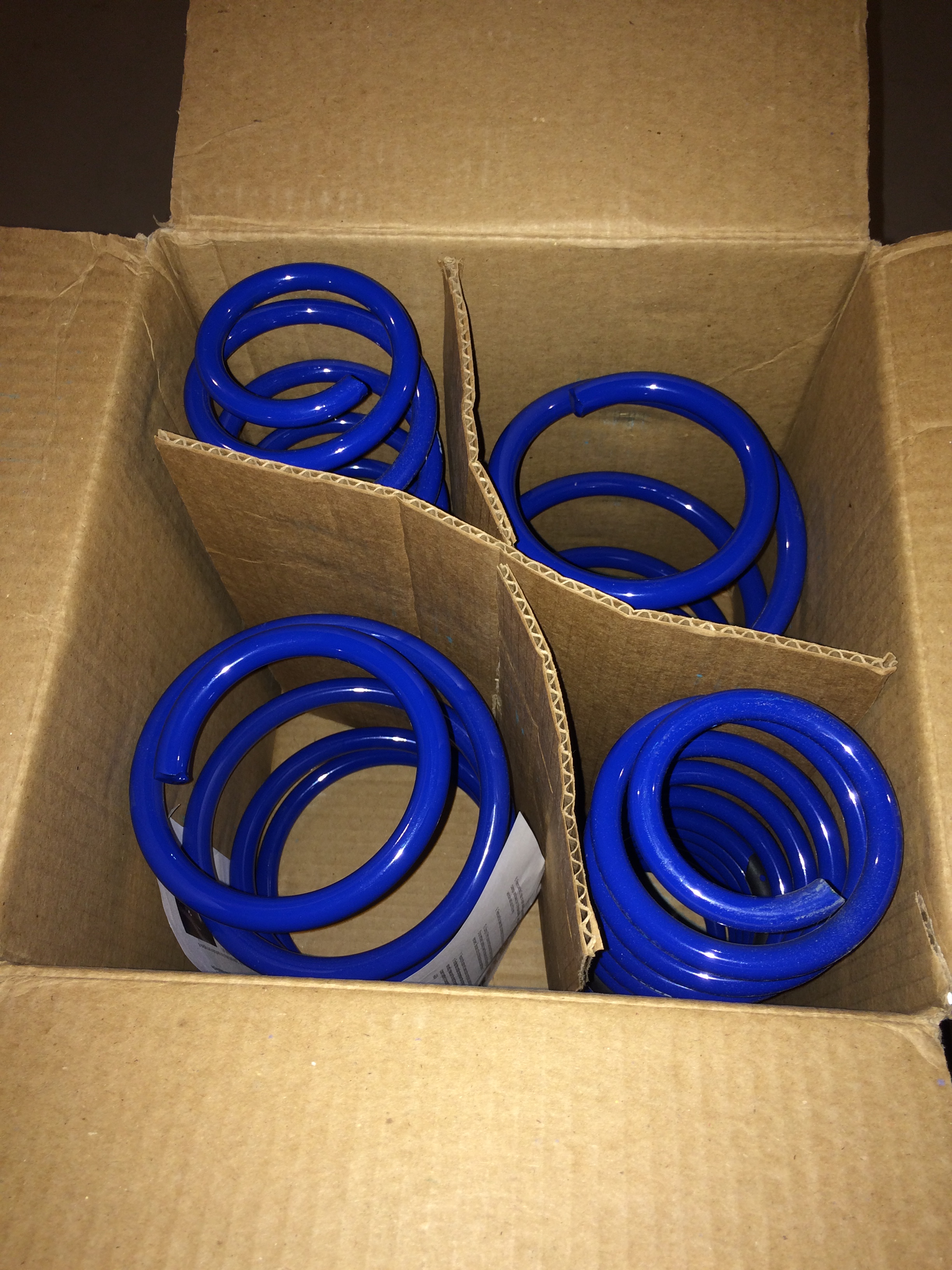

Finally I have some much anticipated suspension mods! After lots of deliberation and research I decided on the following:
1) Steeda Sport springs
Front: 1" drop and 200 lb/in spring rate
Rear: 1.25" drop and 175 lb/in spring rate
2) Steeda HD upper strut mounts.
This will allow me to dial in much needed negative camber. I can go up to-2.5 deg with these and this will make a HUGE difference in mid corner grip I think.
3) Steeda adjustable PH bar
4) Shocks/Struts
Still TBD on these

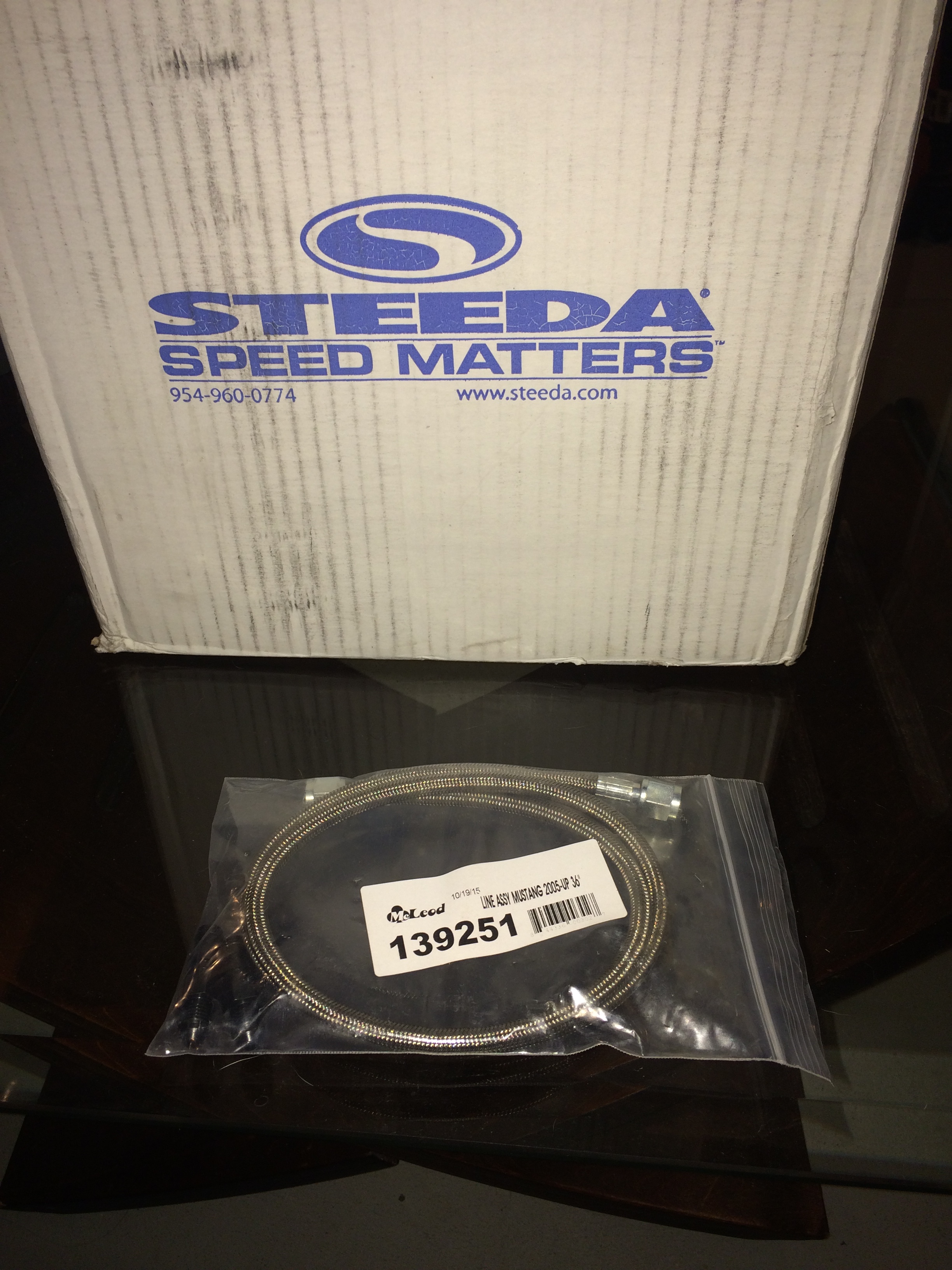

Here are my current suspension spoils, I forgot I have a SS clutch line in there too! :
Attached Thumbnails Track Related Mods-049.jpg   Track Related Mods-050.jpg   Track Related Mods-052.jpg
