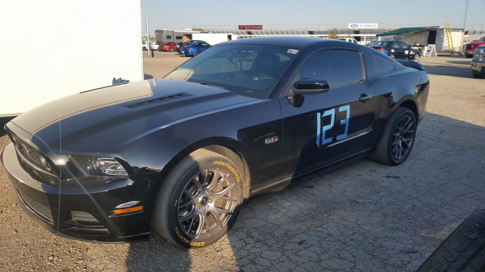

I might have issues

Originally Posted by mustang5o
I might have issues
Attachment 178668
Hope the Contis work well for you. I was not a fan last year... Enjoy the track time!
Thanks. I ran them at the end of the year and they were obviously a huge improvement over running the stock Pirelli PZero's. This year I might switch over Pirelli take offs. Guys around here usually find them for about $100 each so the price is right. I may even get a second (I mean third) set of wheels so I have two sets of track tires. I'm doing several weekend events and I'd hate to lose out on track time due to a corded tire.

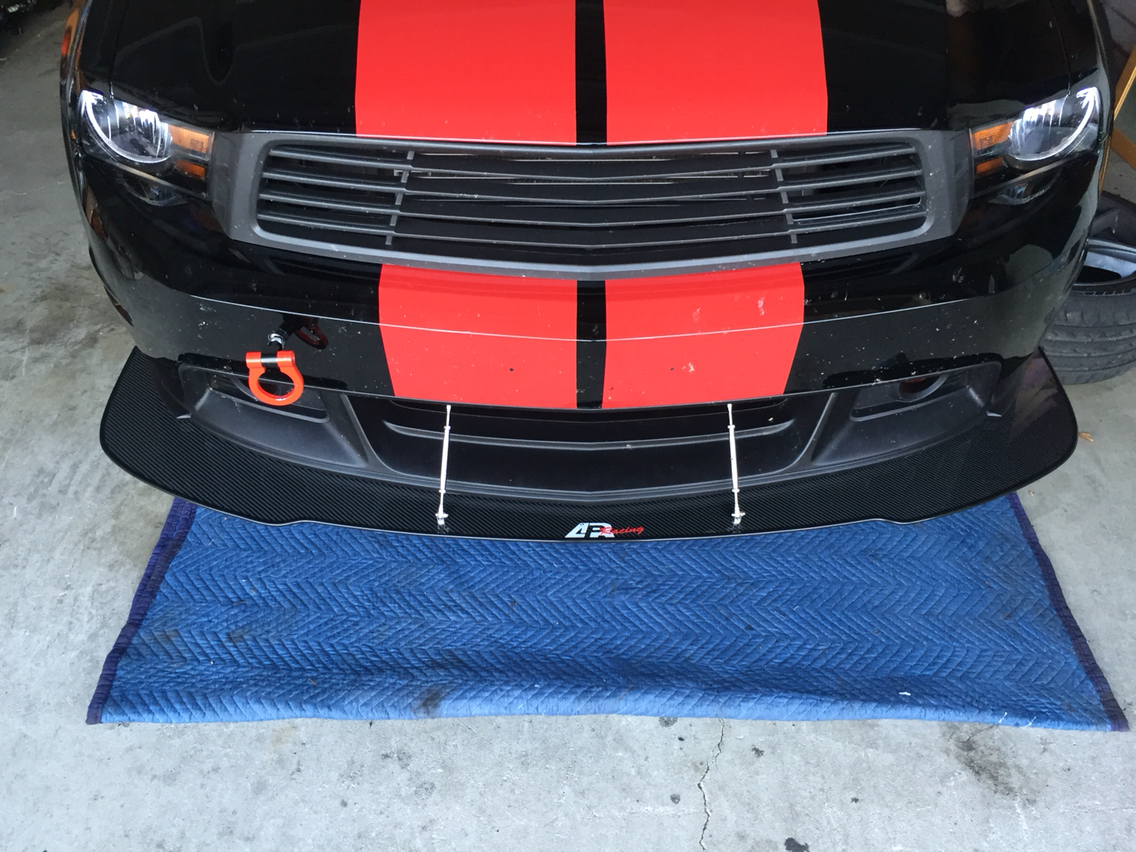

APR splitter came in yesterday so I installed it this afternoon.
Attached Thumbnails Track Related Mods-photo450.jpg   Track Related Mods-photo819.jpg

Originally Posted by redonblackpony
Thank you. Install wasn't too awful bad considering I've had the bumper off 6 to 8 times. Took forever to get, I had to wait six weeks
Where do those turnbuckles mount to? Do you know how long they are? I was considering the Stillen splitter but was hoping to find some longer turnbuckles to go through and actually to the bumper like the Ford one.

The stainless steel adjustable turnbuckles were supplied by APR. they are attached through the top of the ABS plastic lower diffuser. I reinforced the backside with aluminum plates. It will be plenty strong considering the maximum downforce will be 100 pounds.

I thought about taking photos as I put it together but just want to get the job completed so I don't have any photos. I just used a flat piece of aluminum that was 1/8" thick and ran it as a strong back through the backside of the lower facia. Any longer than that and the supplied Bolt would not be long enough
