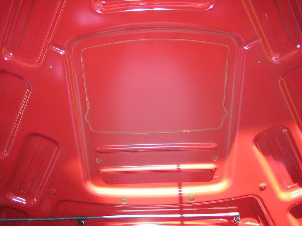

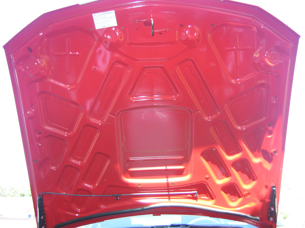

Can you or Tom post a pic (if you took it) of the underside of the hood of exactly where the hole gets cut? I would like to see where it is in relation to the other odd forming doublers.
Attached is my virgin hood for reference, you can mark the area if you don't have a pic.

No pictures, but pretty close to the black line.
Attachment 2596
I'll take a picture of the piece I cut-out and post tomorrow.
I'll post a pic tomorrow so you can see how it compares to Daryl's black line.

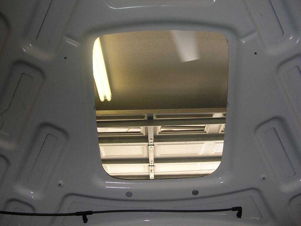

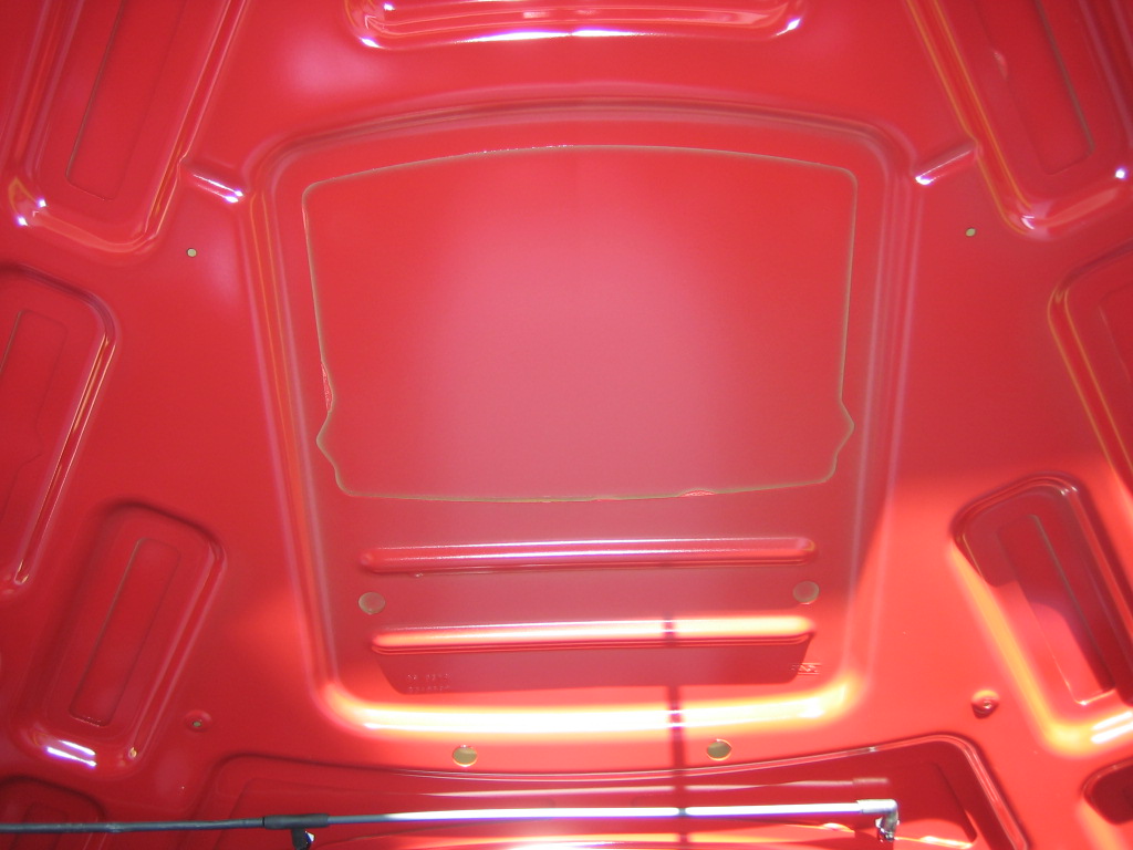

Here's a pic of the underside of the hood:
Attachment 2606
Old Jun 19, 2006 | 08:51 AM
  #1350
Attachment 2606
Thanks Tom
Here they are, side by side.
btw- Did the outer trim ring have enough play (side to side, forward and aft) to center the scoop?
Attached Thumbnails Ponies on The Run!-img_1000.jpg   Ponies on The Run!-shaker-hood-cutout.jpg
I'm sure there will be enough play (more forward and aft than side to side), but I haven't installed anything yet. I'm still waiting for the replacement scoop. Patrick at CDC had a family emergency the day that he was going to get my replacement out. He emailed apologizing, but a few more days is no big deal.

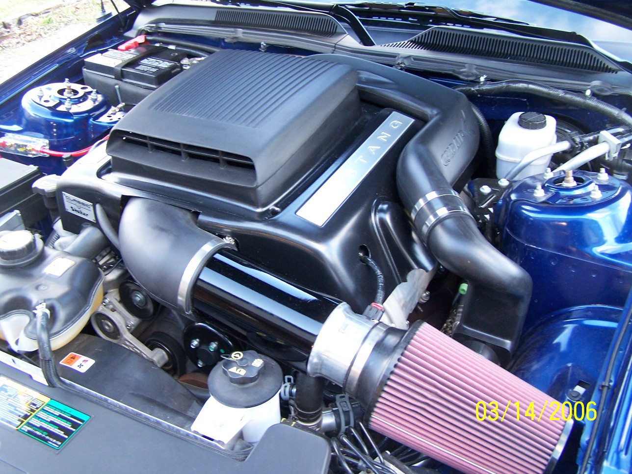

Couple potential issues I can see is the MAF sensor location in the shroud, interference from the K&N tube support bracket (bolts to the cam cover), and the PCV vent hose. Hopefully none will be affected (crossing my fingers!). Guess the only way to tell is to fit the shroud over the engine and see how it all lines up.
On the cold air ducting, I may just route it right up against the cone filter, still leaving the H-shield off ( I hate that thing, but will employ it if I have to). Got the idea from Tom281 (see pic).

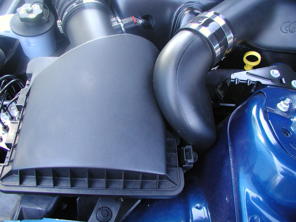

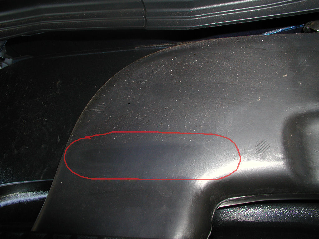

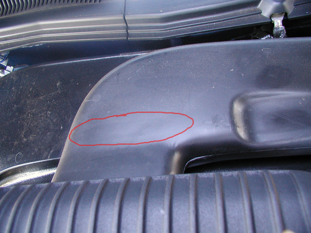

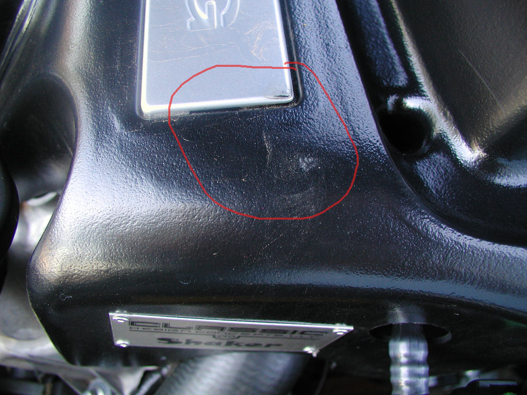

OK For Tom, the RUB SPOTS (pic 1 & 2 the same spot, one with flash one without)
Attachment 2646Attachment 2647Attachment 2648

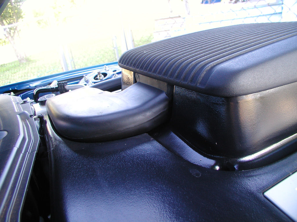

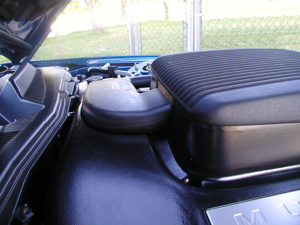

and for Bill a shot from the side showing the intake tube, etc.
Attachment 2649Attachment 2650
Attached Thumbnails Ponies on The Run!-rub-spot-1.jpg   Ponies on The Run!-rub-spot-2.jpg   Ponies on The Run!-rub-spot-3.jpg   Ponies on The Run!-airbox-1.jpg   Ponies on The Run!-flow-tube-1.jpg
Old Jun 19, 2006 | 05:21 PM
  #1359
OK For Tom, the RUB SPOTS...
...and for Bill a shot from the side showing the intake tube, etc.
Rub spots?? Huh? First I've heard of this. Please explain what you're seeing. I wonder if our 06 hood insulation liners are formed differently (ie. Ours have the 7 holes for the future hood scoop) compared to early 06's and 05's.
I noticed a deep rub mark in my liner from the K&N cone filter.

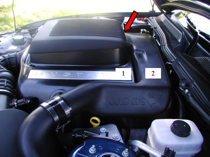

Thanks for the side pic. Can you please take another from the other side, as indicated by the arrow?
Is the shroud (#1) and duct (#2) connected by a clamp or is it one piece?

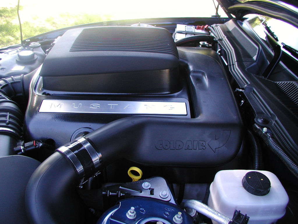

This answer your question Bill?
Attachment 2652Attachment 2654
It better, becasue I got stung by a BIG RED WASP getting those pictures for you.
Bent down to look at the vinyl stripe and put my shoulder right on him, needless to say he let me know he was there.
Attached Thumbnails Ponies on The Run!-flow-tube-2.jpg   Ponies on The Run!-flow-tube-3.jpg
