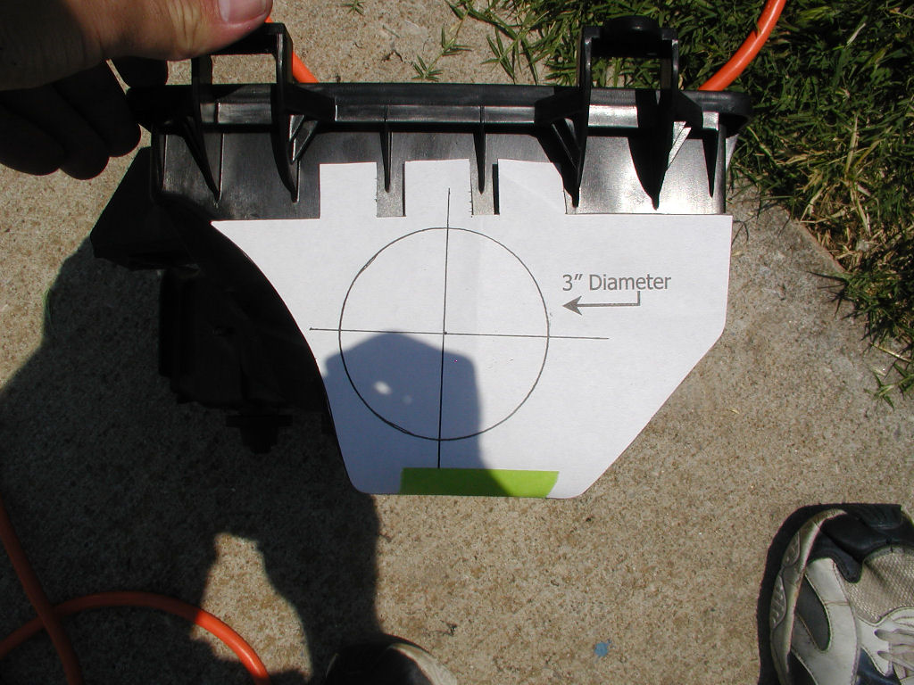

PART FIVE OKCMustangGT's Shaker Hood System Install Write-Up

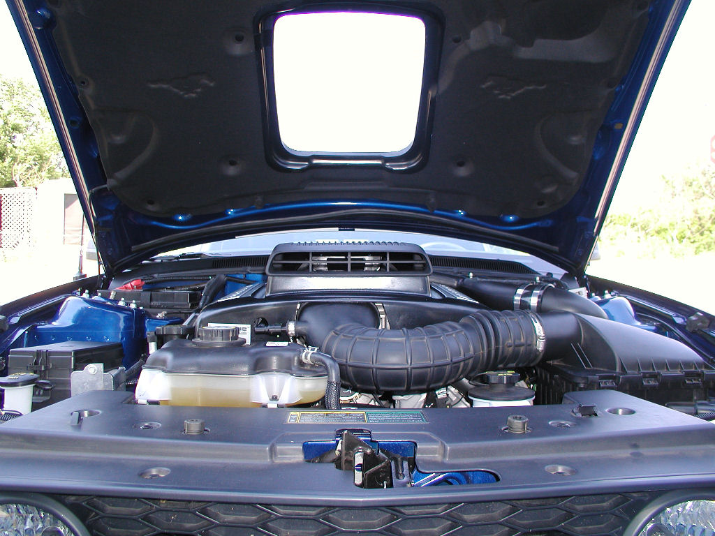

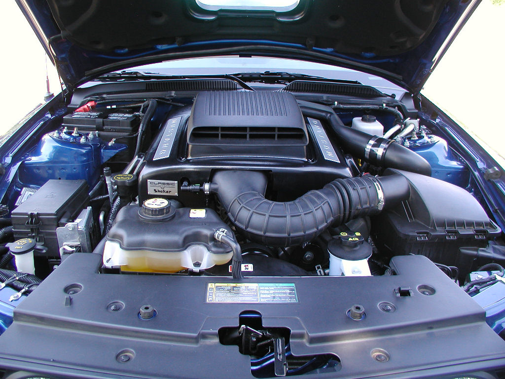

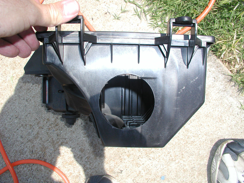

I removed the factory air box so I could cut the new hole. I taped the template onto the air box, center punched the center mark and cut a 2-7/8" hole.
I then filed this out until the tubing supplied fit.
Attachment 2044 Attachment 2043

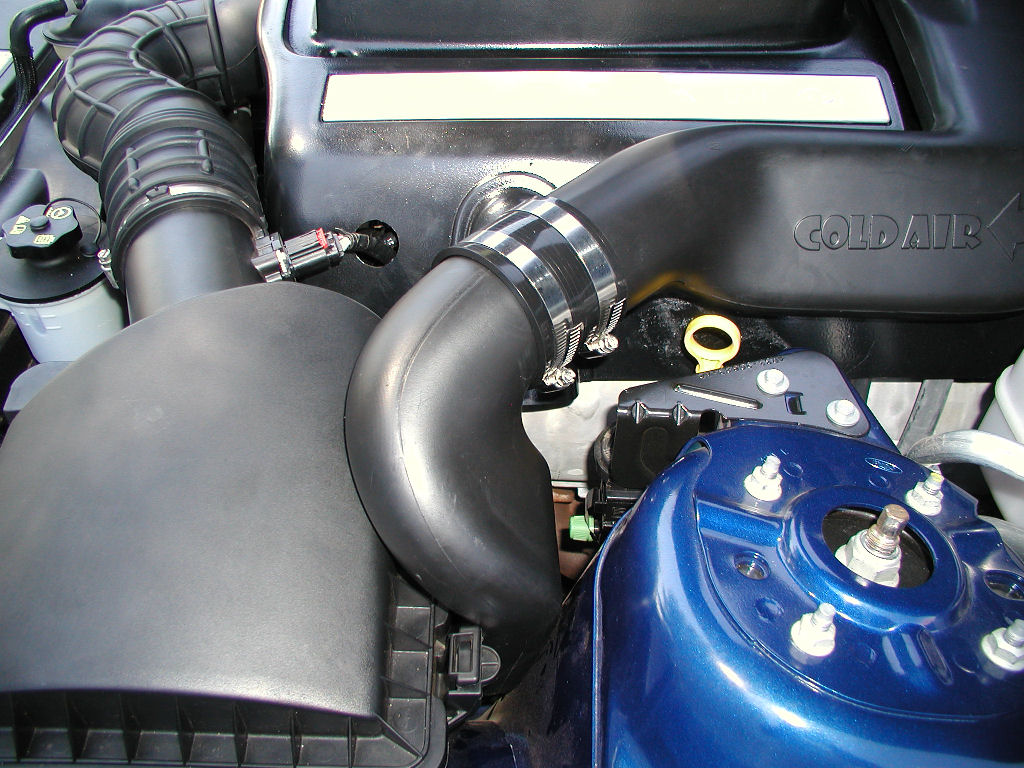

I installed the High Flow air Filter, and placed the supplied coupler onto the air box. I reinstalled the the air box, placed the other end of the coupler onto the shaker outlet tube and tightened both clamps to secure it.
Attachment 2045
I then routed the drain tubes as best I could away from moving parts and hot surfaces. (Everything is hot under that hood )

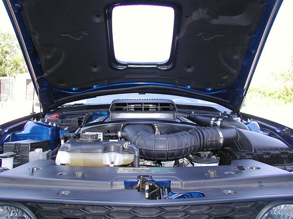

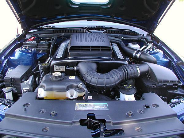

This is what it looked like when I was finished.
Attachment 2046Attachment 2047

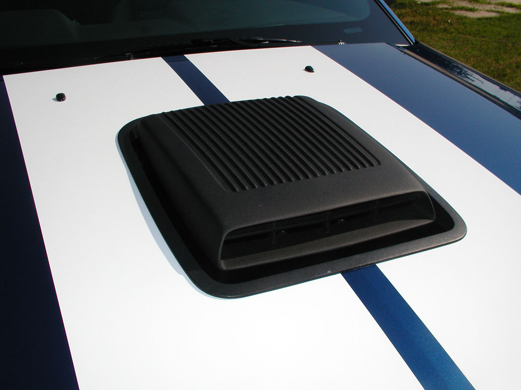

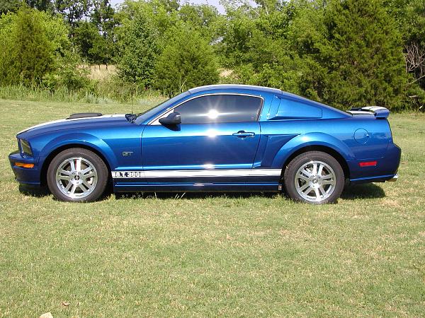

OKCMustangGT's Shaker Hood System Install Write-Up Finished

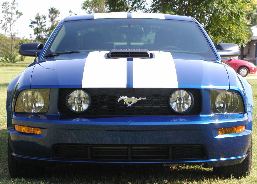

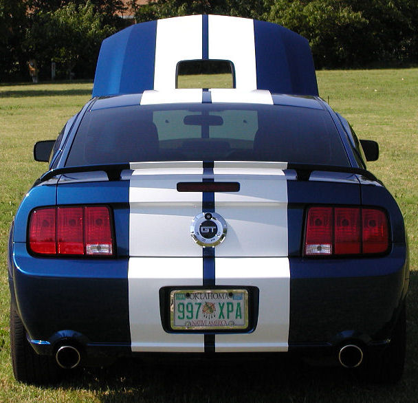

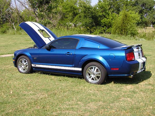

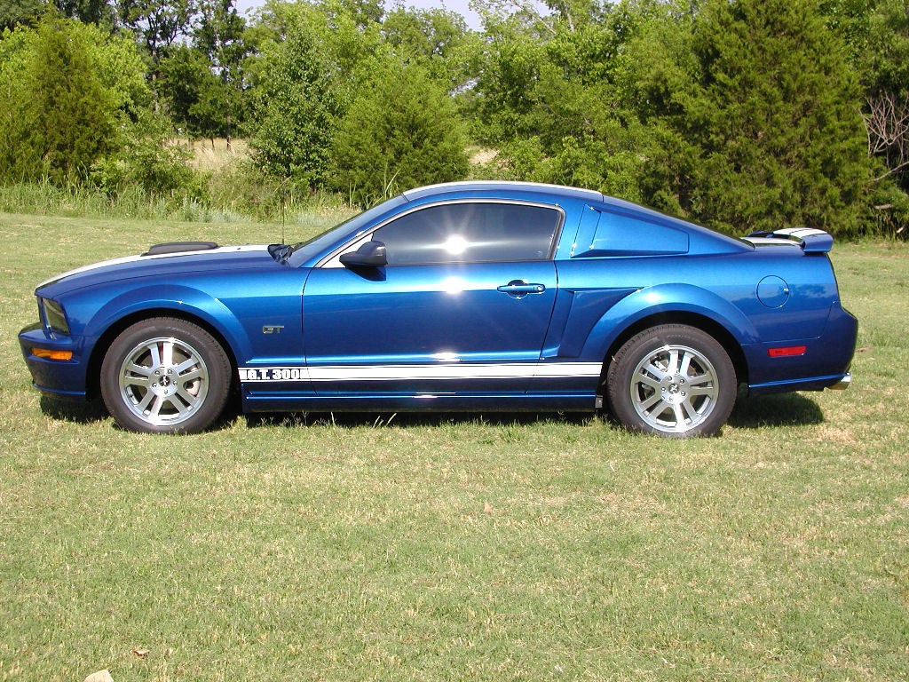

And what the car looks like now.
Attachment 2048Attachment 2049Attachment 2050Attachment 2051Attachment 2052
Attached Thumbnails Ponies on The Run!-shaker-done-front-1-web.jpg   Ponies on The Run!-shaker-done-rear-1-web.jpg   Ponies on The Run!-shaker-done-side-1-web.jpg   Ponies on The Run!-shaker-done-angle-1-web.jpg   Ponies on The Run!-shaker-done-close-up-1-web.jpg

So far I'm at the part where you put the upper trim ring down. I was going to ask if there was any play, but you answered me already. I guess 1/16" of play would fix the scoop being off 1/8" on each side since you only have to correct for half of the distance.
What did you use to outline the inner trim ring?
Did you have to bend the dipstick toward the driver's side for clearance?
One thing I saw was the hose clamps... I hate hose clamps. If you can (if you care), reinstall the hose clamps so the bolt is on the bottom and then trim the extra hose clamp. I think that will look alot better that way.
Exactly
Grease pencil
Maybe just a hair not much at all.
Might mess with that next weekend.

Looking at Daryl's front shot, I'd say as long as the center vertical rib is centered on the hood CL crease, that's the most important cosmetic detail.
The hood (hole) cut-out is secondary, but according to Daryl, can be adjusted up until it's tacked down for good.
