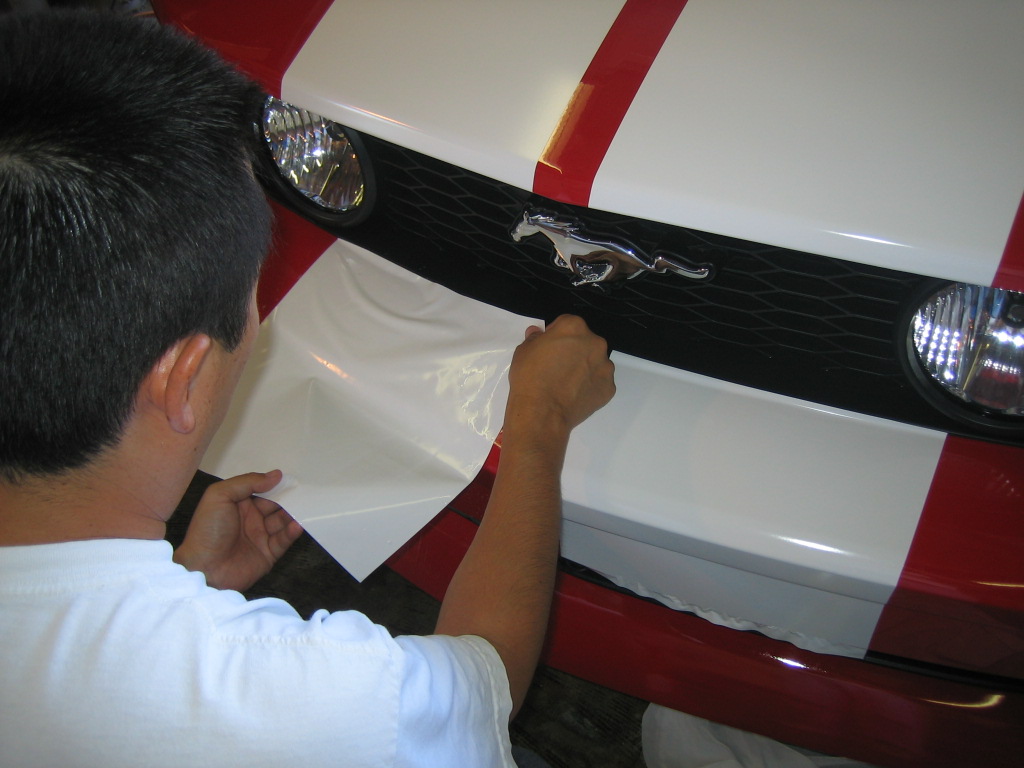

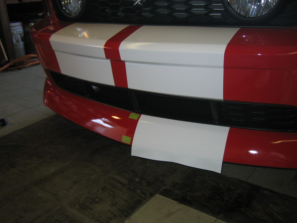

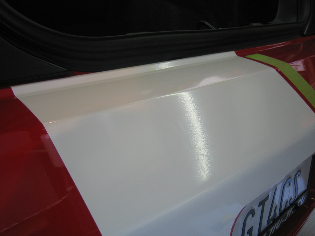

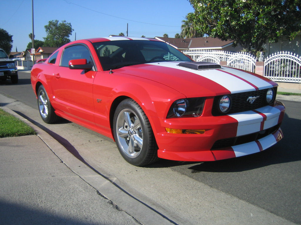

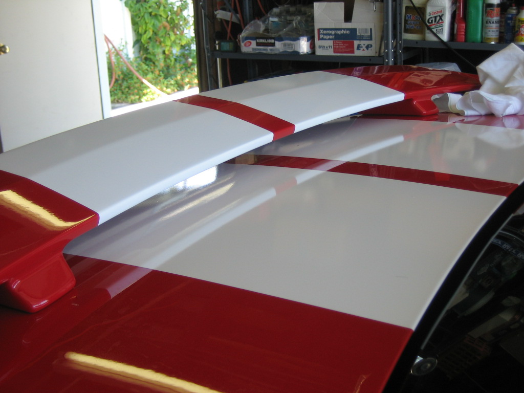

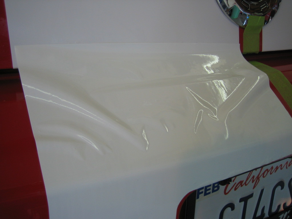

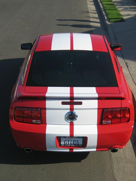

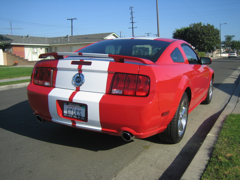

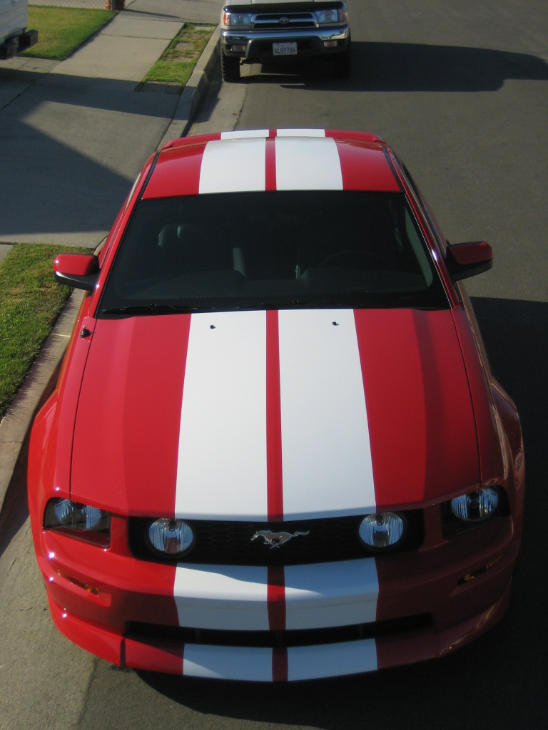

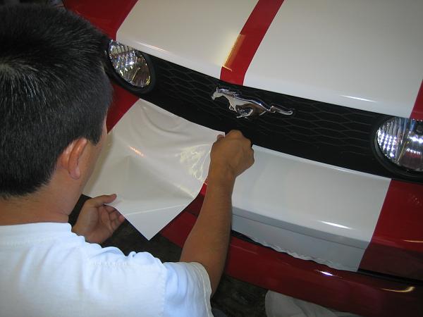

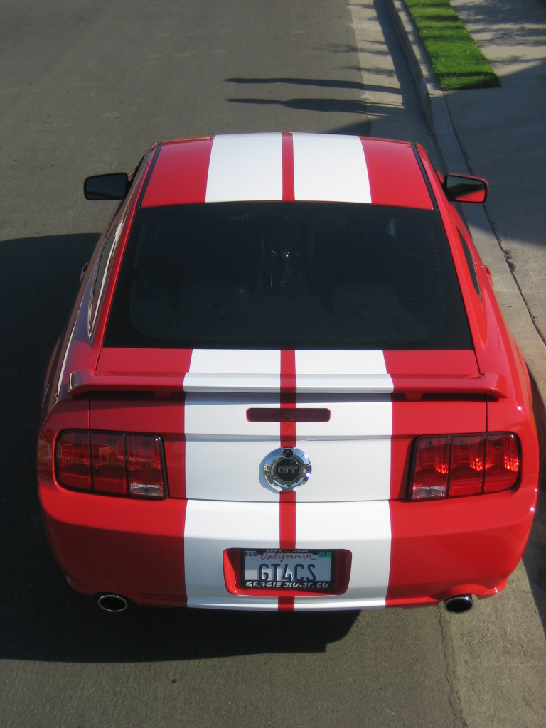

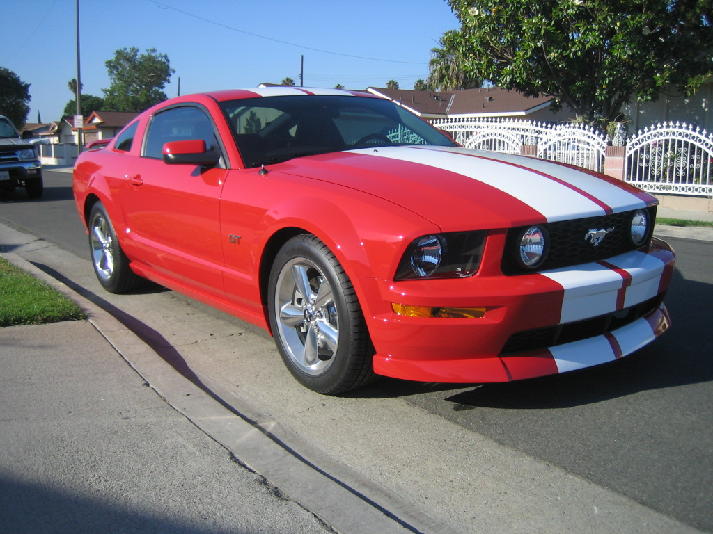

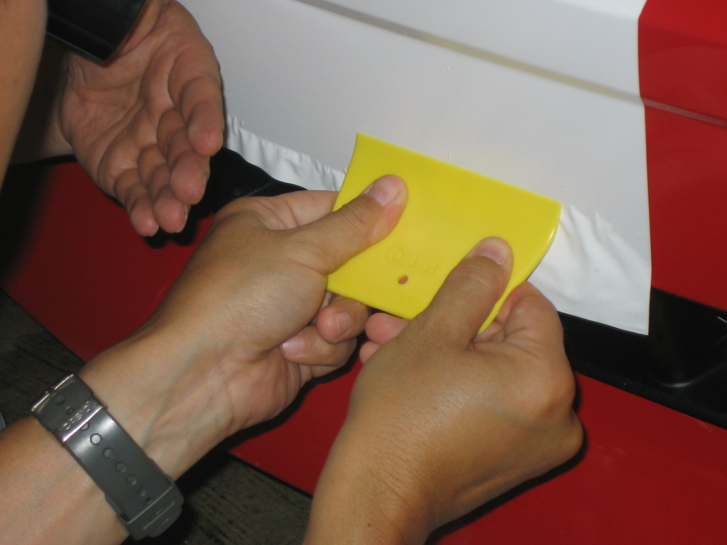

Stripes are complete!
Only had to complete the spoiler and both bumpers, but it took us several hours (incl. many well deserved breaks).
All in all, it turned out well. The only area that's 'so-so' was the gap at the front bumper nose. I did my best to hold and maintain a constant 2" gap, but it ended up an 1/8" wider at the nose. I could do no better. Can I live with this? Probably. I don't want to see any more stripes for a long time!
Rear bumber: This was a pain on the first side we did. It would start to crease everywhere as it was positioned where I wanted it to go. I started to wipe the vinyl down at area adjacent to the license plate and worked in both directions (up and down) from there. Heat (from the blow dryer) helped alot. Had to go at a snails pace; heat, wet, squeegie, hold and heat, repeat. Opposite side went smoother and quicker for some reason.
Spoiler: Easy compared to the bumbers.
Front bumper: Heat is a must, period. Process was like the rear bumper, it took what seemed like forever just to do that small length of vinyl. It could be my rookie skills, but it seemed impossible to stretch the vinyl towards the center nose to maintain the 2" gap and not crease the rest of the vinyl all to heck (remember, I'm dealing with 12" wide stripes). This whole process was slower than a snails pace, I really think a snail would've beat be down the vinyl.
The only bit of advise I can offer is slowly squeegie down any crease/bubbles and hold that position and blow dry (that newly flattened area), otherwise the air crease will 'walk' back. If a solid crease does start to form, you'll have to ever so carefully peel that crease up spraying the water solution as you go, then redo the squeegie thing.
You think reading all this is a pain, wait til you attempt this yourself.
CDC chin spoiler: Piece of cake. I used the extra 'front bumper license plate cut-out' strip of vinyl for this. I just cut a section out and used it (straight edge of vinyl to the outside, slight curved end towards the inside). Since I couldn't tuck the vinyl between the CDC and grille (double side taped), I heated the area where the 2 parts mate and used the edge of the squeegie to create a trim line. Took a razor to it for a clean trim.
Enjoy the pics.

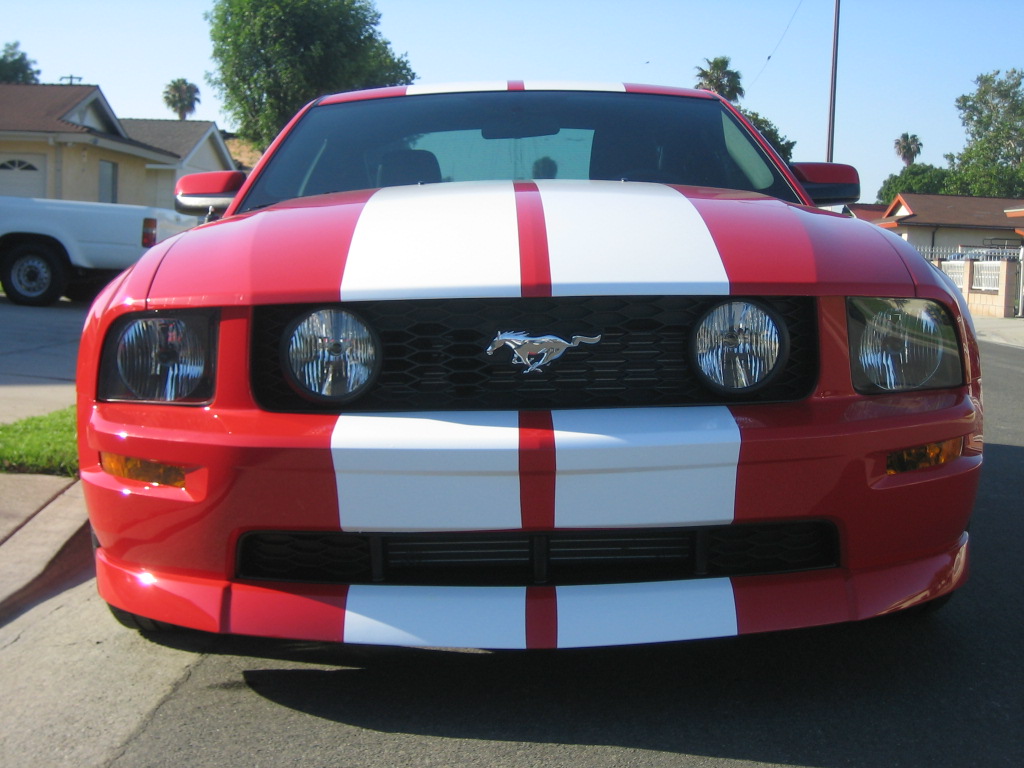

Looks great, Bill... I really can't see what your talking about as far as the 1/8" wider gap. It's probably one of those things that if you didn't point it out, nobody would notice. I guess I can see it in the overhead shot, but it just looks a little wider because it's closer in the picture. Were you standing on your neighbor's car? Cause I can see the Tacoma in the driveway.

Here's a full frontal shot; more apparent straight on.
Like you said, most people probably wouldn't notice unless scrutinizing the stripes. I have to learn to let small things go. I could ask for a replacement set, but that's no assurance that it'll look any better. For what it's worth, I had zero creases on that front bumper, couple of small bubbles, but I think they'll lay down on their own later.
I was standing on an 8' ladder, my Tacoma isn't lifted that high!

I guess I can see it, but on a 2D picture, it just looks like it's wider because it is closer. Like the roof gets narrower because it's farther away.
Still think it looks great! Awesome, even! (typing that reminded me of Snagglepuss)

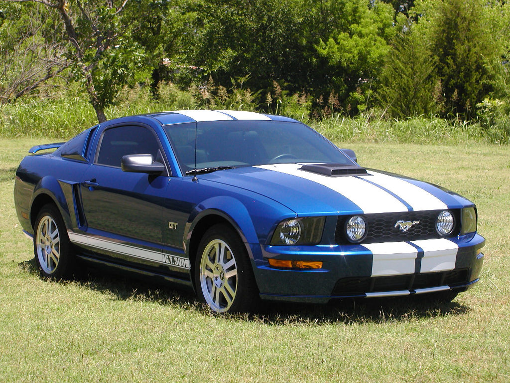

Bill the stripes look fantastic, excellent job. I need another vinyl job done I know who to call right?

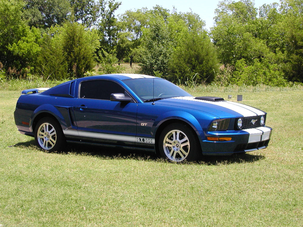

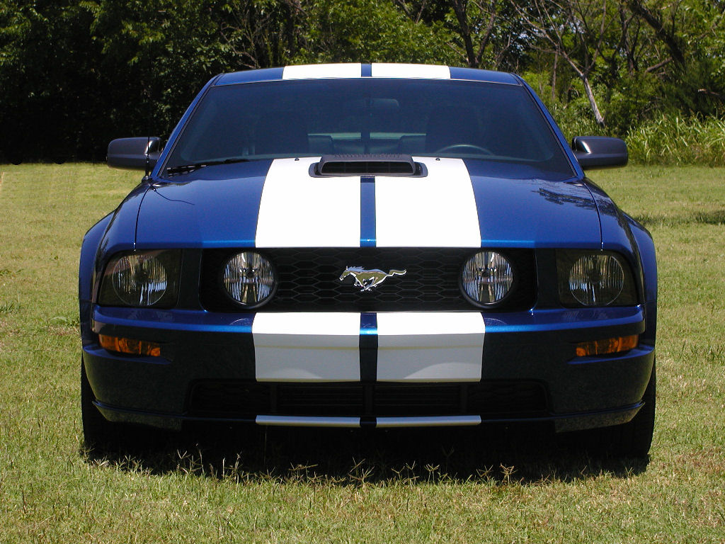

Weather changed and instead of windy and rainy today, it's hot and still. So I got my stripes finished as well. She is all done now, and Bill I have the same gap as you, 2" till the middle then 2-1/8" couldn't maintain it no matter how hard I tried.
The driver side came out with bubbles which I will pop and smooth out later.
Final Pics.
Attachment 2549Attachment 2550Attachment 2551
I got a few minutes I'll start working on a Chop for you Tom.
I already voiced my opinion on the chin spoiler, I said Black from the start. I was the odd ball if I remember correctly too.
I think your idea would look good, with rear black spoiler as well, especially with your blackout panel.

Daryl, your front bumper stripes came out great too! How did the blow dryer work? Did you use the same method I used or a different one?
And I agree, if we were working with 8" stripes, I think we could have moved it inwards at the nose a bit, but with the 12inchers... forget about it! I'm glad your's didn't hold a constant gap there in a twisted, sick sort of sense.

Used the same method as you, a little fluid, a little blow dryer, a little stretch.
My son helped me too, and that extra set of hands made things go so much faster and smoother.
