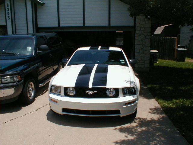

Finally , still too many daymned air bubbles tho. Any one have a freakin step-by step for those sorry front bumper things??? They been driving me NUTZ!!!
Noooo! I hope you don't have the 3 piece rear. Remember my post from a couple weeks ago? Don't get me wrong, it'll work with an upstream overlap, but a downwards step is always better.
Looks good so far. Don't stress on the bubbles too much. Leave it out in the sun (at least a week) if possible and see if they'll lay down on their own. For the ones that don't, take a pin to them.
What I've learned, don't sweat the small stuff. If you keep messing with the vinyl trying to get tiny bubbles out, chances are you're just going to make it worse!

No-no.
Thats as far as I`m going in the back. It origonally came without it going over the rear trunk , but I cut a little piece from the scratched ones , and brought it down to the end of the lid. Had to cut out the 3rd brake lite with a exacto knife. I suck doing that. Looks crappy up close , but I`m **** anyhoo. I thought i might find a 3rd brake lite bezel thats black and all will be well. It`s the front one that has me going and I dont want to start slicing and dicing. Every time it sits in the sun , more bubbles appear.
My luck......bad.
in that case, no problem. Since you're stopping at the rear decklid, you may not need to go down the front bumper; looks good the way it is now.
If you do decide to go all the way down the front bumper, you may as well finish the back off too.... just a thought.

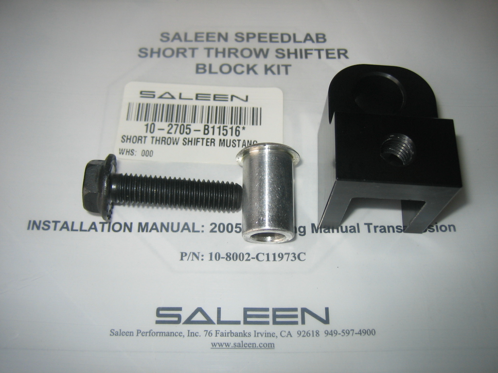

Here's a pic of what's included in the Saleen short throw kit.
Between this, the louvers, 3rd brake light overlay, and the 281 emblems, I've got a good backlog of mod jobs to do!

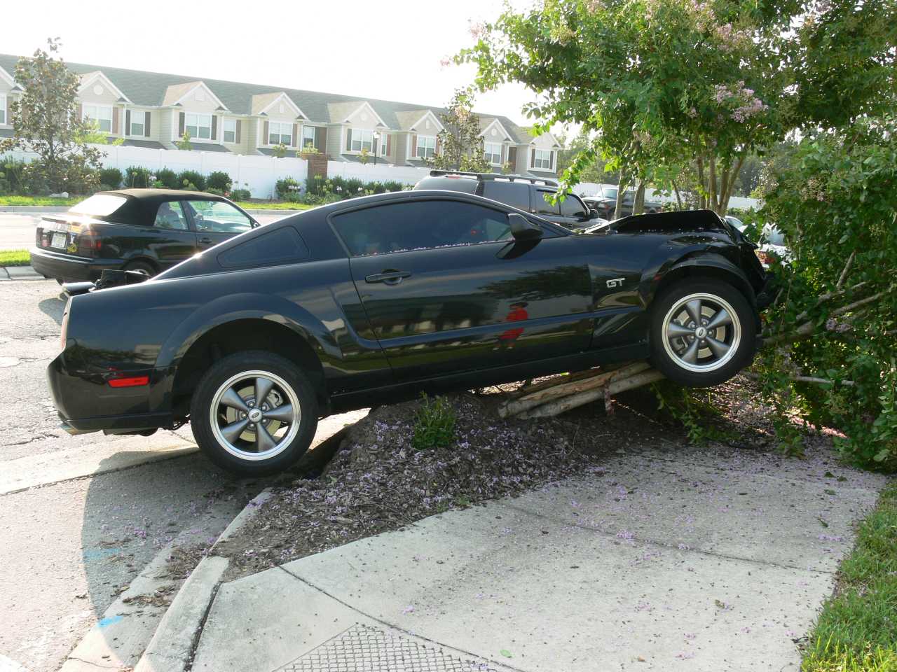

He could have given me his spoiler!
Seriously, though... that sucks. Yeah, Susan, it could be worse:

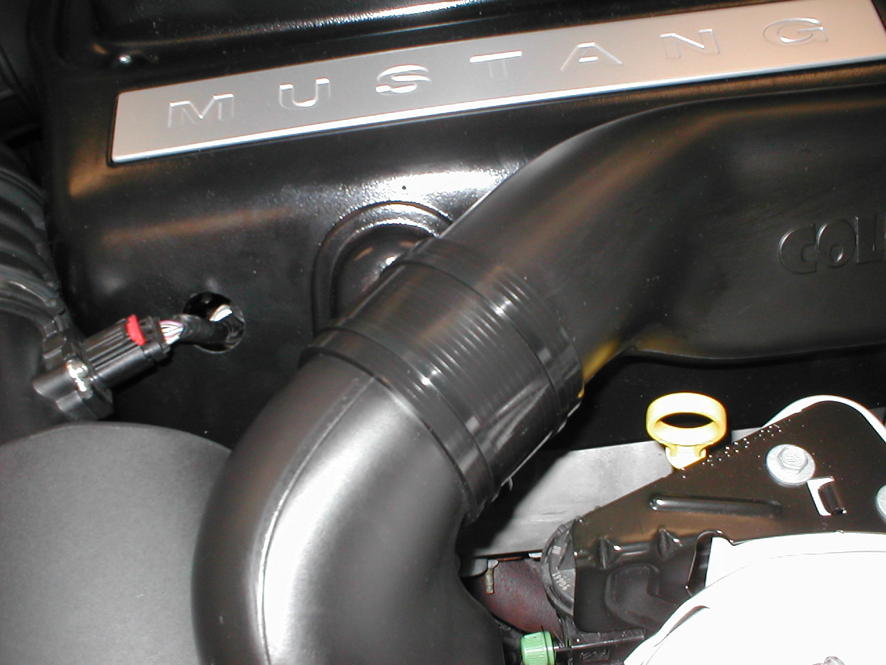

Here's a neat tip:
Instead of using the hose clamps on the coupler piece, just use black wire ties (or zip ties). I used long thin ones and they blend right in with the black coupler. The coupler is pretty tight already, so all you need is some pressure to hold it in place. I used my crappy camera just for the pic below (looks much better in person).
I used wire ties on all my radiator hoses in the '89 Mustang, so if they can hold hot water pressure, they sure will hold that coupler in place.
It really cleans up the look and gets rid of the unsightly hose clamps.

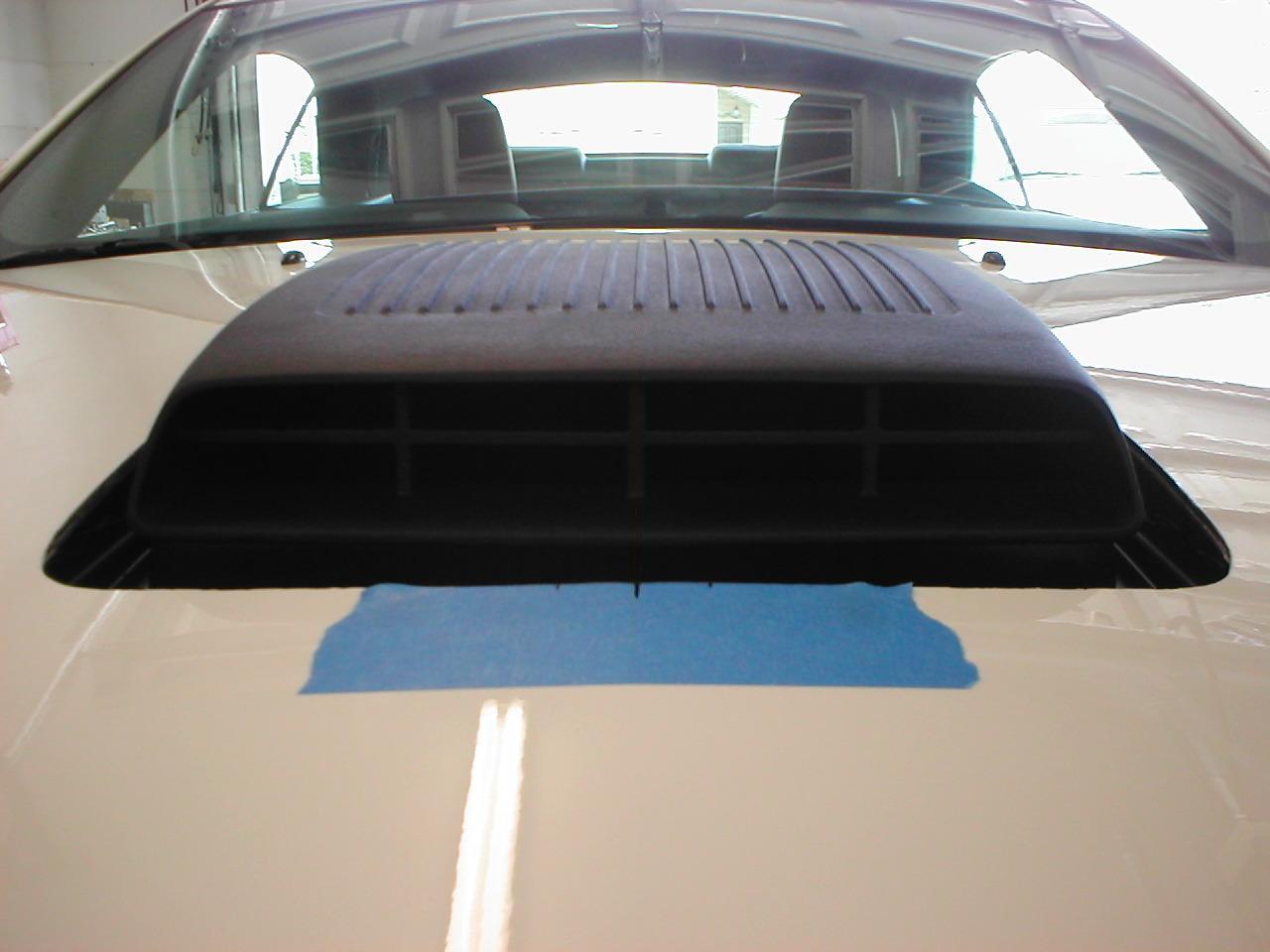

Ok, so I took one more picture with the crappy camera. I was by myself, so the little lines on the tape are 28" from each side of the hood, then I measured to the center of them to find the hood center line.
As I said earlier, this is with the scoop pushed toward the driver's side when tightening.
Daryl (where ever you are) -- there is a good amount of play in those bolts. All you have to do is loosen them and shove your scoop over to the right... and it might help center it better.
