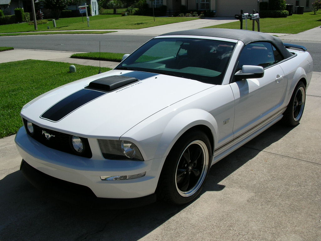

I don't really like either because a) I don't like how the pinstripe goes around the shaker scoop, and b) I don't like how it goes straight across the front of the hood. By the way, it's very hard to put vinyl in front of the hood because of the crown. The crown doesn't look like much, but it's a real pain in the ****. The guy with that yellow car had to cut a 14" slice down the center so it would lay flat (the stripe actually overlaps about 1/4" at the front of the hood in the center).
The black car has to have the stripe painted on with that type of hood.
Also, remember that you can not wax the matte black vinyl... that's why I ended up getting the gloss black.
I'm kinda partial to this one:
Attachment 8524 Attachment 8525
That's exactly how the '03 and '04 Mach 1 hood's looked:
("POWERED BY FORD" optional)

In order of preference.
Tom's Style, Yellow Car's Style then the Black Car's Style.
But I like the thinner pinstripe personally.

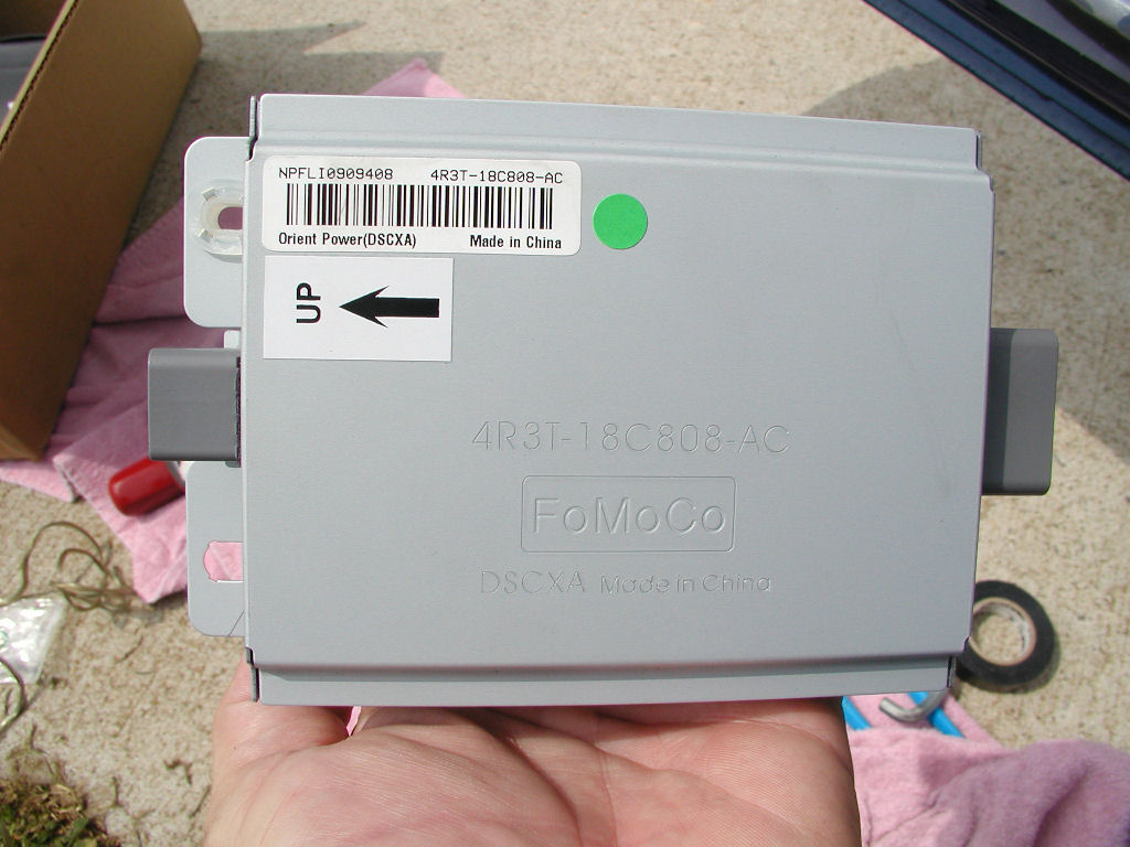

I had to actually remove one of the factory amps just to get to the hole where the wire loom to the door is.

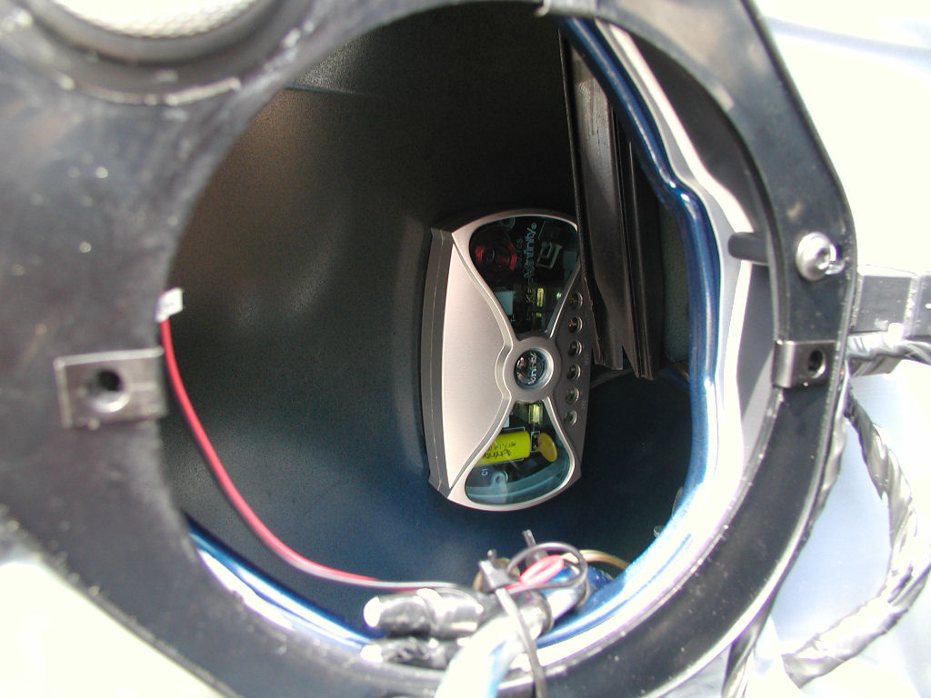

The next problem was where and how to attach the crossover so that it or the wires would not interfere with the operation of the window.
I decide the only option for attaching it was trusty 3M double sided tape. The placement is actually behind where the window falls and I routed the wires to the existing loom and around to the speakers. I tested it for any interference and there was none. I just hope it all works and I don't have to remove the crossover.

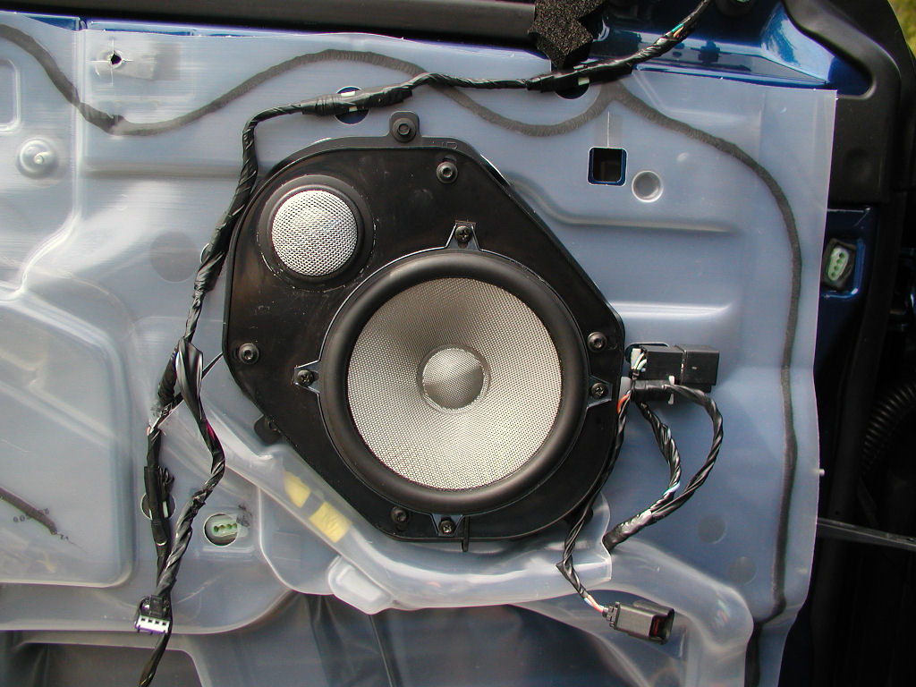

Here is the speaker template with the tweeter attached.
Attachment 8531
And after completion.
Attachment 8530

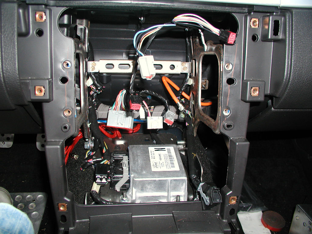

Here it is all gutted out.
Attachment 8543

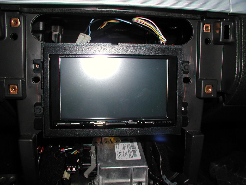

Installed Driver View - Off
Attachment 8546
Installed Driver View - On
Attachment 8547

Well I am SO CLOSE now. I may take off tomorrow just to finish it.
The Alpine HU looks great in the dash!
Was it difficult taking the dash apart to access the HU?
Old Sep 4, 2006 | 10:09 PM
  #2352
OKCMustangGT's Avatar
Joined: January 17, 2006
Posts: 2,061
From: Tornado Alley
Thanks, and NO it was VERY easy.
Take 2 screws out of the back of the console (under the arm rest), Take the shifter trim ring off, I unscrewed the shifter **** too, then just pull up.
The center stack side pieces just pull off too. (6) Screws hold the control panel in. Remove those and then pull forward, release all the harnesses and bam you are to the HU. 4 screws hold it in.
It was really easy and accessible. There is a good amount of room behind the HU too.
