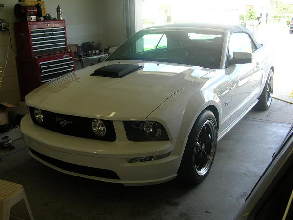

Well, the hard part is done! Here are some pics:
Hood taped off and CL found. We made reference points down the sides of the hood and measured across to find the CL:
Template taped into place (I had to re-draw the cut-out... it was very light and hard to see):
Me cutting (I need a haircut):
Taping the "hole" as I cut (probably overkill, but it didn't vibrate at all):
My dad cleaning up the edges (I let him do something):
Finished with the hole (ring just laying in place):

I layed the scoop in place (or at least very close) and the center line (between the fenderwell edges) fell right on the center rib of the scoop. So, that's all I did before cutting the hole.
There is some left to right slop in the trim ring. It might allow for about 1/8" of movement. Meaning, 1/16" either way from center.
Not going to do much more today... going over to some friends' house for dinner.
OK... here it is just laying in there (no ball or socket, no throttle body bolts):
Attachment 2322
Yeap, exactly what I had as well.
Ball Socket Pics ? Yes I am being impatient and nagging, sorry.

I will take them now... see my last post for a teaser pic.

There are some pics here, Daryl, of the ball. I can get better ones tomorrow when the camera doesn't insist on using the flash.
Also, Daryl, does the rear of the inner trim ring lay on or touch the flat air tube behind the shaker when the hood is closed?
Another thing... there is ALOT of slop forward and backward on the outer trim ring.
No need those worked fine.
I'll have to check. Trim ring has felt on it like it does.
Don't remember front to back slop, just side to side.
I saw the felt, too. Wouldn't it rub when it SHAKES?
