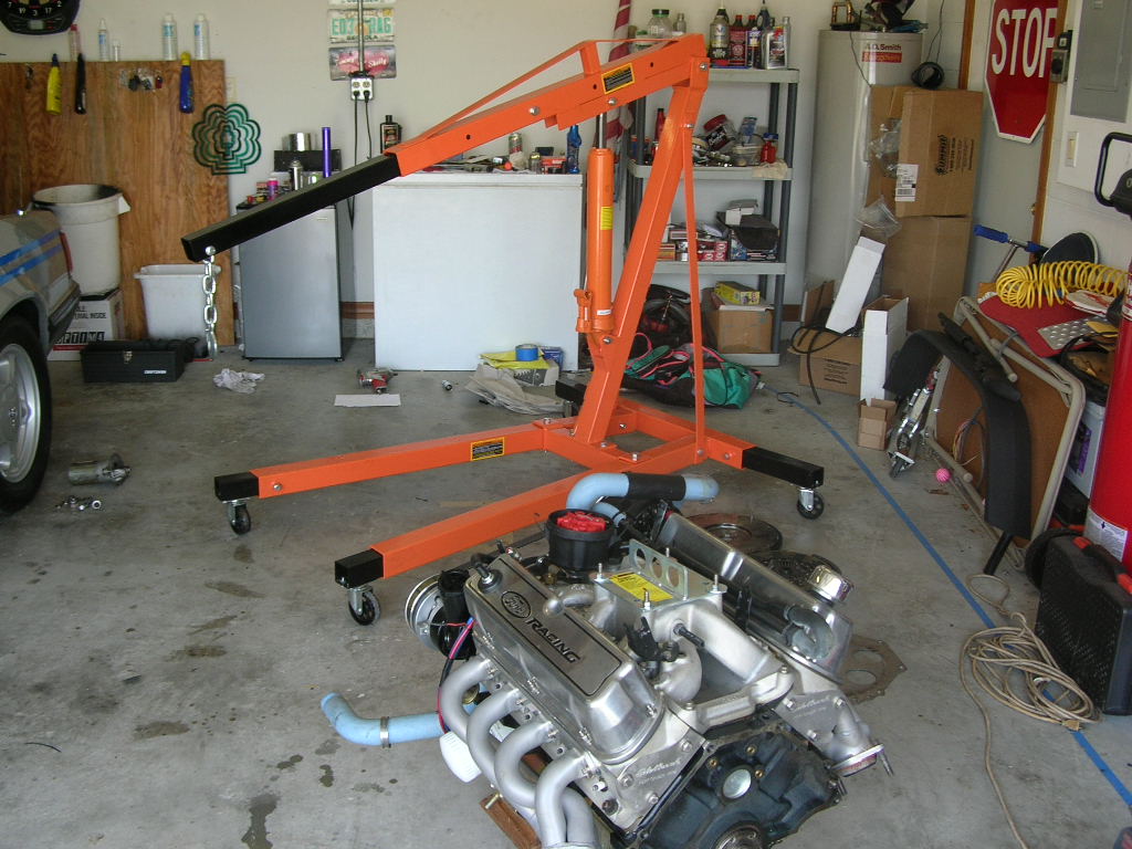

Here's what I've been doing today. I backed the car into the garage at 9:30am, and here's how it looked at 11:30am:
Attachment 25933
I broke down and bought that hoist. Only $149 for a 2 ton.

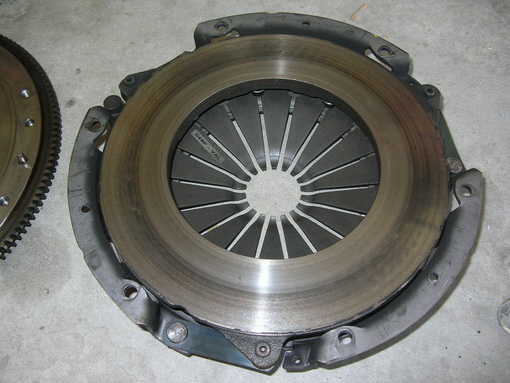

The clutch definitely was slipping, with no signs of oil:
Attachment 25934
I was afraid oil or transmission fluid was getting to the clutch somehow making it slip, but it was just pure power.
Which makes much more sense now. The dyno hit about 358 Torque at the flywheel on the first set of dyno runs... and 351 Torque at the flywheel on the second dyno run. 350 was the max torque for that ZOOM clutch kit. When it hits it limit, something is going to give - in this case, the clutch. The clutch I'm ordering is good to 520 ft-lbs of torque at the flywheel. The transmission will fall apart before then!
Attachment 25933
Attachment 25934
it sounds like you're getting into the area where you might start chasing the drivetrain's weak link. After enough power there is always one somewhere. How are the u-joints & driveshaft ?? It's a bummer when you start busting those with frequency.
