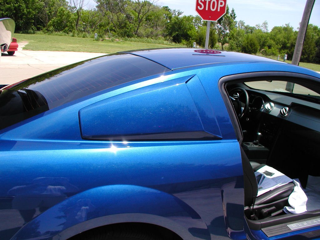

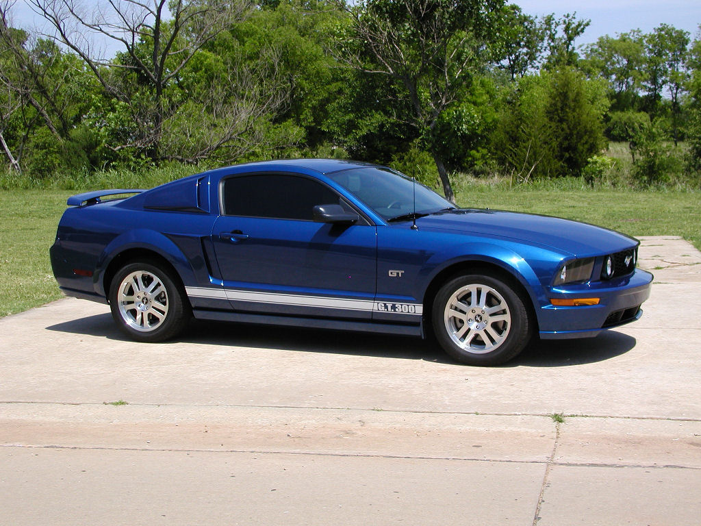

Scoops are on. I have to go pick up the little man from school. Here is a teaser pic.
I hope that isn't the tape kit that came with the scoops! (j/k)
Loos great! More pics, please.

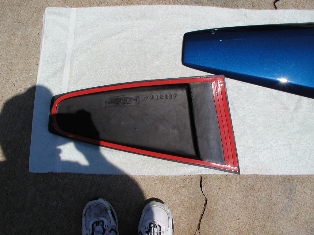

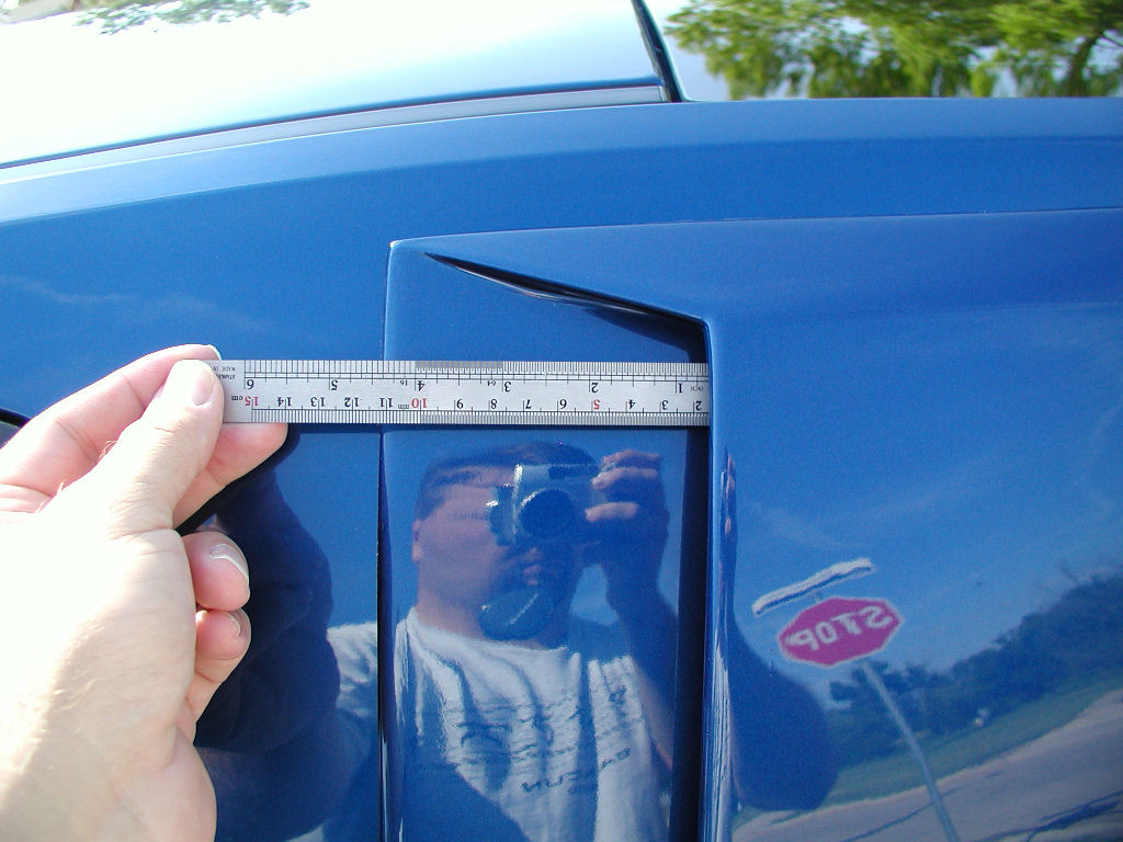

First off I will say this, I love the look, and the color is about as perfect as you can get.
I prepped the areas where the scoops were going with 91% alcohol from Tom's favorite store, Wal-Mart. I wiped it down thoroughly and let it dry. I could run my finger across the surface and tell where the alcohol had been rubbed as my finger would stick and not slide smoothly across the surface.
I decided to do the window scoops first. Here is the scoop with the 3M tape applied to it.
Attachment 871
The instructions call for a 2-7/8" gap between the door edge and the beginning of the window scoop. I took my 6" stainless rule and placed a strip of masking tape across the length of the back so it wouldn't scratch the paint. Measured 2-7/8" and placed two strips of masking tape to mark the scoops leading edge placement. I then measured 1" down from the top ledge where the side of the car meets the roofline, and placed pieces of masking tape to hold the scoop in place.
Attachment 870

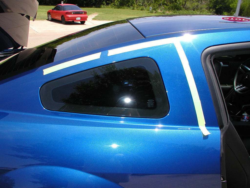

Once in place I outlined the leading edge and top edge of the scoop with masking tape.
Attachment 872

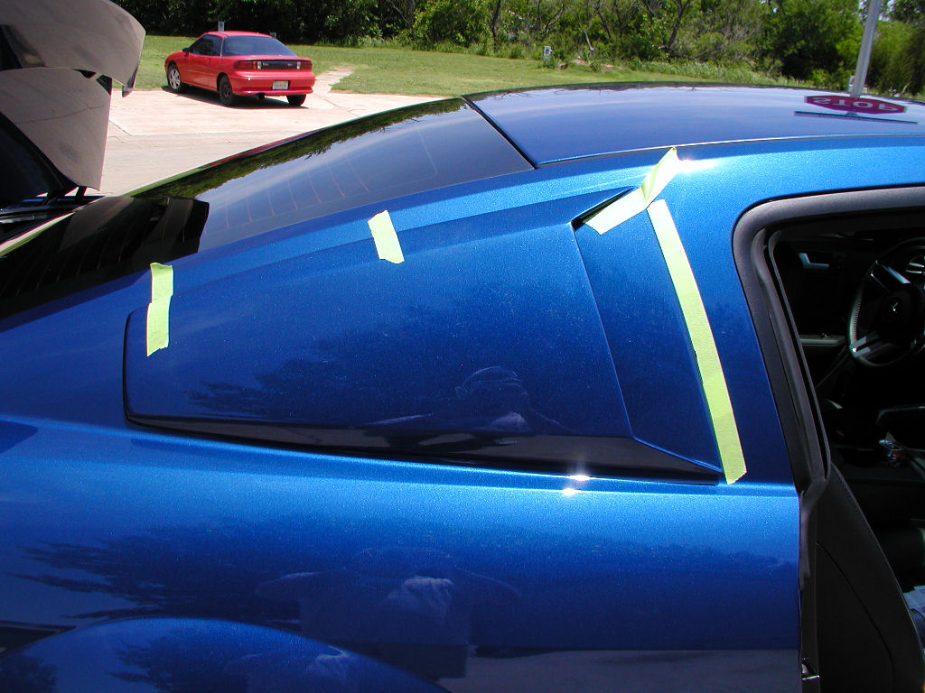

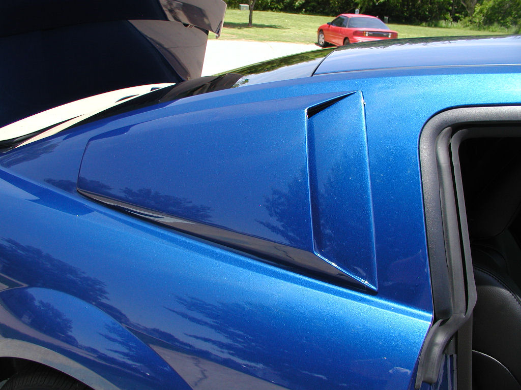

Then I peeled the backing tape off the three pieces of 3M tape on the leading edge and about 4" back on the top and bottom strips, leaving the excess backing strip hang out so I could grab it later.
I placed the leading edge against my masking tape marks, while aligning the top with those masking tape marks. I applied soft pressure to tack the leading edge down and then removed the rest of the backing strip. Applying light pressure I worked from front to back pressing the scoop against the car until it was seated. It came out looking like this.
Attachment 873Attachment 874
Side door scoop coming up in my next post.

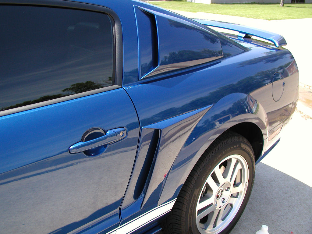

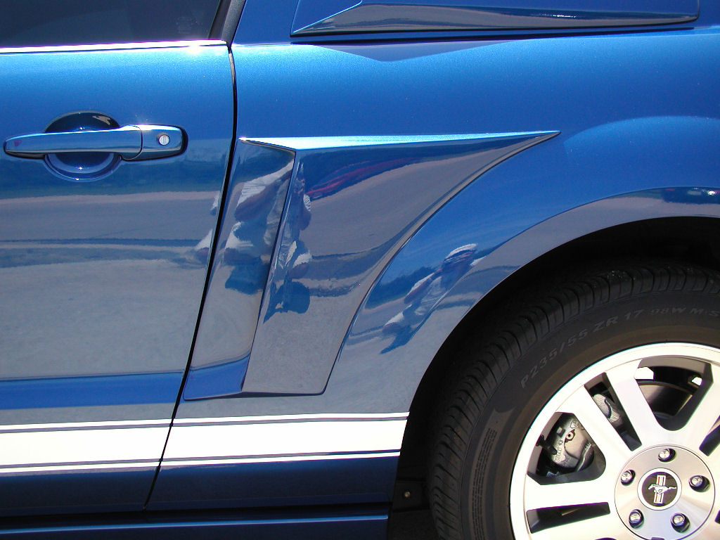

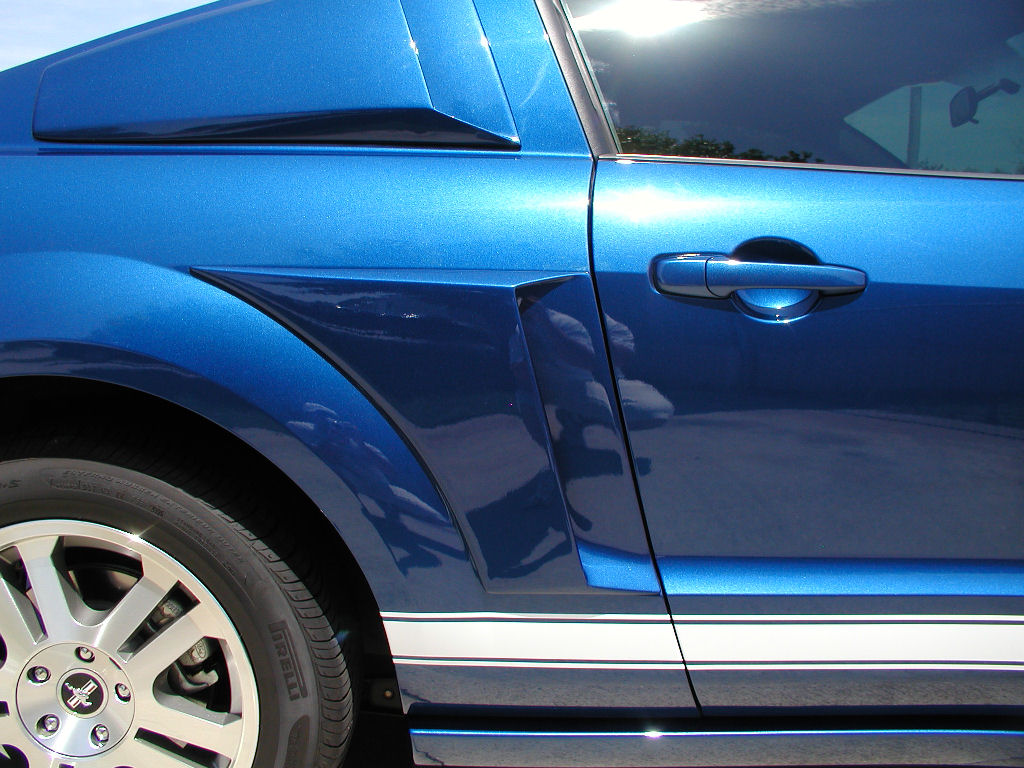

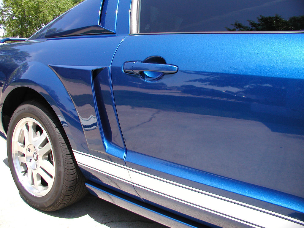

I began the door scoop install immediately after the windows scoops expecting this one to be harder for some reason. I tried to align it using masking tape to mark the placement like I did for the window scoops using masking tape. After about 5 minutes of that I realized it was pointless to do so. The car has a perfect ridge with which to align the scoop and the hockey stick indentation.
So I grabbed the scoop removed the backing strips from the three double sided tape strips along the leading edge and about 4" back on the top and bottom strips. I left them hangin out just like the window scoops.
I then aligned the leading edge with the door jamb and the top of the scoop with the ridges of the car. I pressed lightly and worked from front to back removing the remaining backing strips as I went.
They turned out like this.
Attachment 875Attachment 876Attachment 877Attachment 878

Daryl- Xenon scoops look excellent!
Can you take a pic from further back (whole car in pic), would like to see the overall effect of the scoops.
Also, what's inside of the scoop openings? I know they're blocked off, but how far back? Color?
Install question: You didn't make mention of prepping the paint surface. How did you defeat your 3 coats of Zaino?

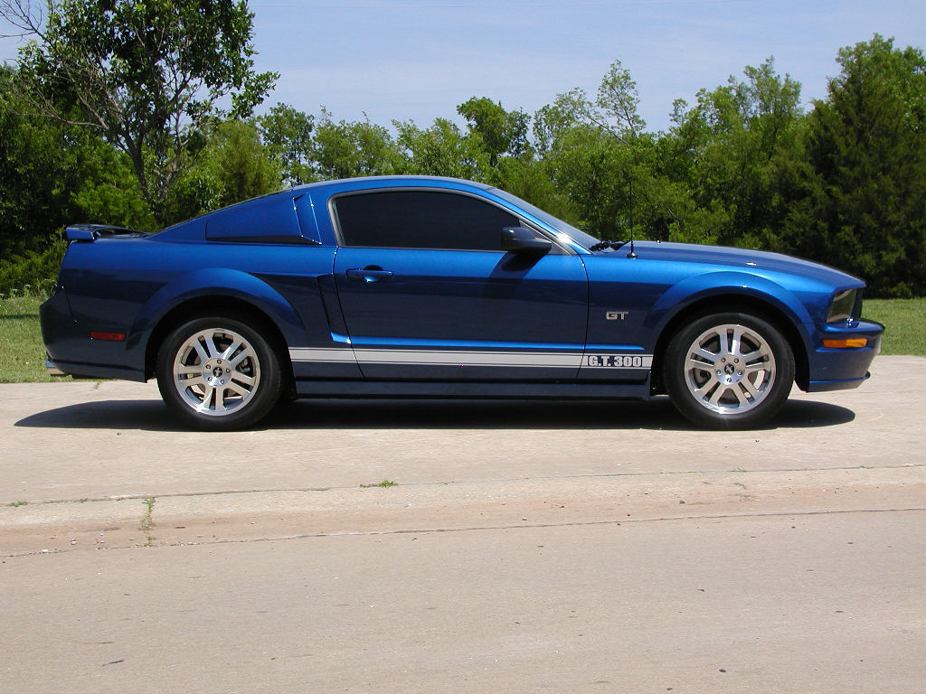

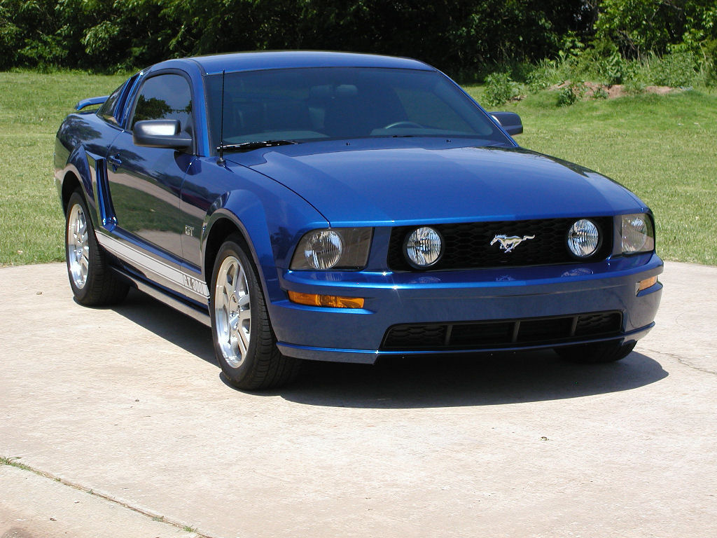

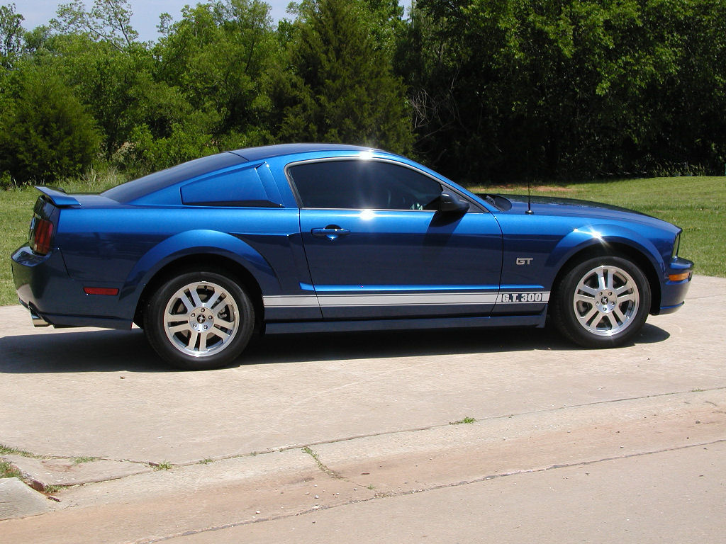

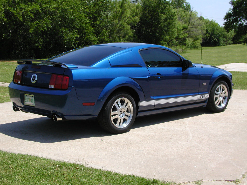

Now the post we all have been waiting for (Well maybe not all of us and maybe you weren't waiting but)
The completed project.
Attachment 879Attachment 880Attachment 881Attachment 882Attachment 883
Ill go get a close up slot shot for you Bill. Might even take a shot of the scoop holes too

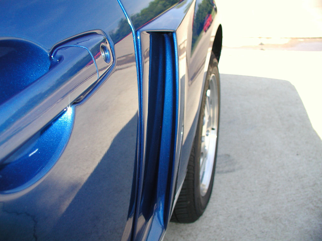

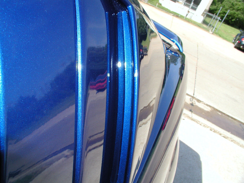

OK Bill Here you go, the slots in the scoops.
The inside color = Vista Blue
Attachment 885Attachment 886

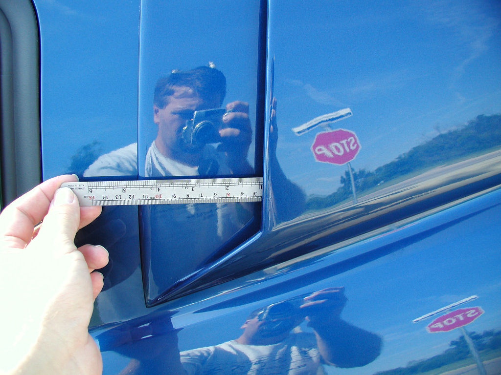

Depth of the slots
TOP
Attachment 887
BOTTOM
Attachment 888

Looks great! I don't think I would like the window scoops on my car, though.
Ya know what, Daryl?
THAT CAR NEEDS TO BE LOWERED!!
I don't see that mod on your future list. (Wait to you see my lowered pics!)

Thanks for the dimensions. I do like that they're painted the same color on the inside of the scoop area.
Man, you've got me thinking about those now.
