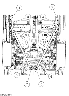

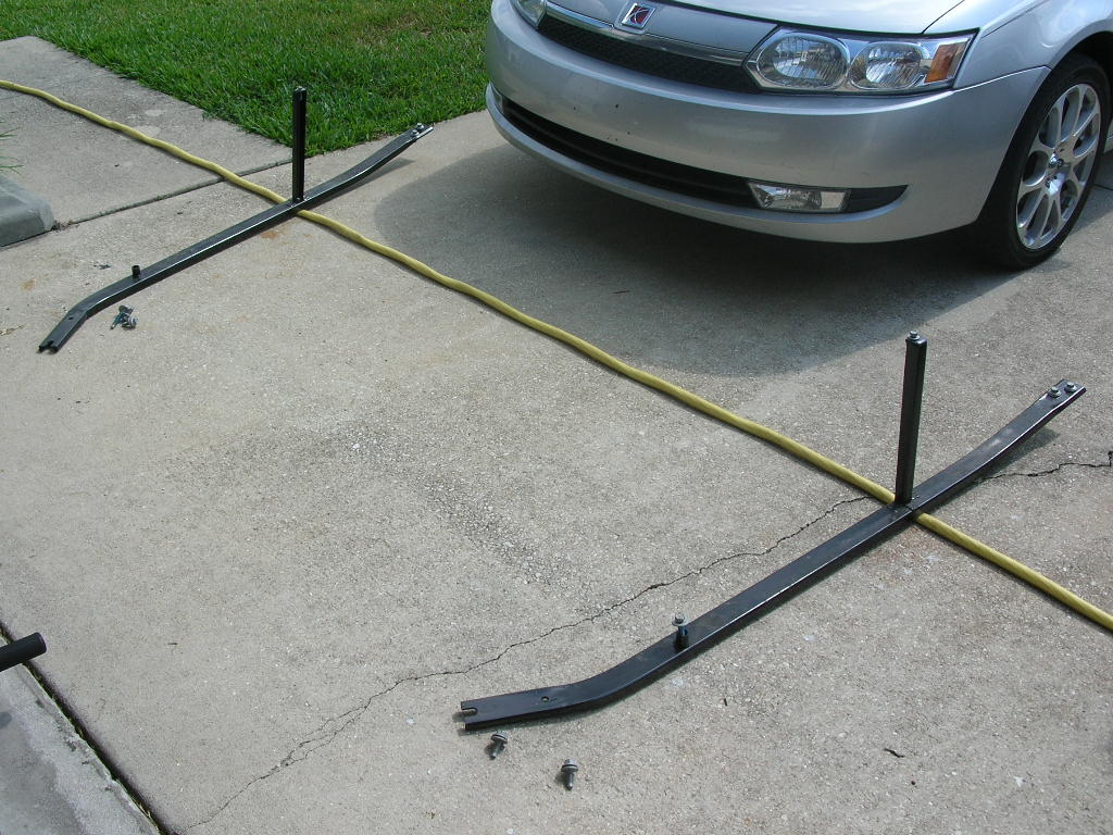

I don't recall seeing that I had to remove these is your write-up, Bill:
Attachment 638
The axle wouldn't lower enough with these Vert-Only Specials in the way.
So much for the rear being easier.
Attachment 638
BTW, did you get the feeling that the car was folding in half when you lowered the rear axle and supported the frame on the jackstands? They are so far forward.
I don't have those funny looking bars.

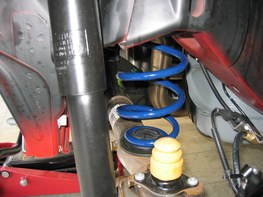

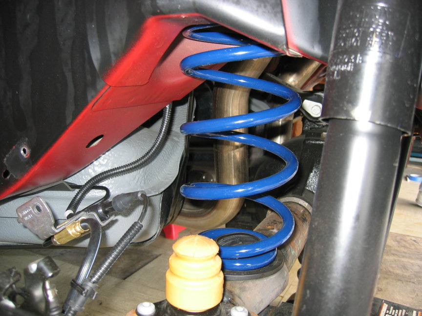

I took the pads off before checking to clean them (wasn't thinking about pigtails then). The passenger side pad was folded under itself, so I fixed that.
Pre-'05 manuals tell you to face the pigtails a certain way.
The '06 service manual says the labels on the stock springs should be toward the rear. This makes the pigtails face toward the front.
So, dumb or not, I re-lowered the rear axle and rotated the springs that way (the vert braces were still off, so it was easy).

Here's 2 pics of the way mine are. Can't really see the actual ends, but you can imagine pretty much where it is.
Attached Thumbnails Ponies on The Run!-drivers-side.jpg   Ponies on The Run!-passengers-side.jpg

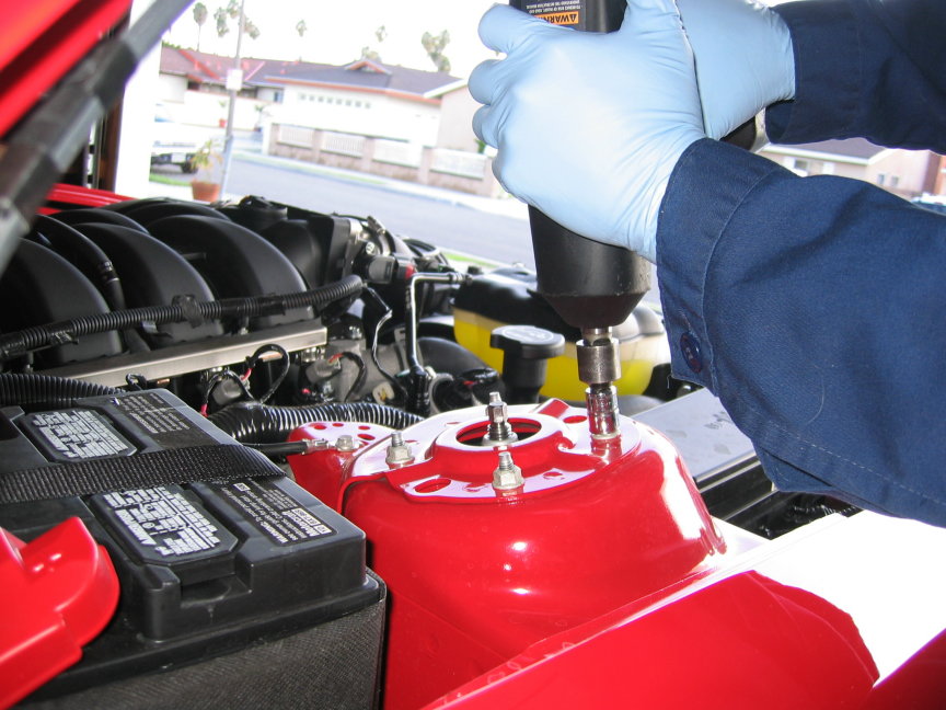

I'm slooooow and picky. I had to mess around with those braces, too:
Attachment 651
I'm glad I found that tightening order.
Plus, I'm playing around with camber (seeing how much of a difference it makes on how you install the top 4 nuts).
Bill -- Did you just tighten those nuts down? center the middle stud? try to hit the same marks as from the factory? something else?
Old May 18, 2006 | 02:52 PM
  #640
Attachment 651
Torque pattern for those bars? Well, if you have the sheet, use it.
Yes, I just tightened down the nuts, typical torque pattern.
Positioned the studs/nuts in the exact factory position.
