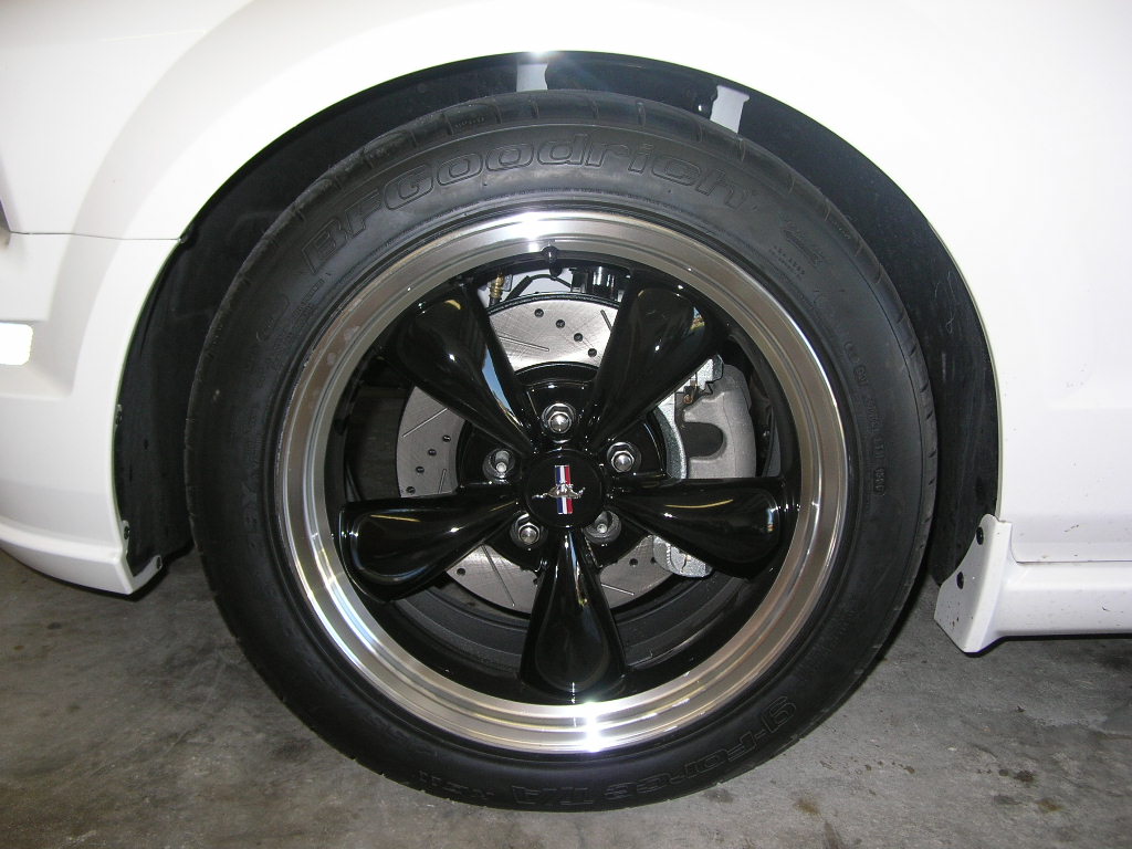

They just came in and I threw one on:
Attachment 598
A little less area there between the tire and fender, too.

Old May 17, 2006 | 01:35 PM
  #610
Lookin' good!
