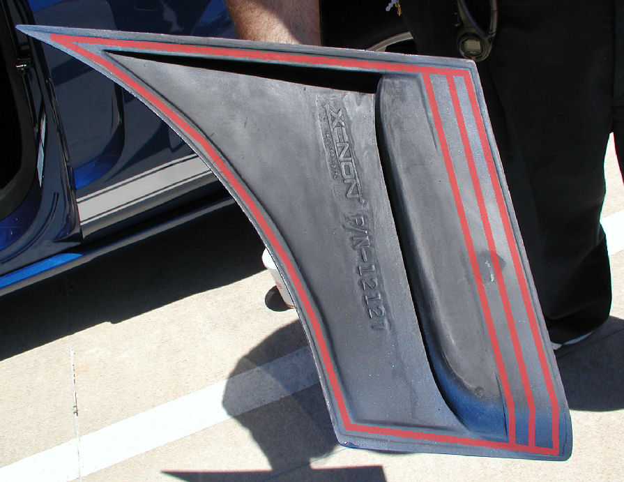

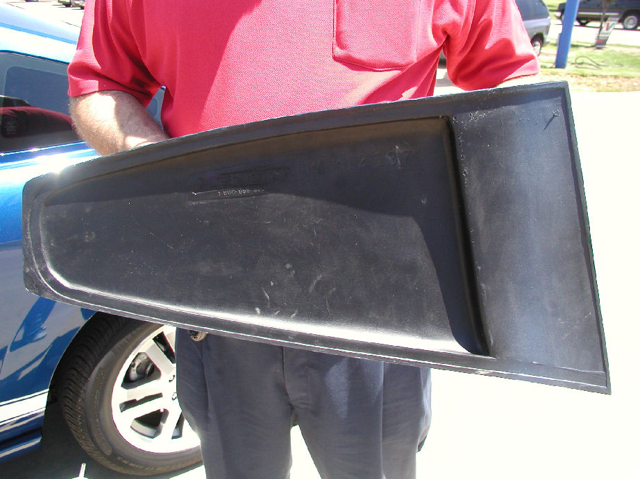

On that topic, what made you pull the trigger and get the Xenon scoops over the others (Cervini, Razzi, 3D Carbon, etc.)?
Well to be honest, originally I wanted the Cervinis Window Scoops, but after seeing them on several other members cars, they just looked TOO big.
I didn't like the 3D carbon soley because the opening is cut straight with no taper.
Attachment 654
I like the shape of the Razzi, but they are only as big as the window and would be my 2nd choice.
I got the door scoops from Xenon because IMO they are the only ones that flow with the shape of the car. The others look TOO tape-on. The Xenon wrap over the wheel well a little and make it look more like it was supposed to be there.

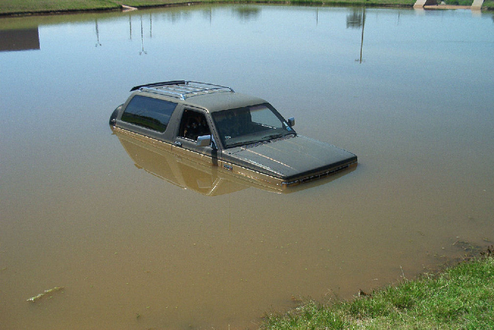

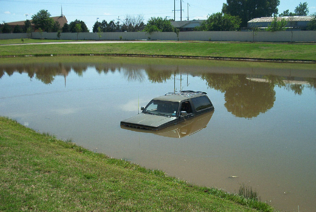

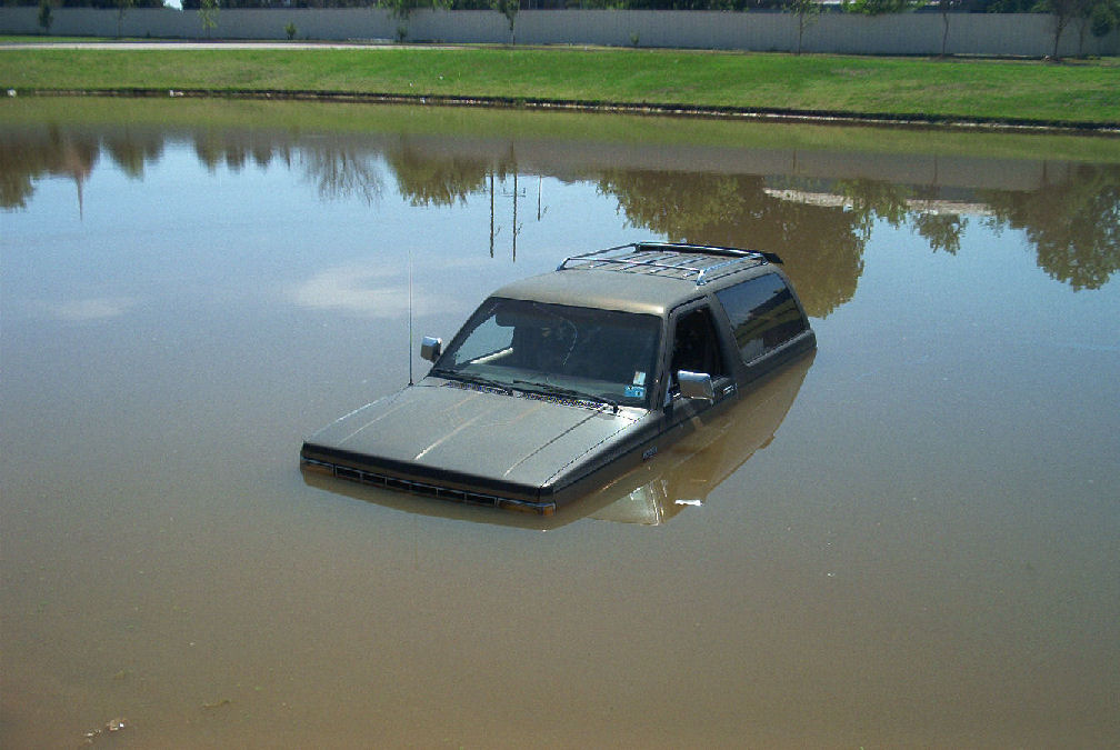

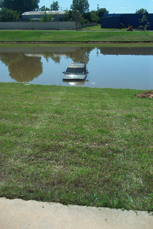

Why you always make sure your parking brake is set.
This happened at work today. No one knows why.
This was an old Blazer of the owner's that no one has driven in quite awhile, it was just stored here.
Attachment 656Attachment 655Attachment 657Attachment 658
On the 3D pic, the red arrow is pointing at the straight cut ledge? Also looks like the leading edge isn't taped town that good either.
Man, I keep going back and forth on these scoops. First it was 'all systems go!', then it went to the back burner, now its back to the front.

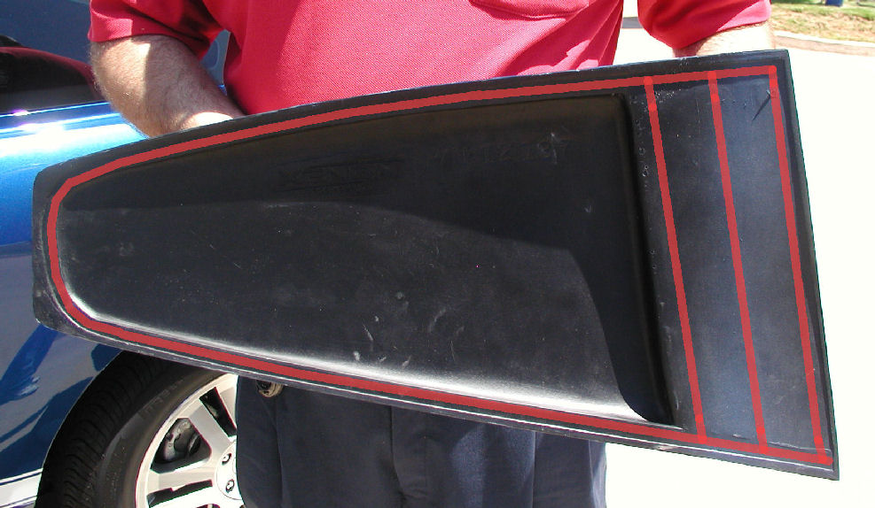

The circled areas are what I am referring too.
Attachment 659
See how there is no variation on the 3D and there is a 2-3" variation on the Xenon ? That is what I liked about them.

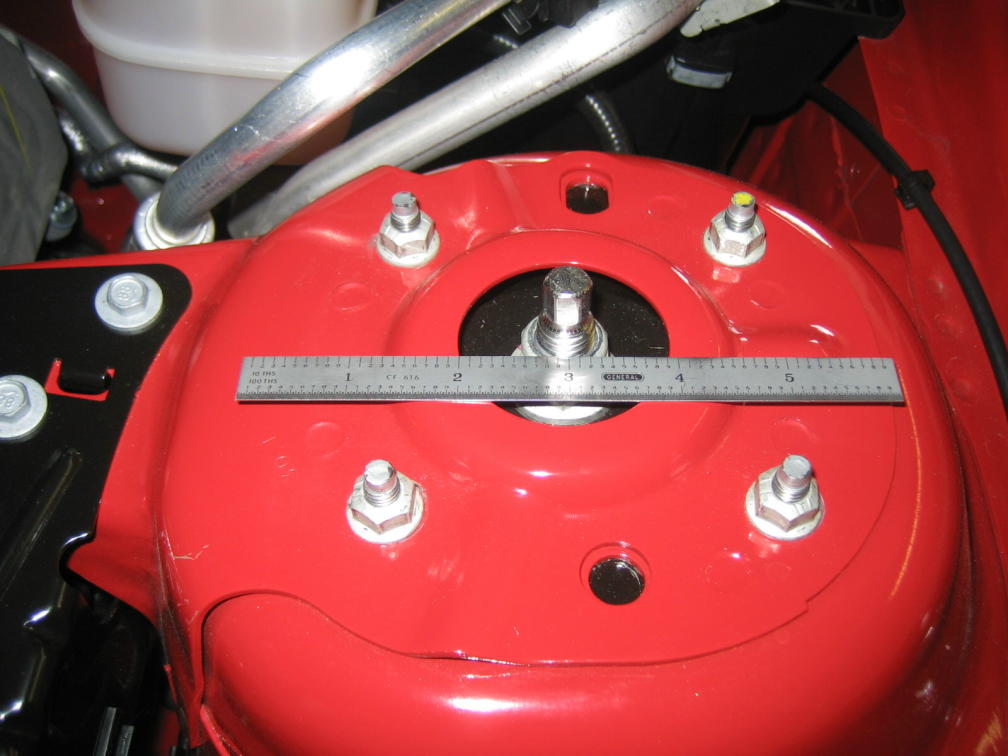

I pulled the strut assembly over toward the fenderwell when I tightened those 4 nuts. The holes are quite a bit bigger then the studs, so the studs are pulled against the side closest to the fenderwell.
Now the center stud is 6mm closer to one side of the hole than the other (it used to be centered in the hole or close to it).
Tom- Take a pic of the top studs. Can't get a visual on which direction it's up against. In airplane talk, we always refer to directions as up, down, inboard, and outboard.

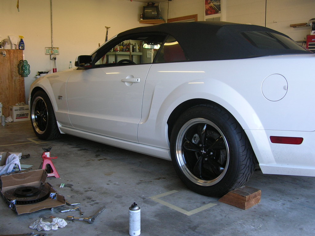

Here is a quick shot in the garage. I only backed it out and back in to un-**** the front wheels.
Attachment 666
I still have one rotor to install (as can be seen on the floor).
I'm close to my marks on the floor, and without any settling of the springs at all the front dropped about 5/8", and the rears exactly 1". I'm sure they will drop more in the next week, so I'll post my before and after measurements then (and pics).
Camber is almost exactly like it was stock! I'll check it again after it lowers more, but it's at about -1 degree right now.

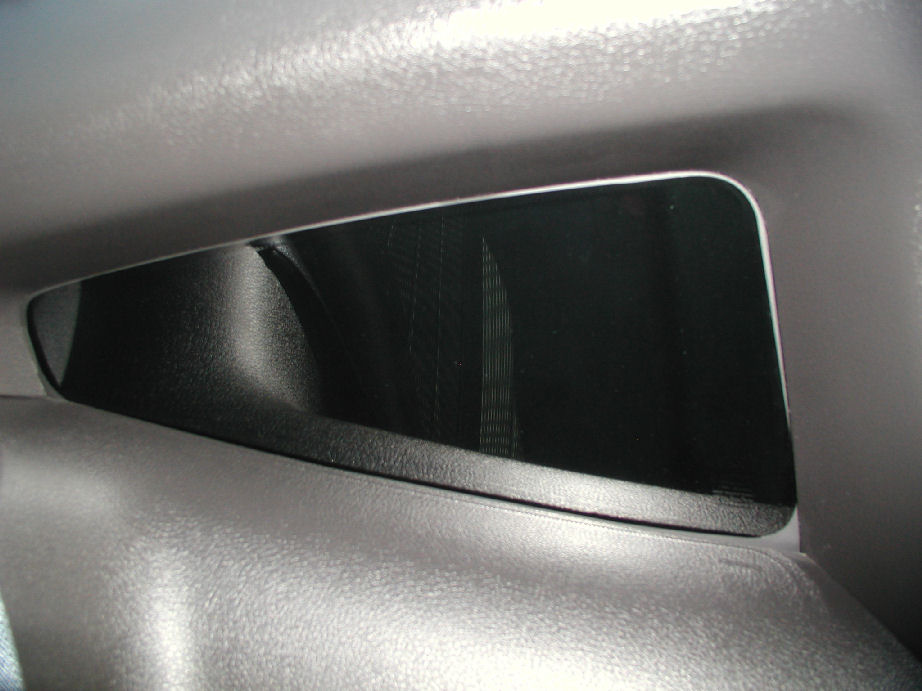

OK Bill these pictures are for you.
The window from the inside
Attachment 669
Anything you see is only reflection of my interior, you can't see any scoop period.

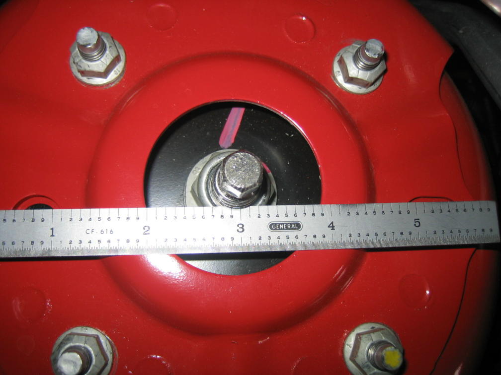

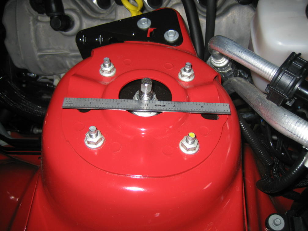

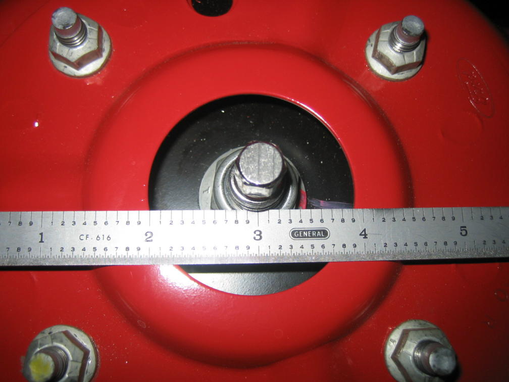

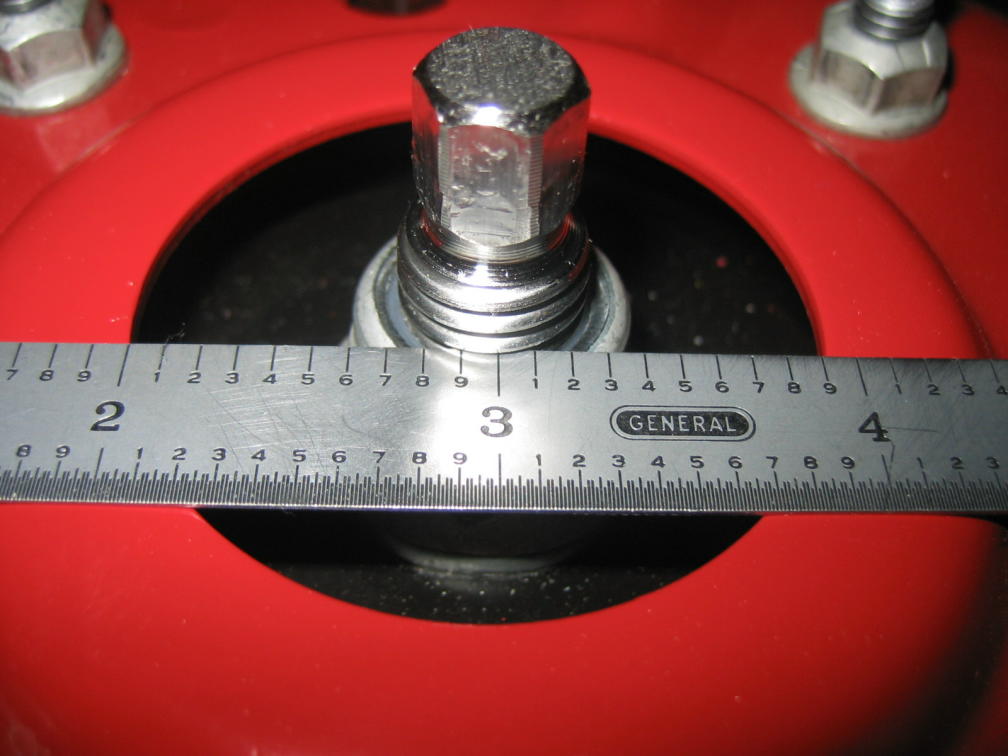

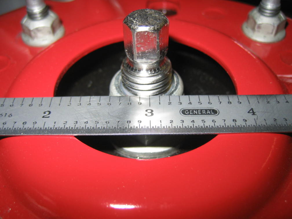

Okay, I took some measurements off my center strut stud in relation to the hole opening so you can compare it to yours.
pics attached (5 total):
2 views only (see pic file name for description);
Driver's side, looking aft, 2" mark on scale lined up to hole opening, scale butted up against the threaded stud.
Same, but looking inboard.
(Passenger side pics on next post)
Attached Thumbnails Ponies on The Run!-strut_driver_looking-aft1.jpg   Ponies on The Run!-strut_driver_looking-aft2.jpg   Ponies on The Run!-strut_driver_looking-inboard1.jpg   Ponies on The Run!-strut_driver_looking-inboard2.jpg   Ponies on The Run!-strut_driver_looking-inboard3.jpg
Old May 18, 2006 | 09:49 PM
  #654

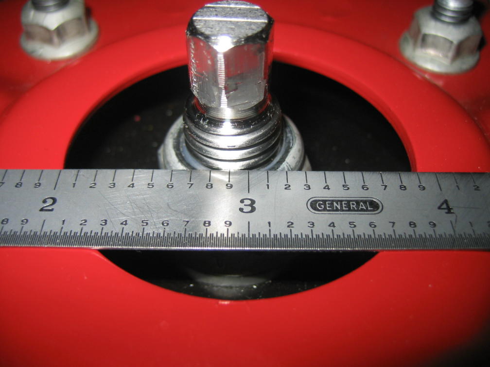

Passenger side; same as above post.
5 pics total.
(3 pics looking aft, 2 pics looking inboard)
Attached Thumbnails Ponies on The Run!-strut_pass_looking-aft1.jpg   Ponies on The Run!-strut_pass_looking-aft2.jpg   Ponies on The Run!-strut_pass_looking-aft3.jpg   Ponies on The Run!-strut_pass_looking-inboard1.jpg   Ponies on The Run!-strut_pass_looking-inboard2.jpg

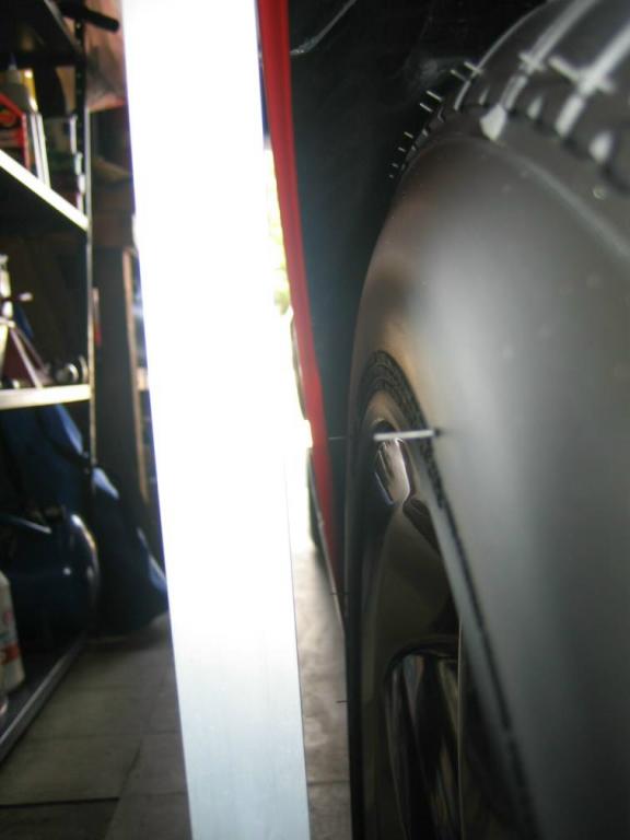

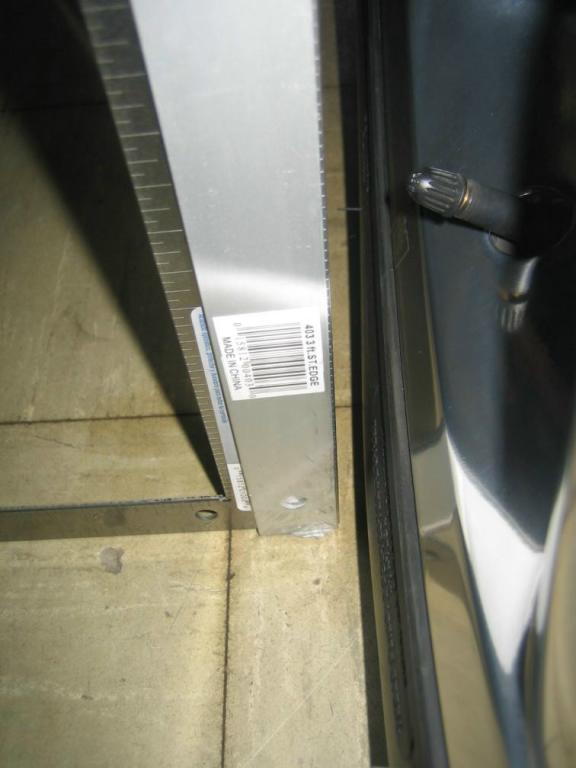

Negative Camber
Negative camber is apparent, at least in my front passenger wheel.
(Can't verify my driver's side because of my Parking Mat)
End of straight edge is noticibly closer to the bottom section of the tire (even with the slight buldge) as compared to the top section.
As to what degree, I have no idea.
I have to take it to my front end guy just as soon as I find the motivation.
Attached Thumbnails Ponies on The Run!-pass_fr_straight-edge_lower-tire.jpg   Ponies on The Run!-pass_fr_straight-edge_lower-tire2.jpg   Ponies on The Run!-pass_fr_straight-edge_upper-tire.jpg
Thanks!
What I did for measurements was lay the metal ruler on edge against the exposed threads on the middle stud and measured to the edge of the circle (only for inboard and outboard). Forward and backward would be for caster, and the center stud is still very close to being centered that way.
Both sides measured the same when pulling the center stud outboard toward the fender. 15mm from the threads to the edge of the circle outboard, and 21mm from the threads to the edge of the circle inboard. Centered would be 18mm and 18mm, so I moved the center stud 3mm toward the fenderwell.
OK, trig time. The distance from the top of the strut assembly (where the nuts are) to the pivot point on the spindle is 28.5" (724mm). I moved the the center stud 3mm toward the fender. The angle is equal to the arctangent of 3 divided by 724, which is .25 degrees.
That .25 degrees might be just enough to bring camber back into specs without using camber bolts.
