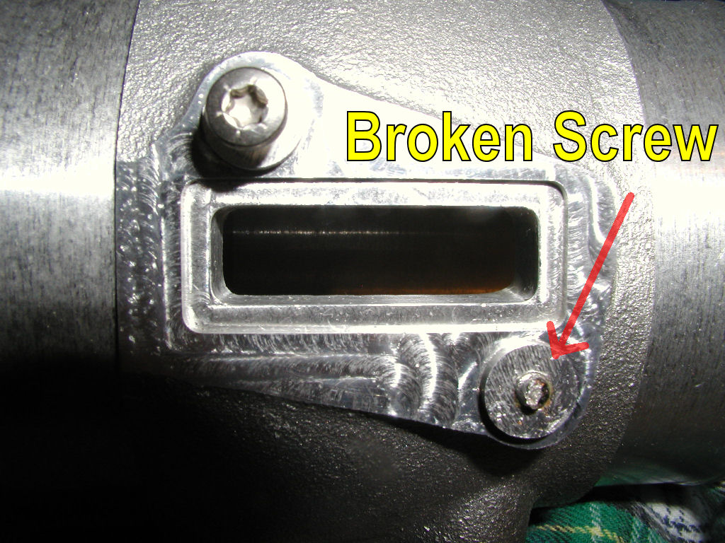

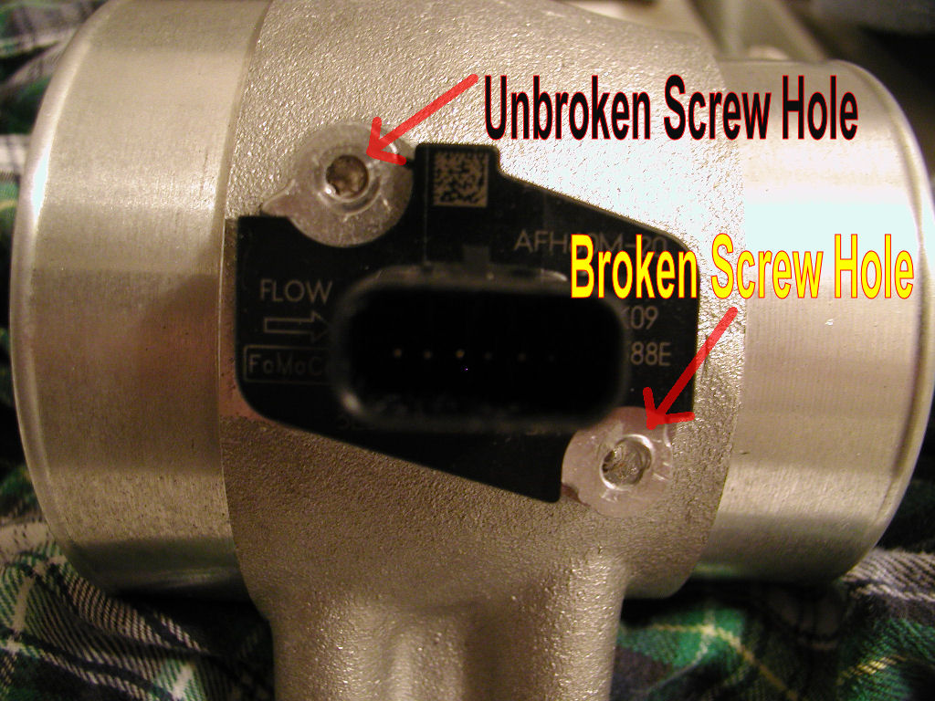

Upon further investigation I have come up with a scenario that I think happened concerning the broken screw.
I removed the good screw and was able to remove the MAF sensor from the intake adapter.
Attachment 12732
What it looks like to me, is when the MAF was initially installed it was cross threaded a little. (Notice the marks on the bad screw side of the MAF Sensor)
Attachment 12733
Then when it was time to remove it it wouldn't budge and the head snapped off.
BTW Bill that is Maroon not Fuscia and it is not carpet it is a rug.
I'd recommend spraying some penetrating oil in that broken stud and let it soak for a while. Then get yourself a Screw Extractor to remove the broken stud. Once out, check the condition of the threads and re-tap if necessary.
My bad.
I used some penetrating oil & let it set overnight, sucker still won't budge. (Used pliers to grip the tip sticking out.) So I need to try the left handed drill bit, then extractor method. Then have to re-tap I am assuming.
My bad.
No problem
