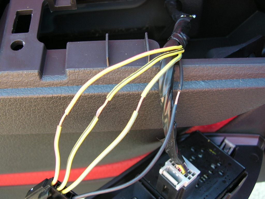

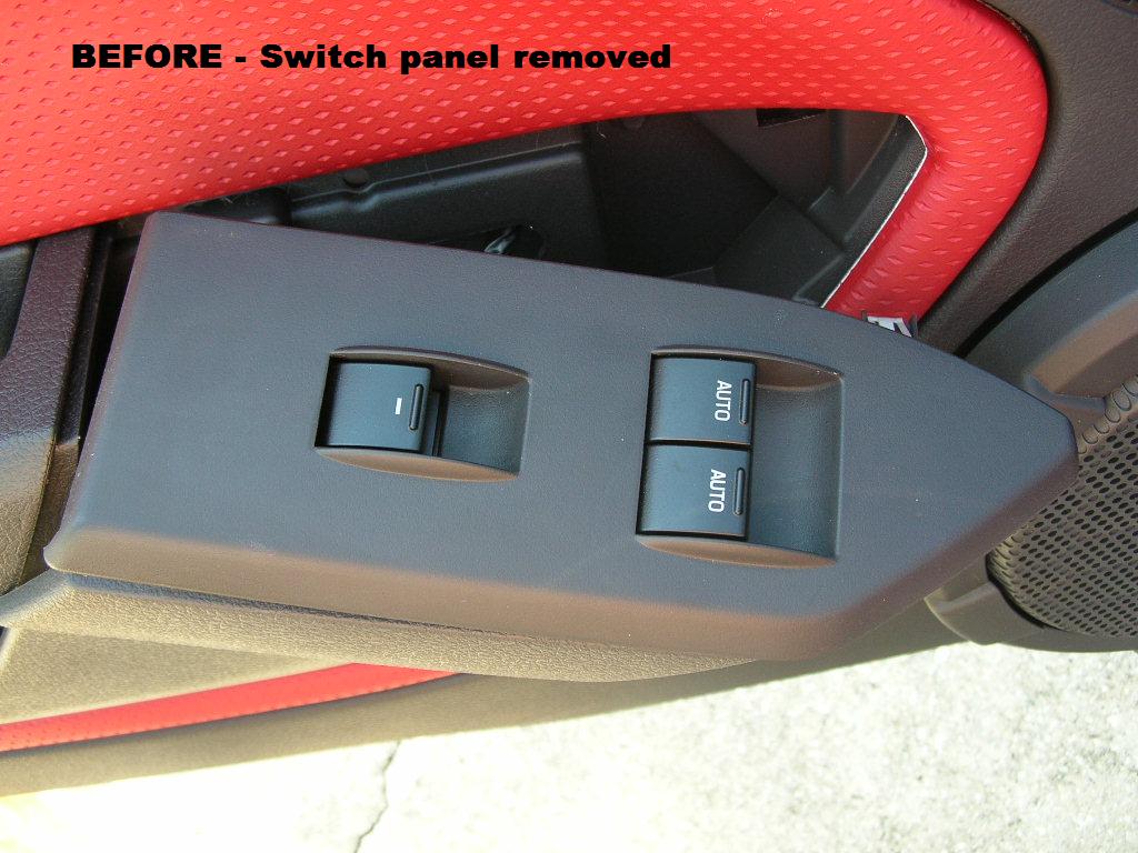

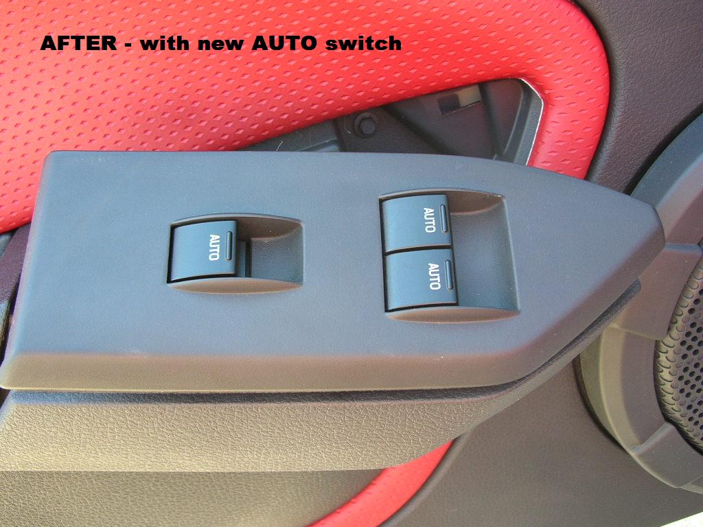

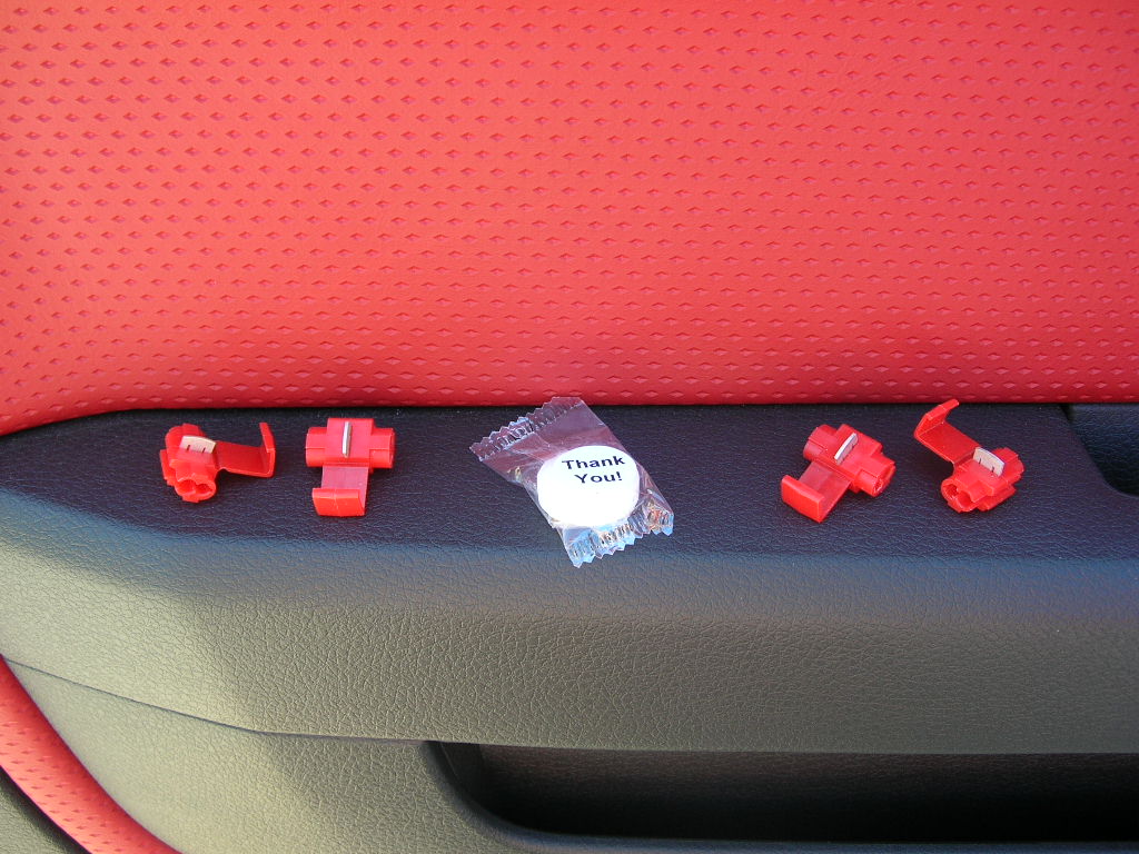

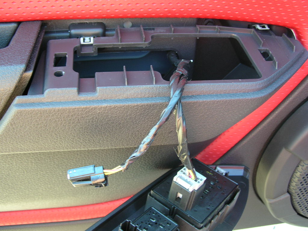

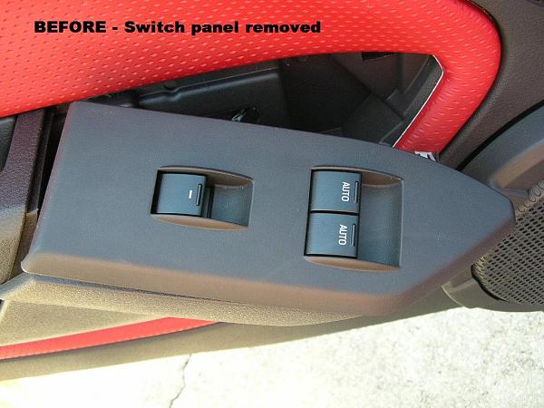

One-Touch Rear Windows
Here's my little write-up for the one-touch rear windows. I definitely recommend this kit from WebElectric for any vert owner. Why it didn't come this way from the factory is beyond me.
The switch panel is very easy to pop out. It pops OUT with the piece below it, and then pops UP away from that lower piece.
Attachment 12578 Here is BEFORE. I already popped out the normal switch, but I layed it back in place for the picture.
Attachment 12579 Here is the new AUTO switch being installed. It's a genuine Ford switch - I guess for the passenger side, as the driver's side is a double switch. The wire harness just clips in and out of the switch very easily.
Attachment 12580 Here is how it looks AFTER - much better!
Attachment 12581 Here are the wires taped up from the factory.
Attachment 12582 And here are the wires untaped - the installation instructions say to unwrap them back to the junction, which I did.
Attachment 12583 Here are the connectors that come in the kit, and the mint to enjoy after installation (but I enjoyed it DURING installation).
Attachment 12584 Since I hate those connectors pictured above, and since I'm an electrician, I have to solder everything. So, here are the wires stripped back a little.
Attachment 12585 And the module soldered in. Normally you just clip the red connectors over the module's wires and the switch's wires. They are too bulky, and soldering is a WAY better connection.
Attachment 12586 And the wires taped up with electrical tape.
Attachment 12587 You just drop the module into the opening in the arm rest - I wedged it in a little so it wouldn't rattle... And, finally, the AFTER shot.
