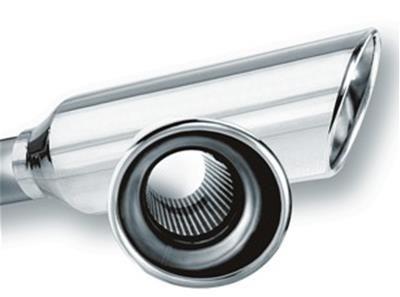

If The Sound Gets Too Annoying There Are Tips Which Will Mellow The Exhaust Out as Well. This is an Example I Found
Borla Standard Exhaust Tips
Will it Effect Drone or Just Tone?
Don't Know!
These Borla polished stainless steel exhaust tips have more than just great looks. Engineered for top performance, Borla exhaust tips deliver maximum low-end torque and top-end horsepower. These tips are made from aircraft-quality T304 polished stainless steel for long life and are designed to mellow out your exhaust tone. They are available in a variety of lengths, cuts, and outlets.
https://www.summitracing.com/parts/b...SABEgIrt_D_BwE

Those appear to be resonated tips... Whether they reduce drone or just effect tone, one thing is for certain, you're taking one heck of a risk by cutting off you're existing 304 grade polished SS tips, then having to weld in the replacement tips only to find out they may not reduce the amount of drone prior to cutting off the original tips... Also, if I'm not mistaken, once the mufflers have been modified or tampered with, it voids the manufactures warranty... Therefore, I would recommend to mrkabc, if resonance drone is a factor, he would be far better off to consider purchasing resonators from Vibrant Performance which can be installed in the mid-pipe section after the H or X crossover section by either clamping or welding in...

According to the additional thread attachments provided below, adding resonators to the exhaust system are the most effective way for reducing interior resonance drone, which is the reason I suggested to the OP to consider adding resonators, rather than take the risk of voiding his factory warranty by cutting off his existing Flowmaster tips in favor of welding in those resonated tips that may not help with reducing drone, but rather just tone down the overall volume...
As far as those Borla resonated tips you brought up, my question is why didn't Borla design their axle-back exhaust kits to include resonated tips to begin with, rather than just include the resonators inside the muffler core inlet sections...

My GT500KR aka FR500S mufflers have similar perforated "resonator tips" .... I never thought they really did much, but maybe that is part of their drone-elimination magic

By placing the resonators directly at the tip location cancel out the lower frequencies more effectively than just placing them in the core sections... Also, from my understanding, the FR500S design has an open space between the cores in the muffler housings which also help when it comes to cancelling out the lower frequencies that produce resonance drone...The open space is sort of like having an open chamber between the muffler cores...
