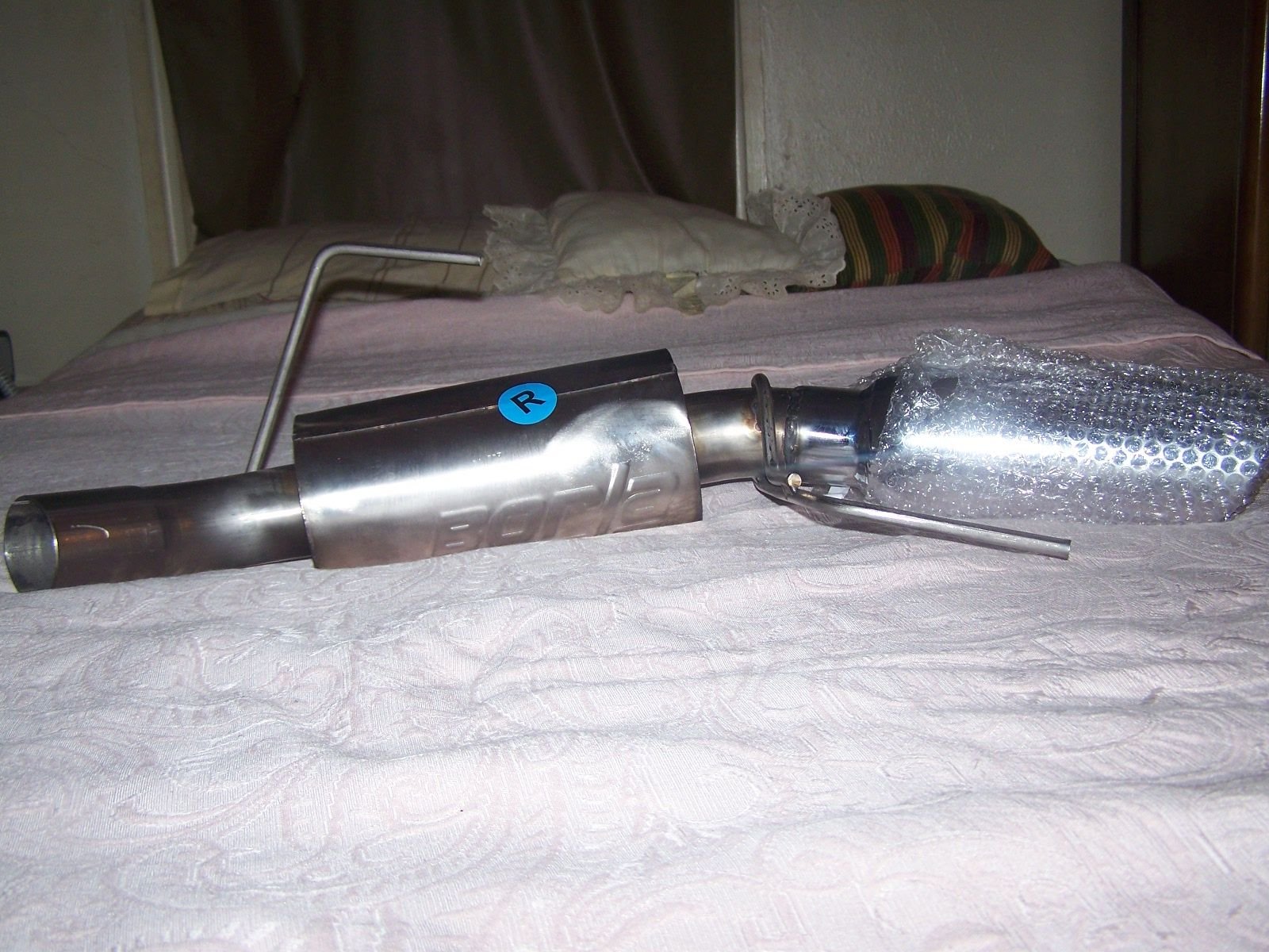

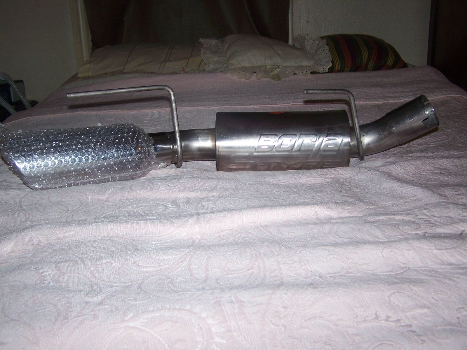

Nemi! if your interested in the Borla S-types? I have the axle-backs sitting down in my basement. They're in excellent condition and I'll sell them to you if your interested?
-Rocky
