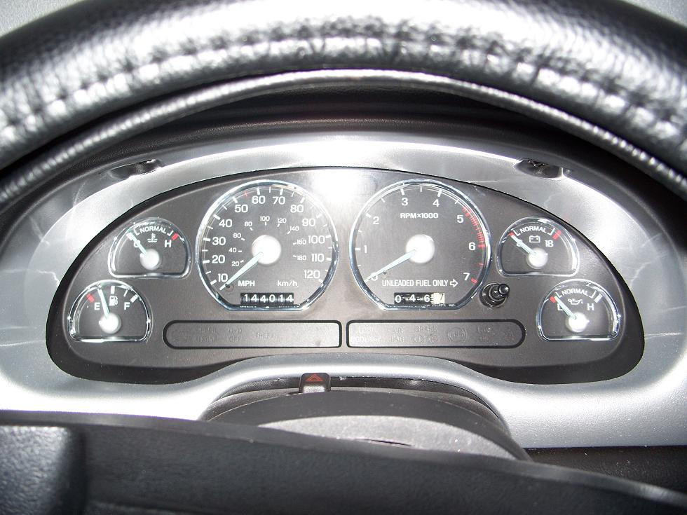

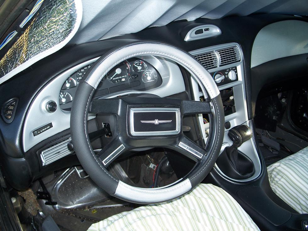

Needles are usually clear with the back surface painted whatever color it uses. That is how the light transfers through the needle. It is left clear at the pivot center of the cack of the needle to allow light transfer from the cluster. It is very easy to polish or fine sand the paint off the back of the needle, then paint just the back of the exposed pointer a flat white(not the base pivot under the pivot cap).
I did this mod for the Mustang cluster I swapped into my 1984 Tbird to finish off the dash swap. The needles are now a blue turquoise in spirit of classic Tbird theme. They used to be orange. The flash is washing this out a bit.
Good to know, thanks. You just saved my friend $70.
