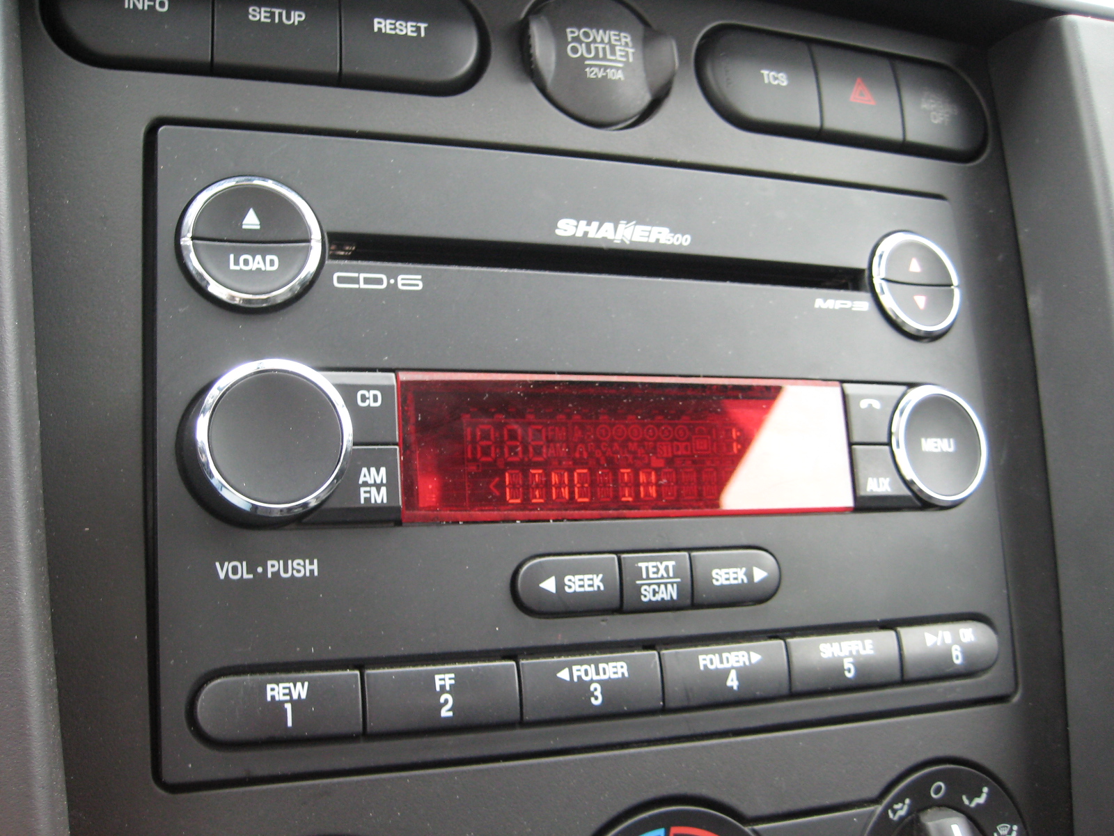

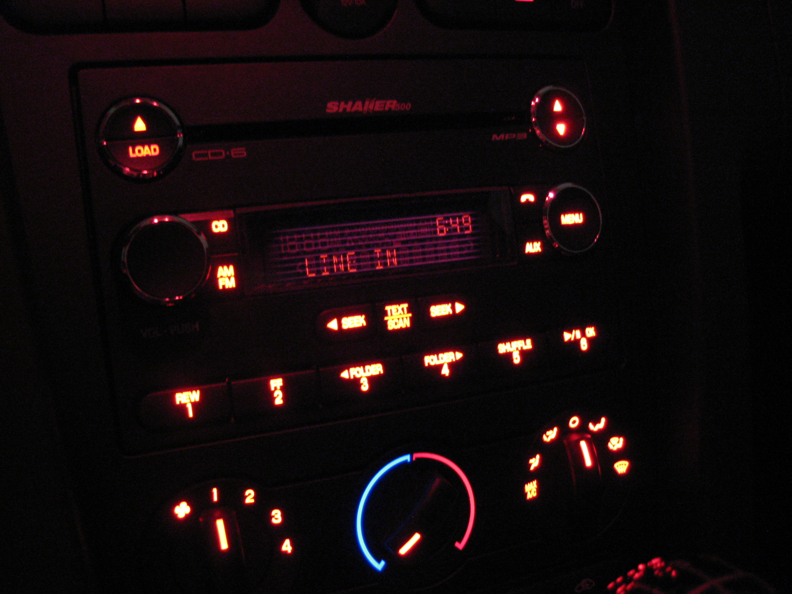

Still having some issues with some of the LED's staying on all the time, anyone have some suggestions? Either way, heres a day and night pic of the dyed plexi

The tinted acrylic looks good. Kudos for finding a solution. I would still experiment with a tint or something on it to darken it up so it looks almost black in the day and you don't see the detail of the LCD panel.

Shotokan - there isnt a write up for the radio screen color change. It was really easy IMO. I went to Lowes and got a 12" x 12" x 0.080" sheet of plexiglass and cut it to the same size of the green window on the radio. Cut it just a little bit(im talking a mm or two here) bigger than the window so you can sand the edges smooth. Sand the edges smooth to where the new window is the same size as the original green one. Then on one of the side of the window, sand a ~45* edge on both the top and bottom sides to give it the beveled look of the stock one. After that I threw it in a pot of simmering water with a a packet of scarlett red Ritt Fabric Dye in it. You can get this dye at Walmart in the laundry detergent aisle, Hobby Lobby in the fabric section, or just about any arts and crafts store. Let it cook for about an hour or so and voila - dyed plexiglass window. It cost me roughly $5 to make the new window. Im sure any color would work as I have used this dye to dye many different things in the past.
