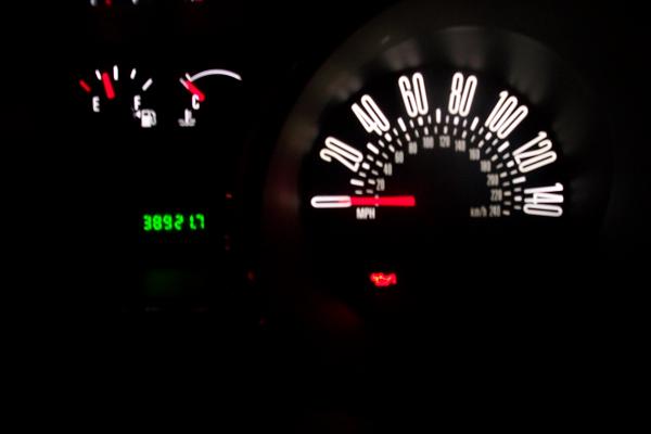

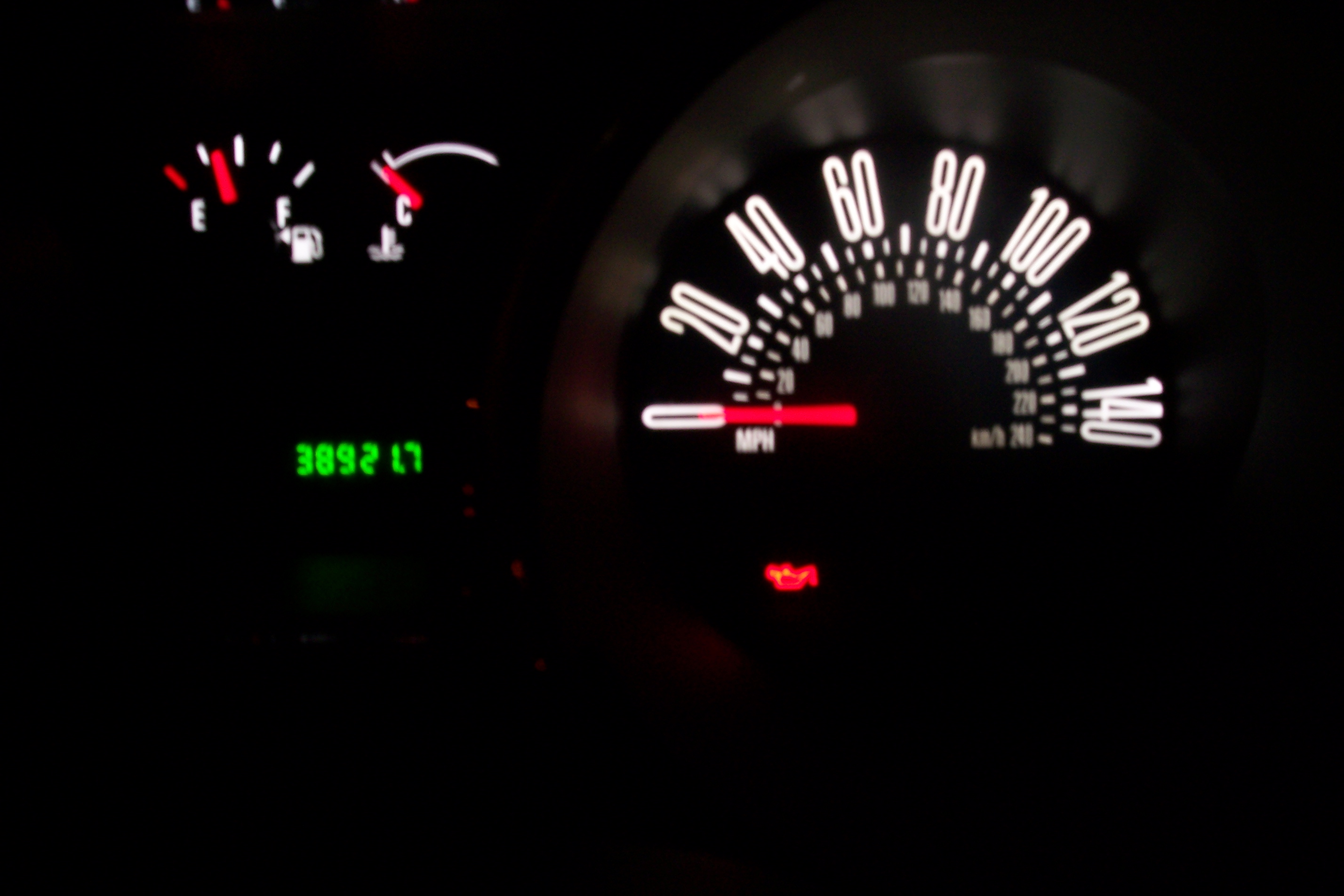

Here's a few shots of my conversion (the pics aren't perfect, there's no variation in the shade of blue in real life for instance, but pretty good such low light conditions)

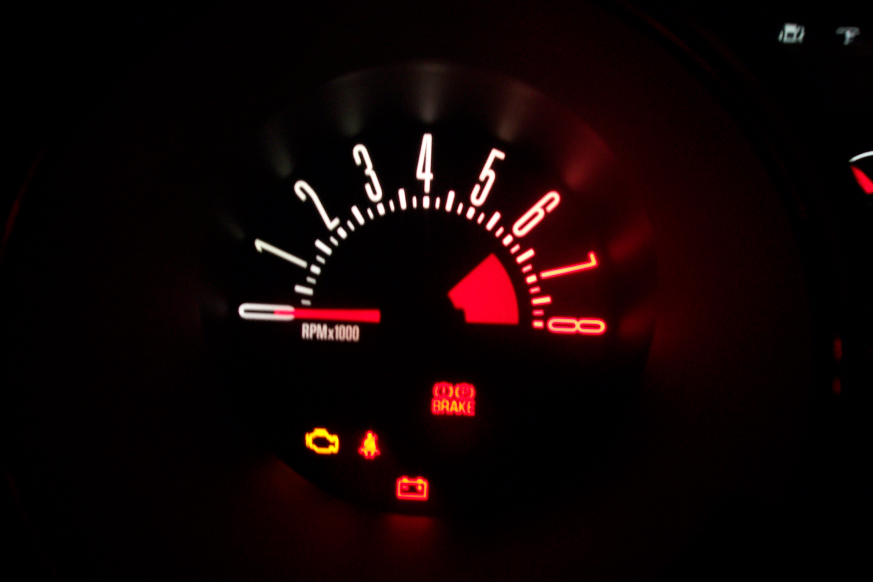

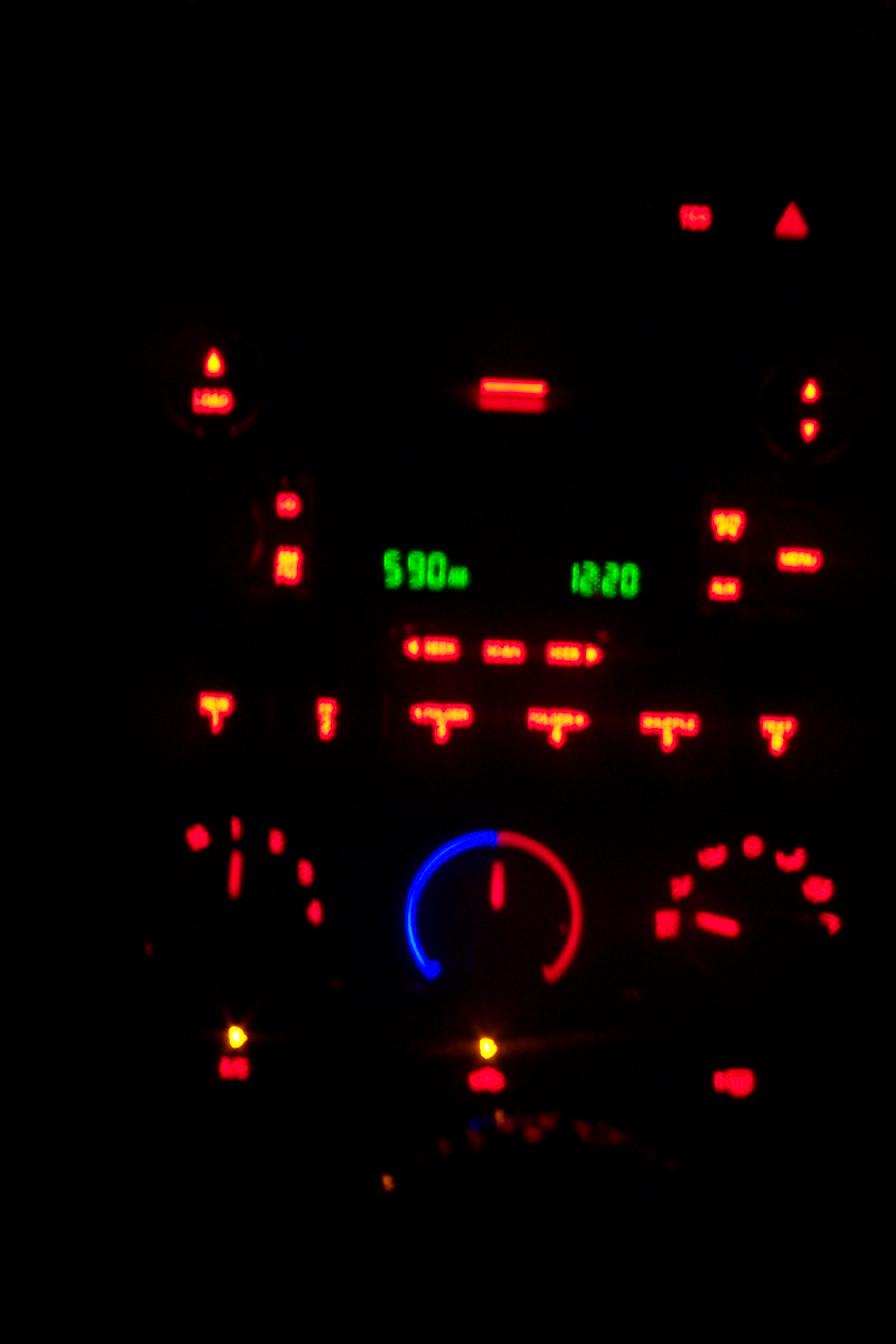

Just finished my new gauge cluster and interior led mod. my camera is kinda funky but you will get the basic look anyway. I am stoked at how it turned out!
That looks excellent Faber
Man that looks great, Is that an amber color, I would like that in my car if only I had the ability also to do this.

I just swapped the last few leds on the tach with high intensity red ones. and the rest white. as for the stereo, ac etc. they are also red.
