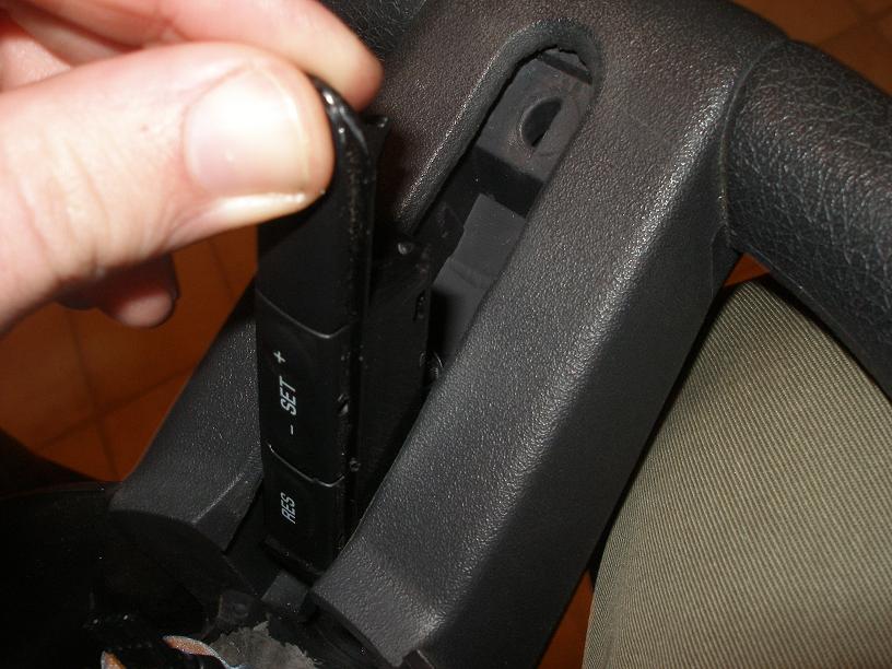

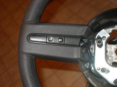

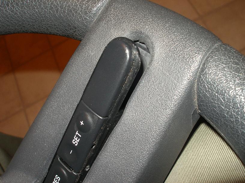

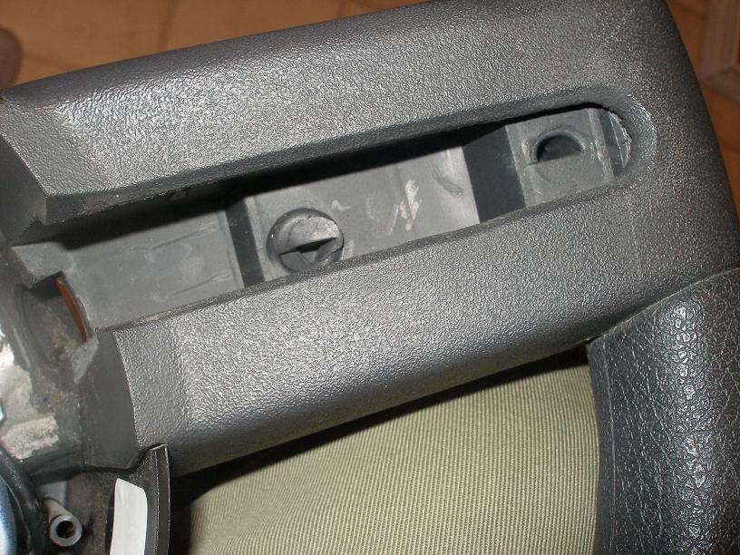

You are awesome, Deric! I can't wait.
For those of you that have a non IUP wheel, or the shelby/bullitt wheel, there is a problem with getting at the cruise control buttons. They need to be pryed out (see pics). This could damage teh leather on the Shelby/Bullitt wheel, but the rubber on the regular wheel can handle it.
Cheers
Attached Thumbnails 2005-2009 Mustang S-197 Installed Blue LEDs in factory switches (lots of pics)-p2071049.jpg   2005-2009 Mustang S-197 Installed Blue LEDs in factory switches (lots of pics)-p2071050.jpg   2005-2009 Mustang S-197 Installed Blue LEDs in factory switches (lots of pics)-p2071051.jpg   2005-2009 Mustang S-197 Installed Blue LEDs in factory switches (lots of pics)-p2071052.jpg

Would removing the airbag and going in from the inside be better for those wheels?
Cheers
