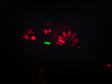

Heres mine

looks great! are those the oznium LEDs?
